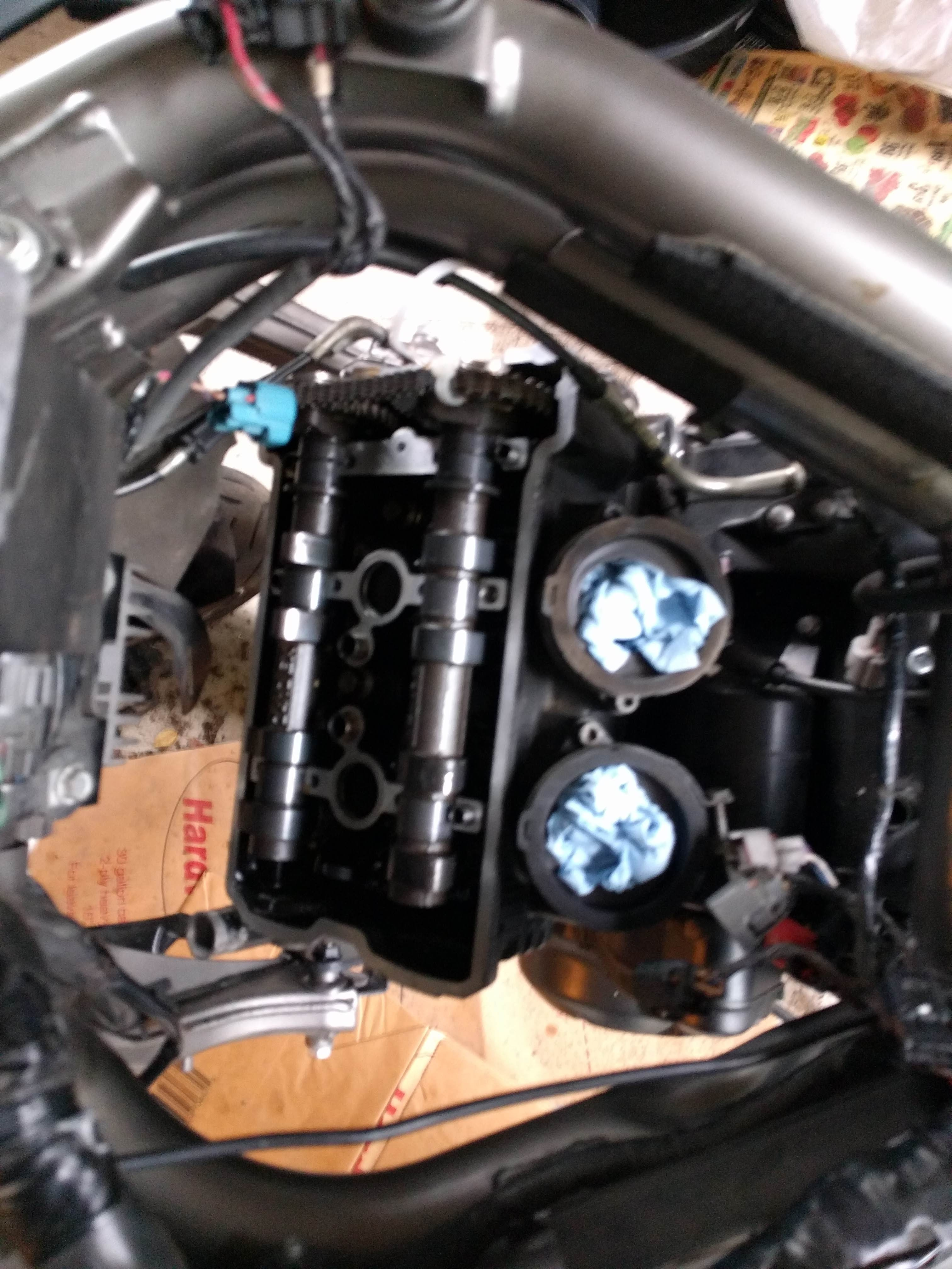

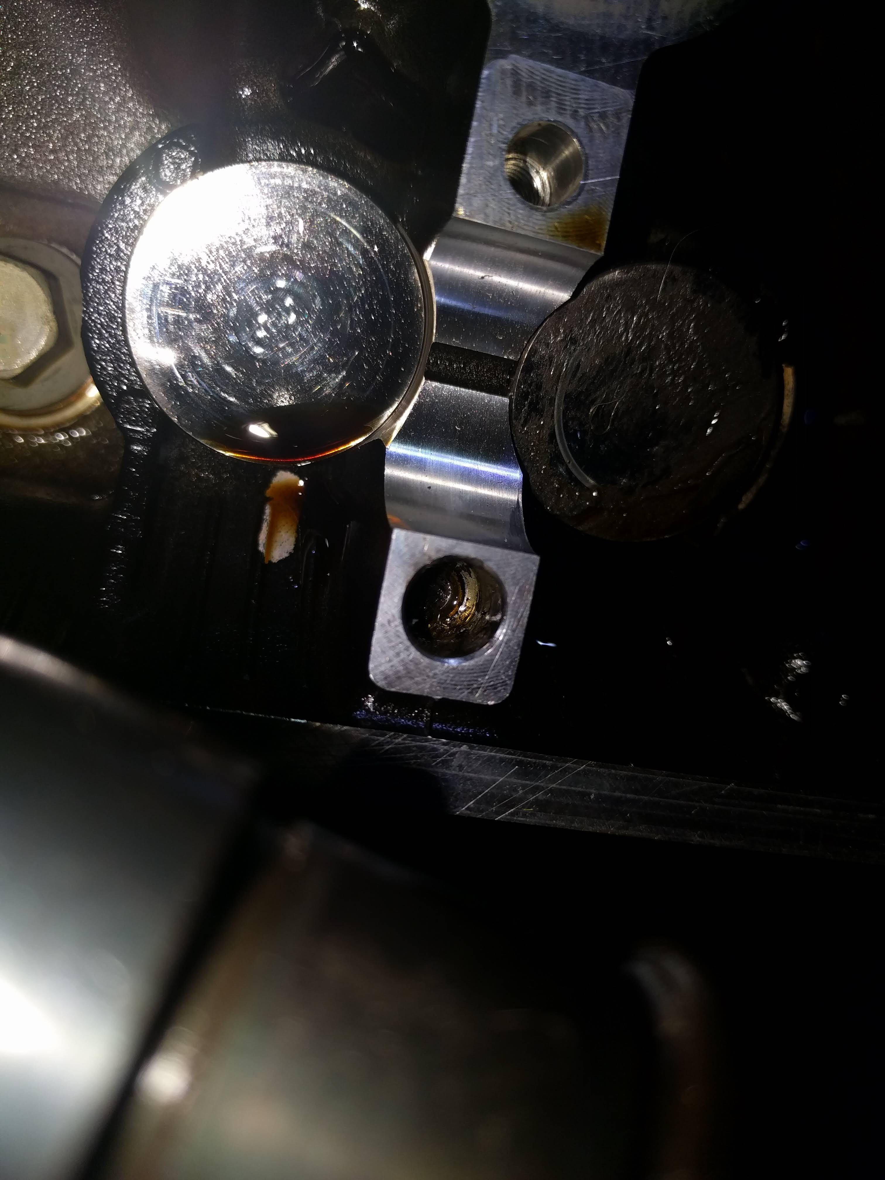

Sadly, the bolt in question was through a cam bearing cap - suffice it to say that bad boy suddenly went loose then blam, snapped and the torque wrench jumped. Had I been counting the number of turns, I would have likely known better. Of the 12 bolts torqued, only one failed.
Rear left below...
This was on a 2012 Ninja 650, the access to that area to remove that snapped bolt SUCKS. Looking like I'll be using Alum to eat the steel out.

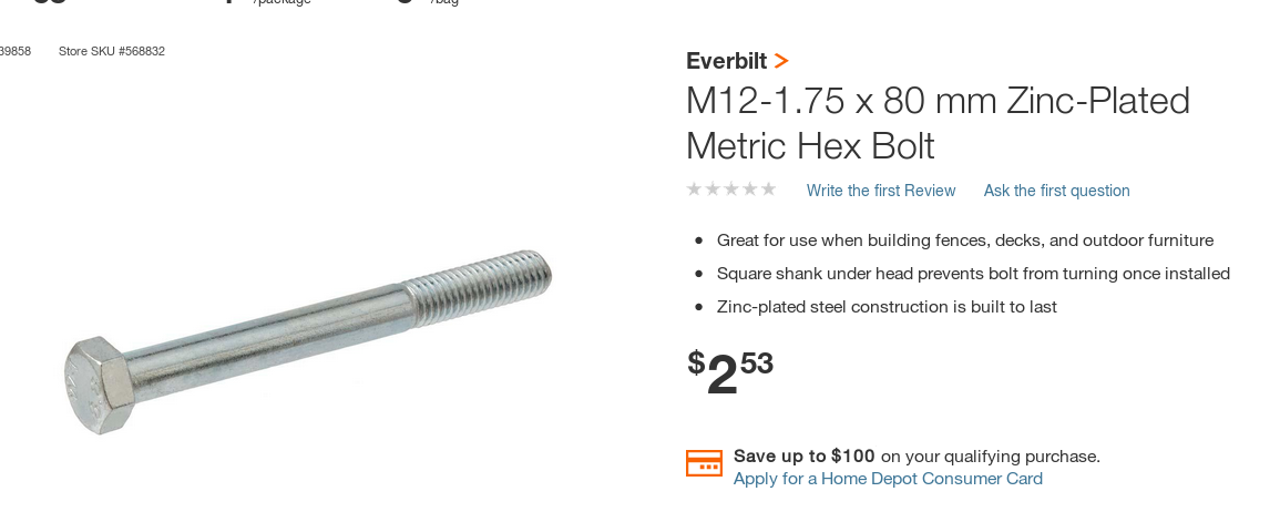

Or $2.53 at Home Depot...
