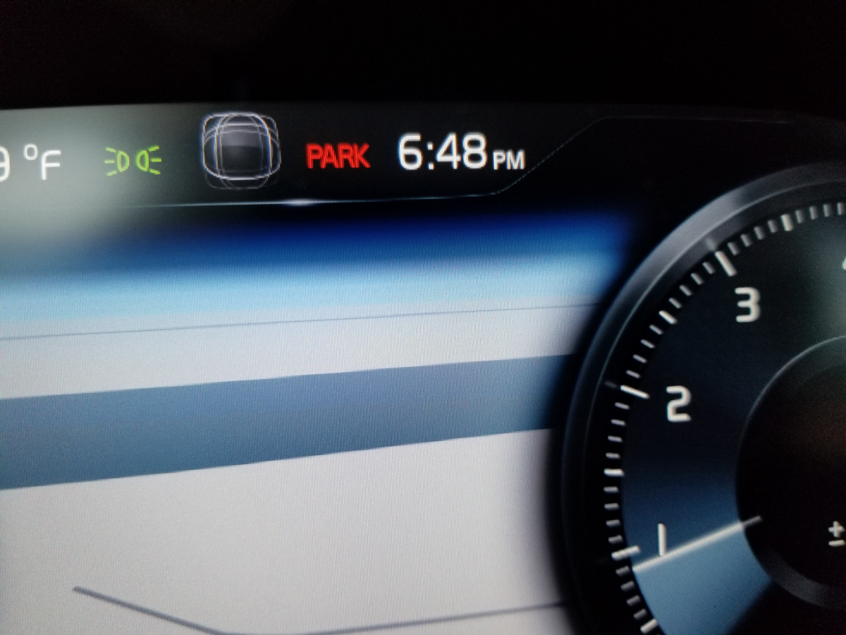

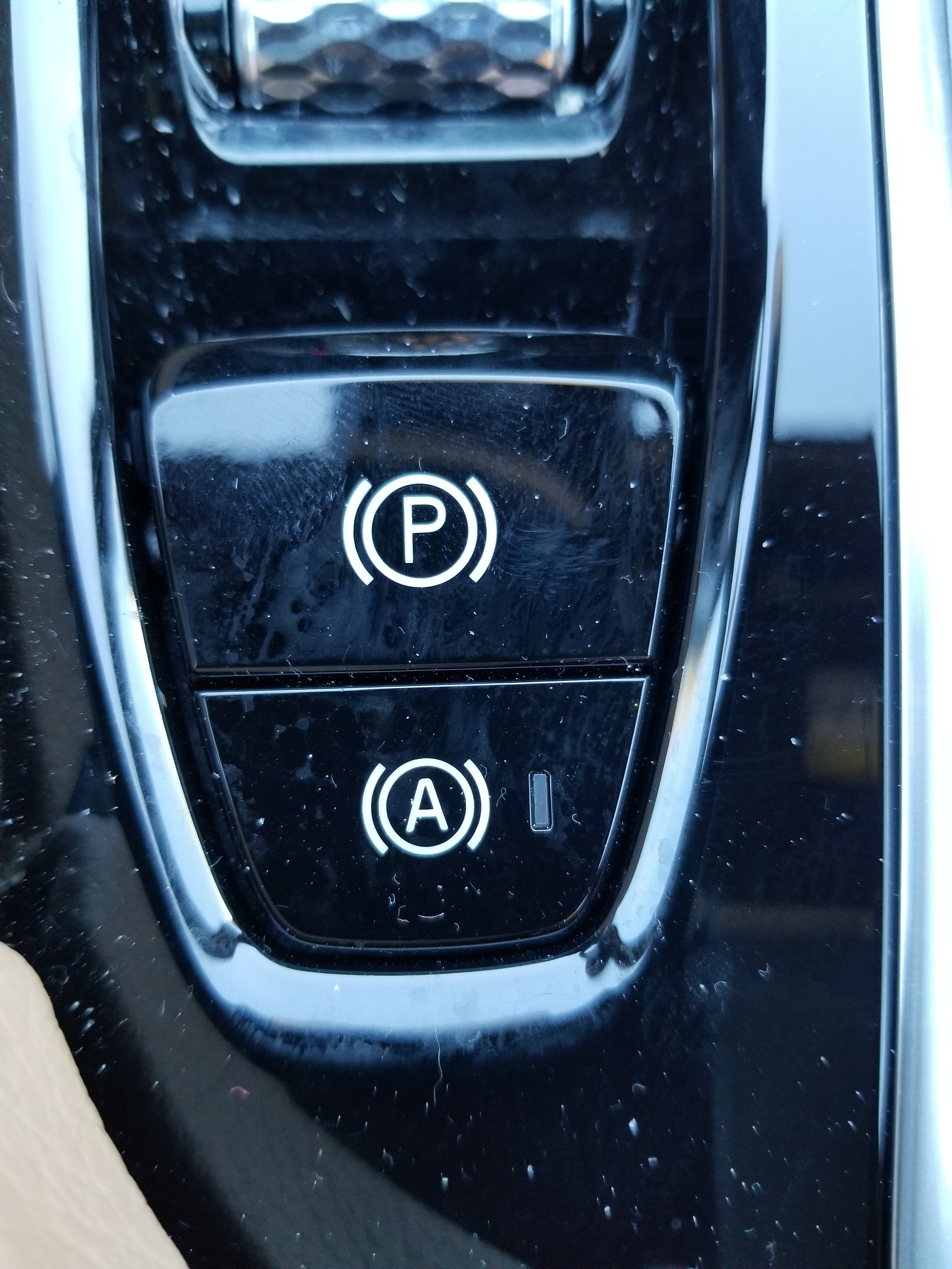

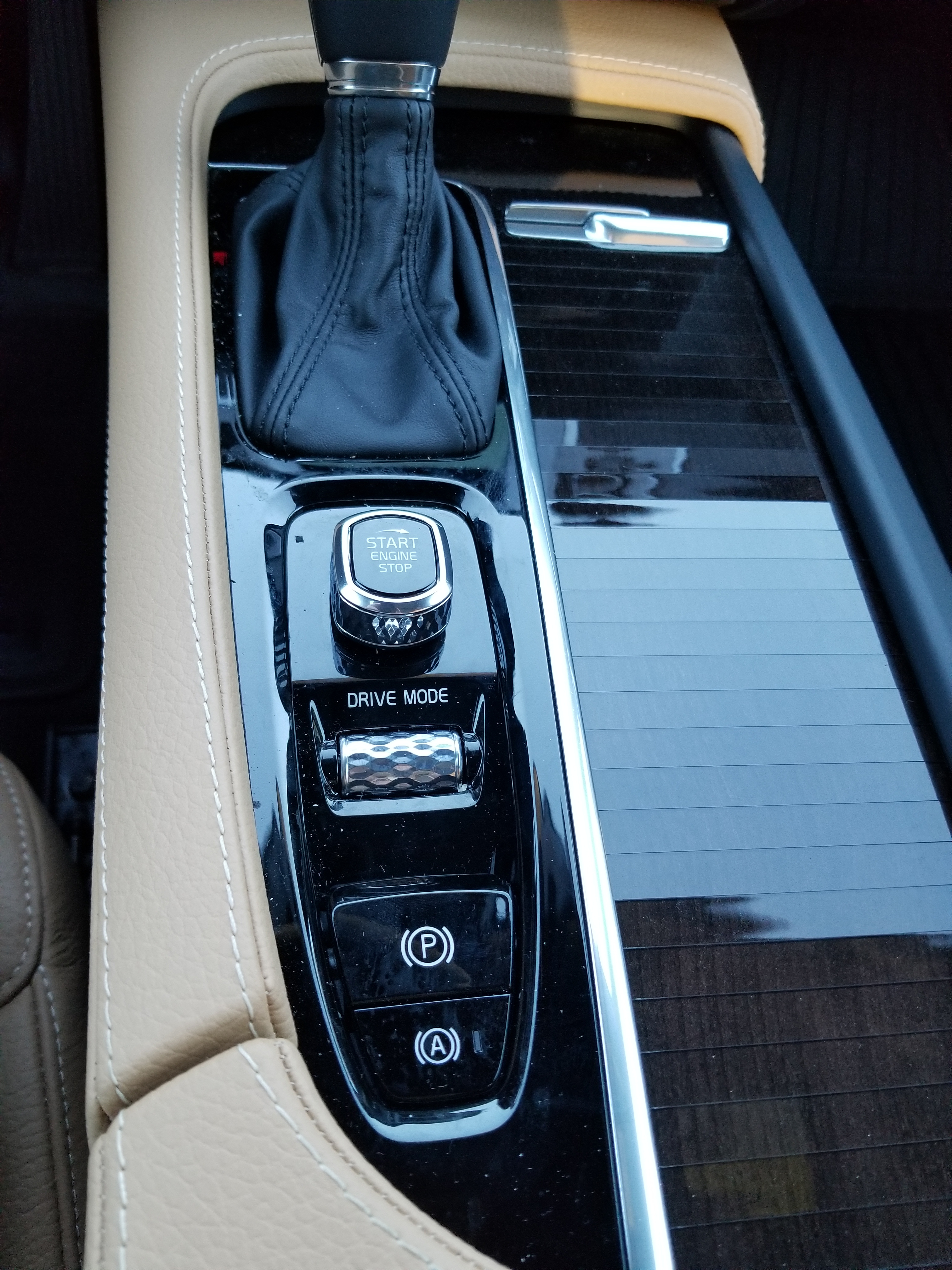

Pic of 2019 XC90 electric parking brake button and light indicating applied in my service loaner. For future lookers who aren't sure what they have. I much prefer my S80s handle type. June
