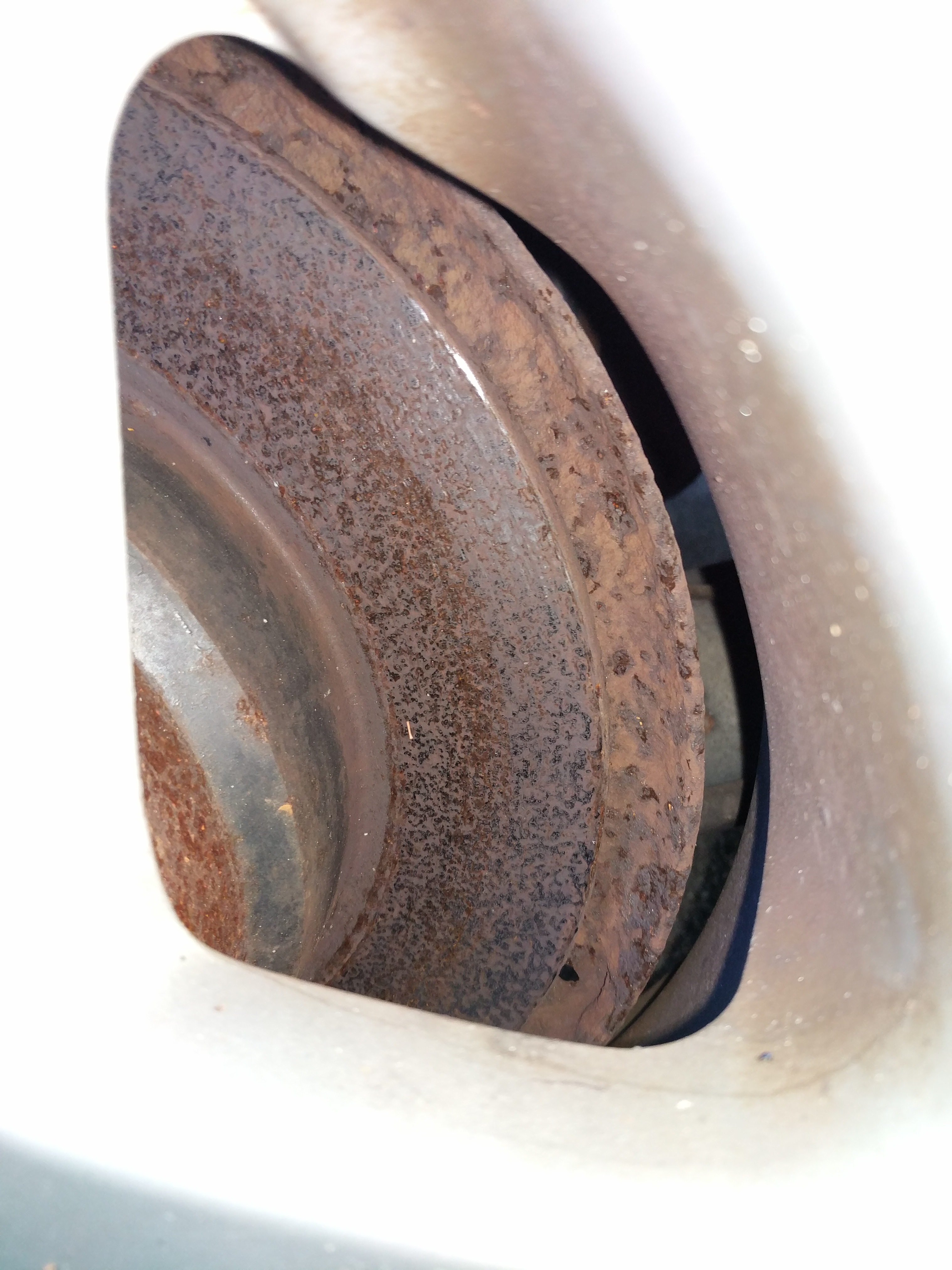

Then there's the fact that my rear brakes haven't worked in three years, even after replacing slides, shims, rotors, and pads. They don't clamp enough to wear the rust off the rotors. The rear passenger's caliper was replaced 1/13 and again 1/15, but the rear driver's caliper is apparently original! I've attached pictures of my two-year-old rear rotors taken 7/18.
FYI, I've had OEM components used for these brake jobs every time. Nothing fancy, nothing cheap, always OEM done by dealerships or Volvo specialists. And still the calipers seize and the rear brakes don't work. My only solution is to do it all myself.

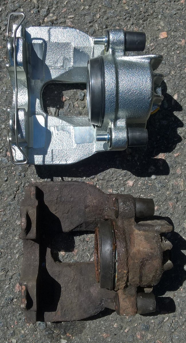

Bite the bullet and get new reman calipers from a good source. I have been dealing with old crappy calipers for years and I wish i had gotten new ones earlier. Bosch seems to make really nice rebuilt calipers. I just got one and it is of superb quality as far as looks go. A Volvo enthusiast recommended them to me. Worth every dollar.

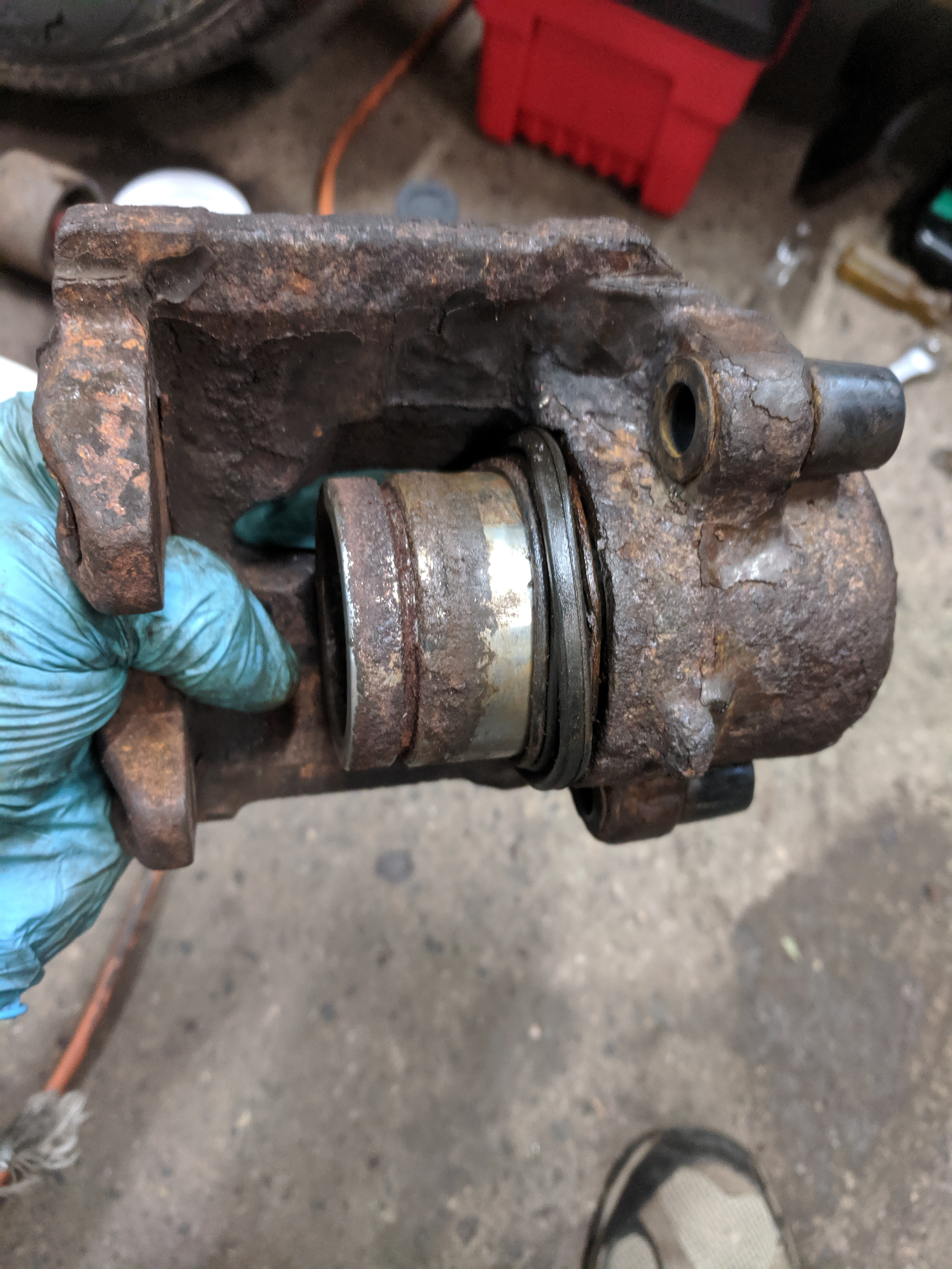

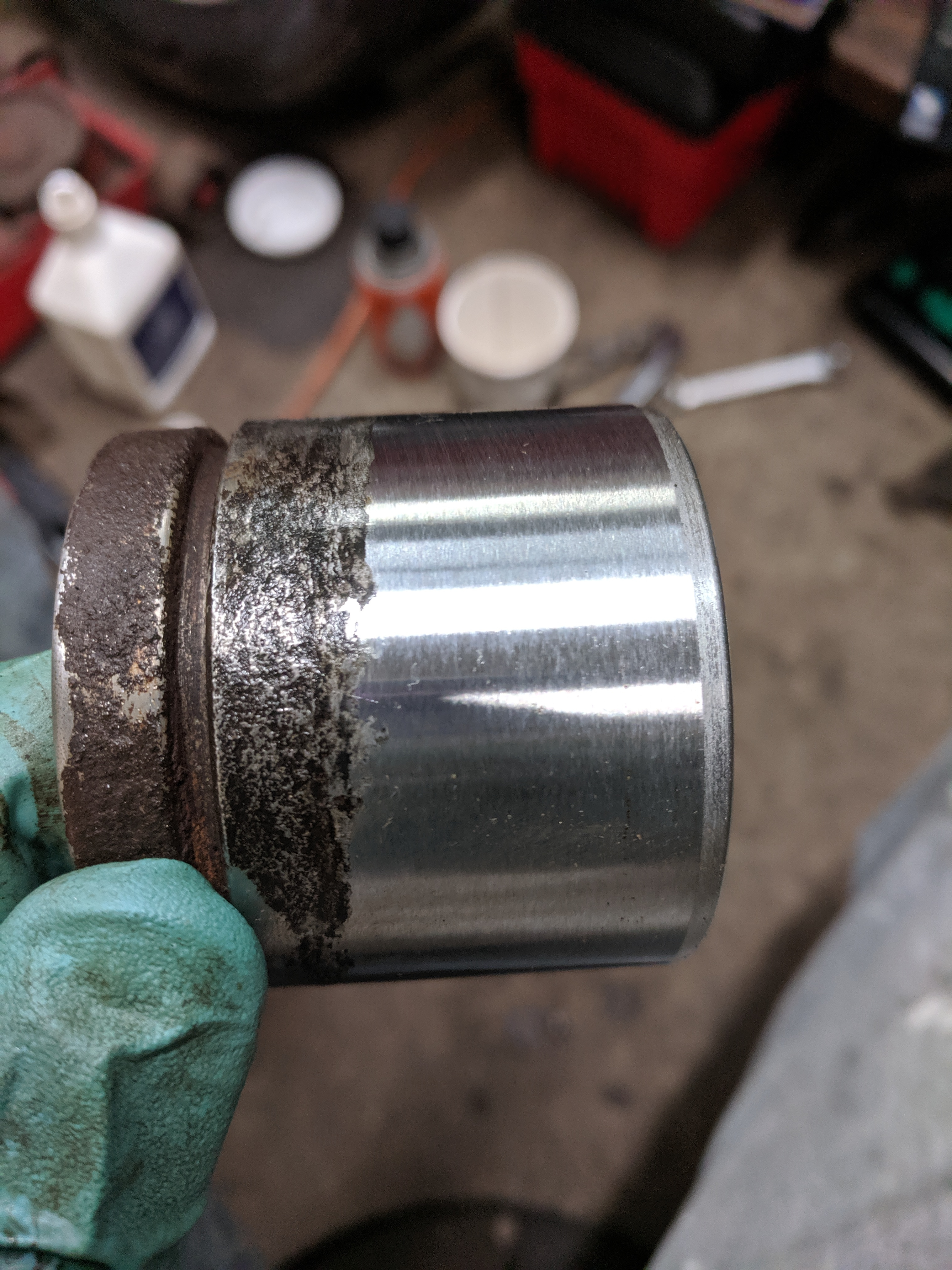

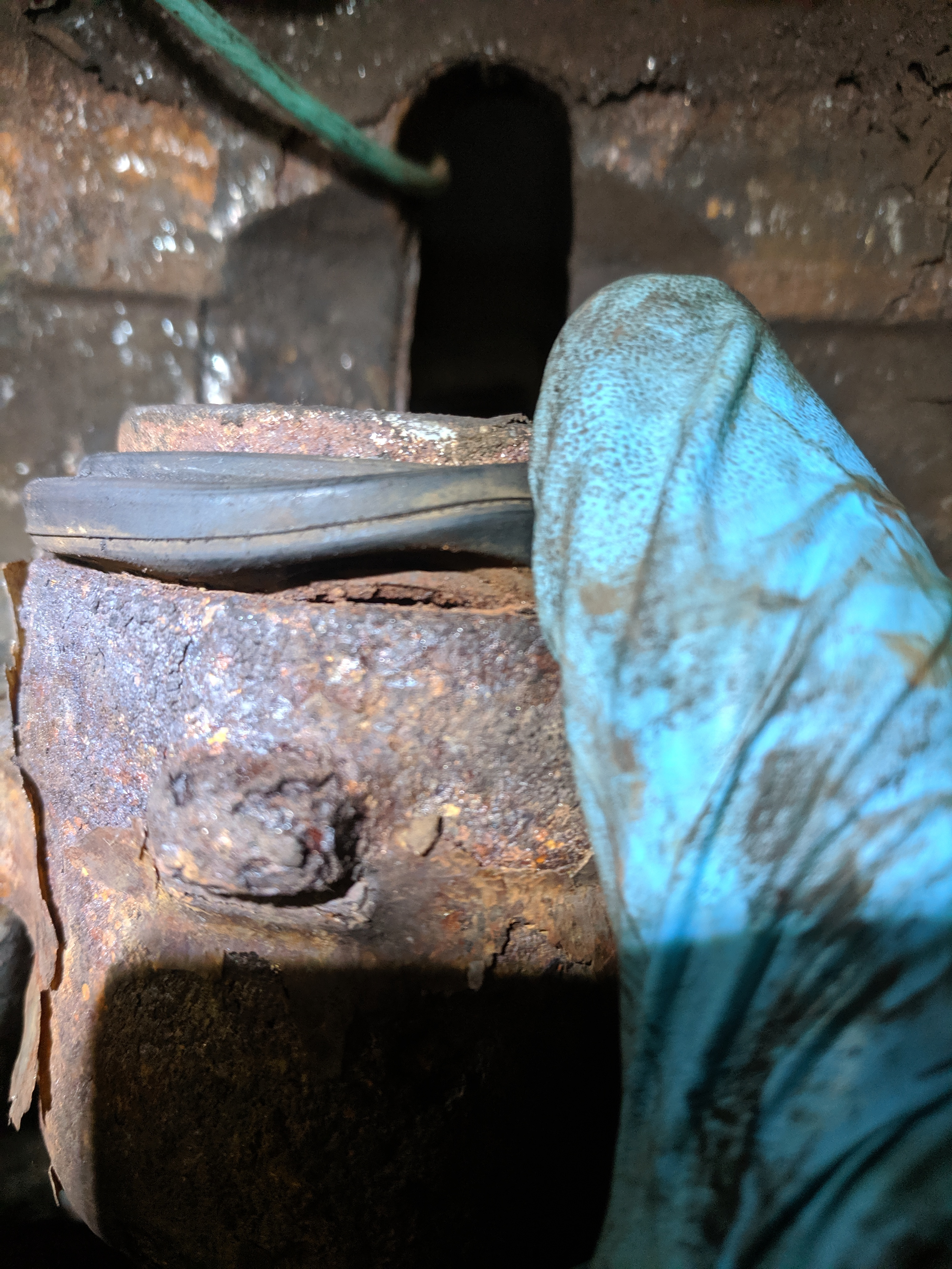

I finally found the solution to my problem: You prevent brake calipers from seizing by checking their dust boots (and other moving parts).
After sitting unused for a year, I finally started the brake overhaul on my V70. The front right caliper was stuck slightly closed. I carefully examined the caliper and found the dust boot had come out of the caliper in one small place. This allowed moisture in which rusted to the piston, bubbling it out so it would not retract.
I had to drive home from the garage where I work on my car, so without a replacement caliper, I had to scrape the rust off the piston and reassemble it. Yes, I am replacing the caliper because ATE doesn't sell replacement pistons (and because the caliper bleed valve is rusted shut). It's a shame since this caliper is only five years old and its internal cylinder is perfectly clean.
Thanks to everyone who replied in this thread and CN90 for the caliper overhaul document.

That piston is done. The cylinder wall inside the caliper will also be rusted and pitted and when the rubber seal hits the Pitting it will tear, usually as you clamping down on the brake to stop for that school bus
