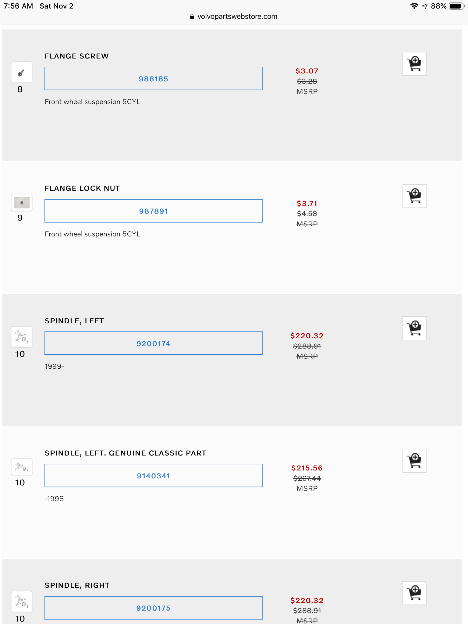

I completely missed this important point
The ball joint nut and bolt is a torque to yield, or at least the torque spec is high enough that it definitely stretches.
Volvo would not sell me the bolt/nut combo without buying a ball joint or control arm. I used a 8.8 grade hardware bolt and washers and inspect it regularly. This is a critical piece of hardware so you might not want to remove the ball joint if you want to keep things kosher.
If anyone has sourced the bolt/nut combo please post
Posts: 35298
Has thanked: 1505 times
Been thanked: 3818 times
Parts for the ball joints here, these are single use, TTY
988815 bolt
987891 nut
No idea why Volvo would not sell them to me separate
