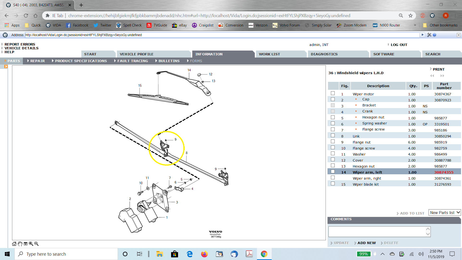

I was not expecting this.
Took the right side blade off and noticed the arm was not touching the windshield. Further investigation revealed the right side hub was broken and flopping all over the place. Got a replacement from the local PnP for $3.99. Way less then the $180.00 for new. Also grabbed the wiper blades which are in good condition ... Bosch $3.98 for the pair.
I'll be heading out to put it all together in a few minutes.

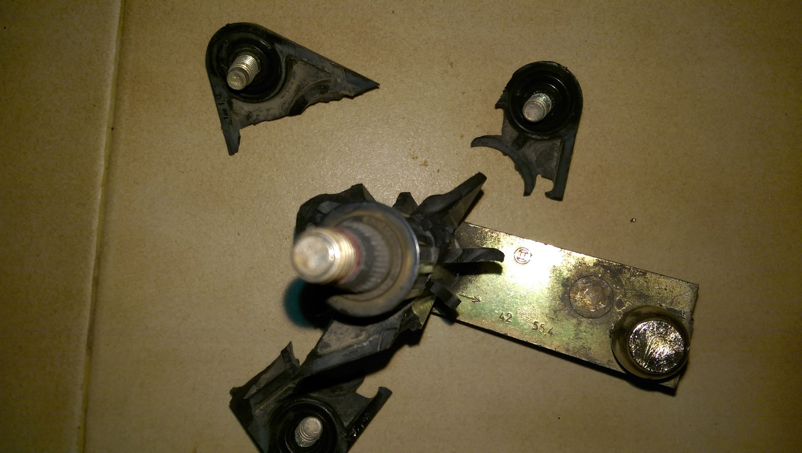

Got it done. The arms needed some altitude adjustment but the blades stay in contact with the glass now.
Here a mug shot of the bad boy that gave me so much grief.

Great info, that actually stayed together and not mangle the area surrounding it. Sure nice to have a local PnP for Volvo parts to make quick work of something so out of the ordinary. That VIDA, looks like a must have!
