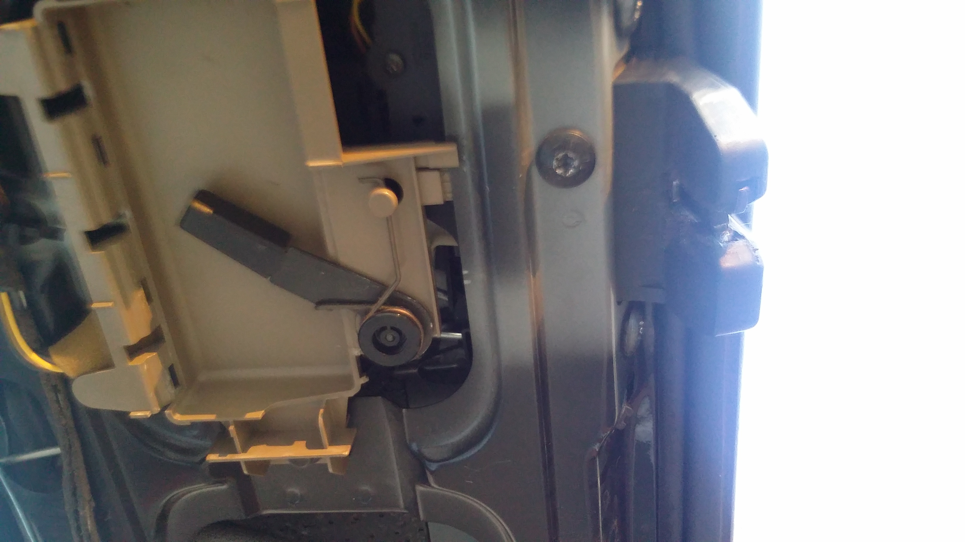

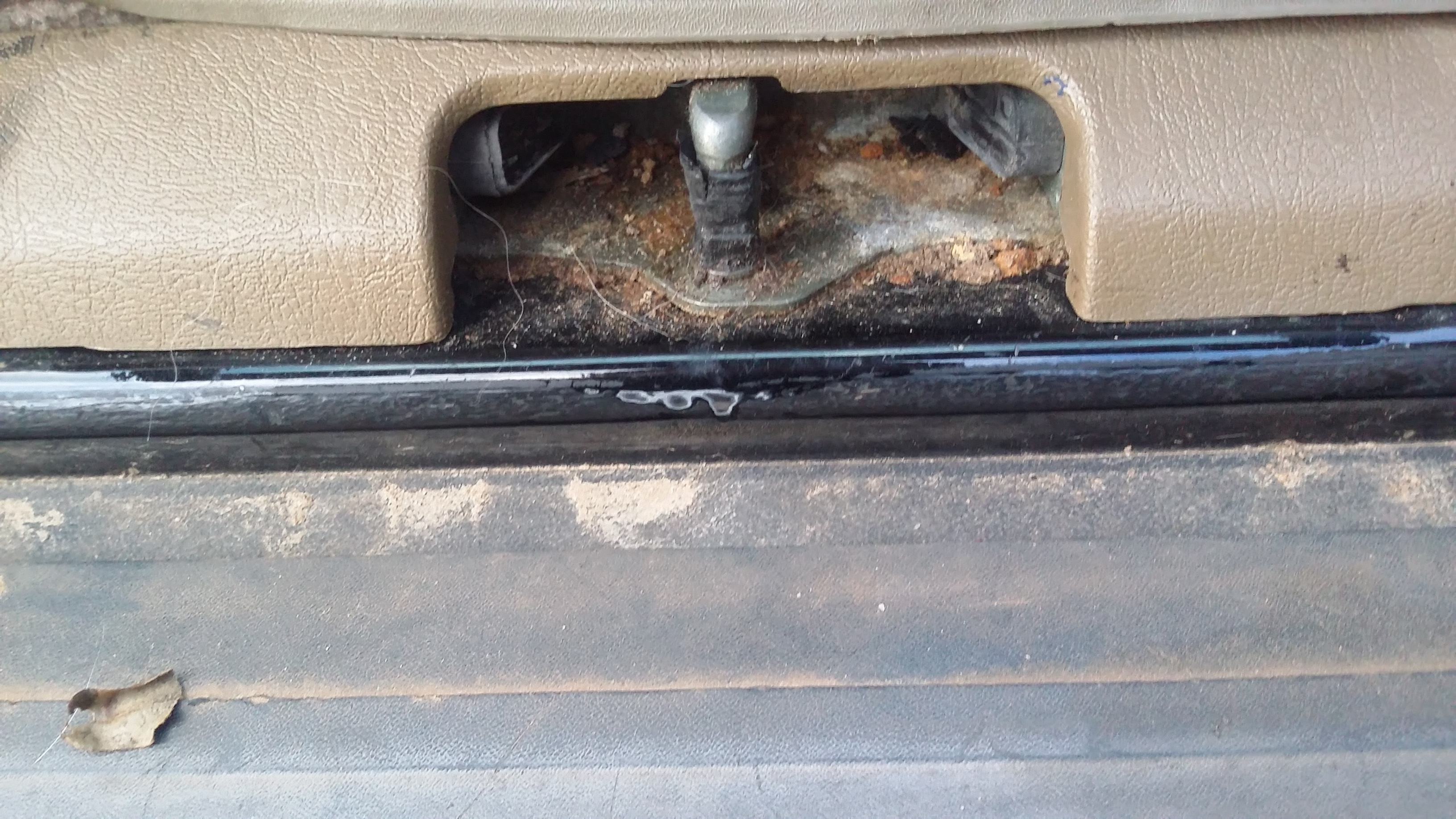

It will certainly help and reduce the squeaking. There is a nylon sleeve over the pin on the latch which snugs the latch. This breaks with age as can be seen in your pictures.
If I recall the latch was relatively cheap new. Unless you find an unbroken one (unlikely) used, it is still better to replace new.

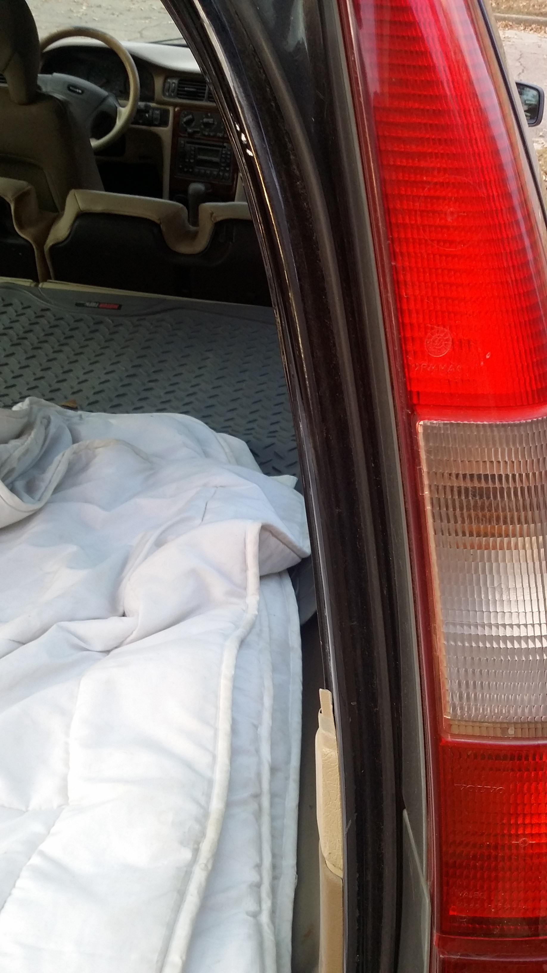

I am talking about the part on above the bumper that the latch on the tailgate latches to as you show in your 2nd picture. So not the part that fits to the bottom of the tailgate. V70 part is not the same striker plate as S70.
Also check the side buffers are fitted and adjusted on either side of the tailgate.
