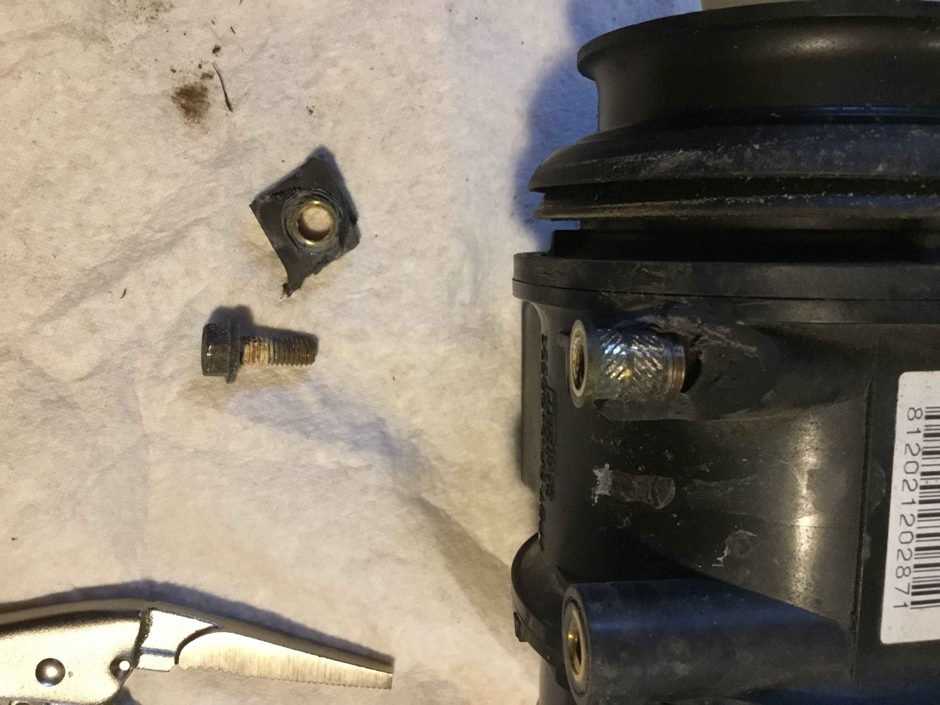

Issue * came across harvesting a MAf today
The MAf on NA cars are made by DENSO and mount with two M6 (10mm head ) bolts
The bolts are typical steel but bolt into brass threads fused into the air cleaner
I had bad galvanic corrosion on one of mine, so bad the fused and broke the threaded insert ou to the plastic
I had to Dremel it put and re-epoxy the insert into the MAF
Check your cat too, while you test your bolts.

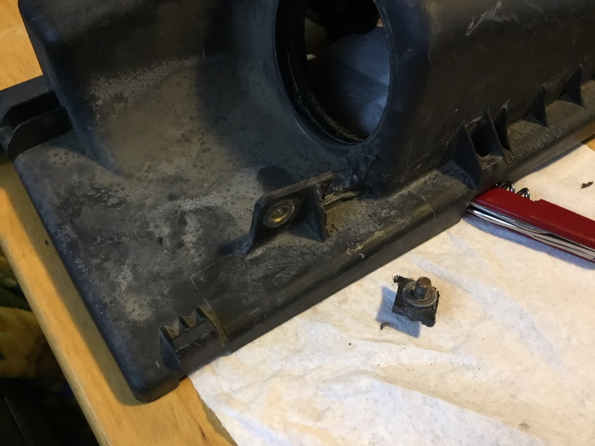

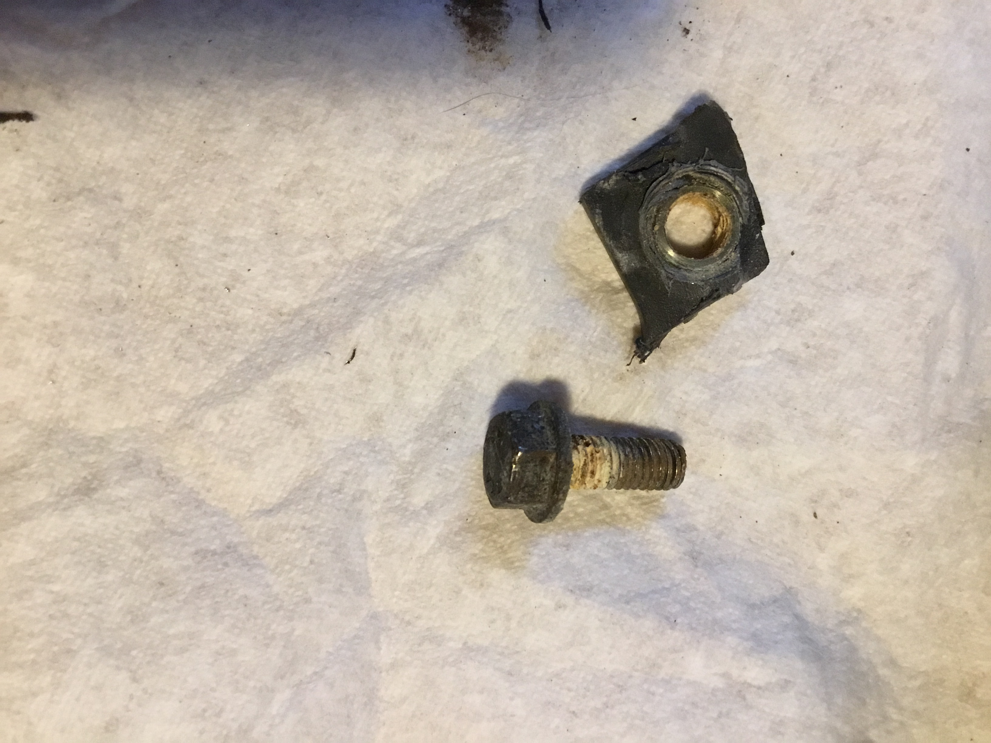

Clarifying a bit more
The design is m6 bolt, clearance. Brass boss on air cleaner housing, threaded brass m6 insert in MAF, two pieces.
Look how the bolt corroded in the brass boss, but not in the insert.
Strange. When I went to unscrew this it locked up in both, then broke the insert out of the MAF. It was also locked into the brass boss.
