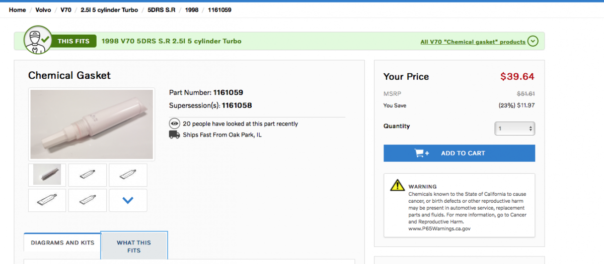

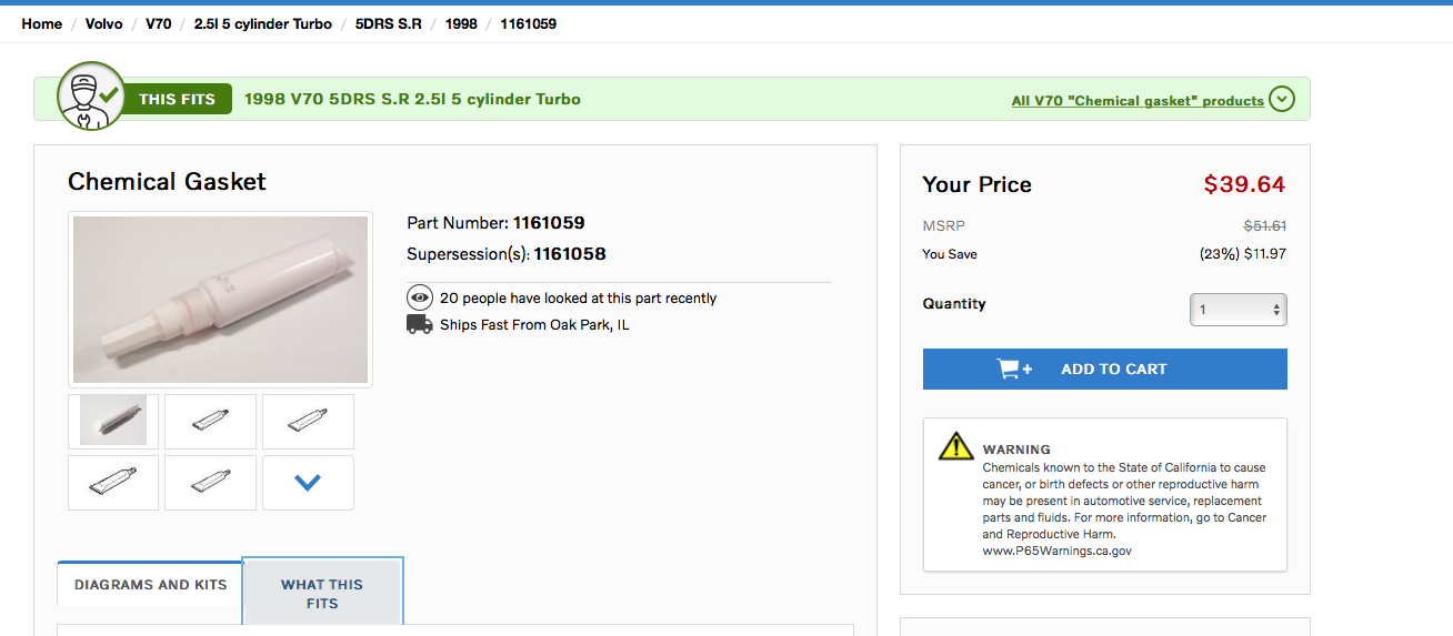

Inspired by SM in the middle of his V70 NA head gasket/valve job
I did a quick search in the Forum and found people reporting success with three products for the cam cover sealer.
Volvo sealant 1161059 1160158 about $40 per tube
(see photo attached)
