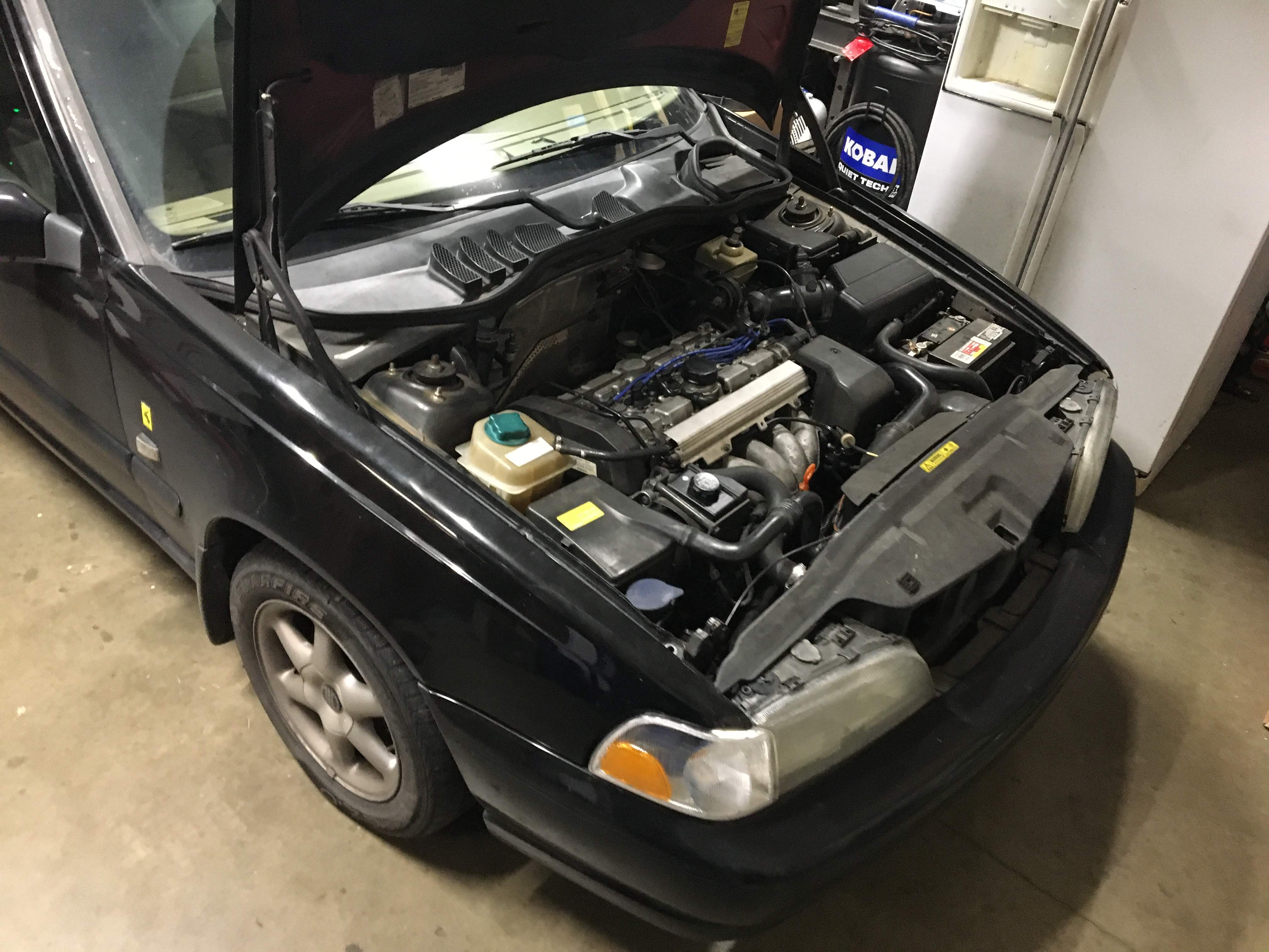

An old friend came to visit today... I need to diagnose a P0300, P0305 misfire issue and do the timing belt, water pump, and some other work in preparation for a 19T.
Always nice to see my old GLT!
