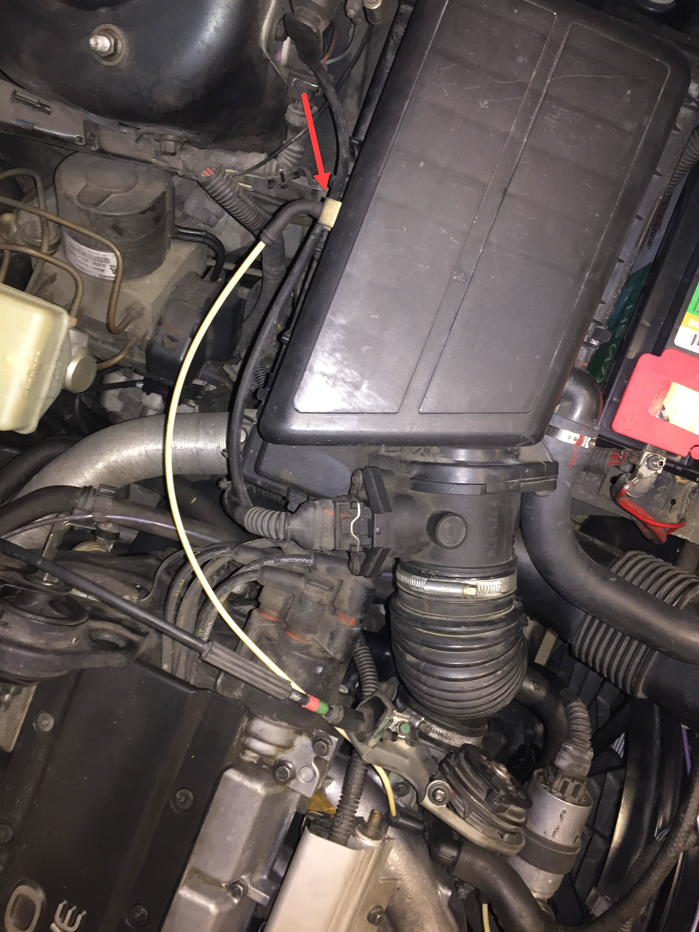

- Small hoses connect to vacuum T all hold vacuum except for the line to the airbox. Is it ok for the vacuum line to the airbox to hold no vacuum? Should the connection to the airbox (see arrow) have a check valve?

Anyone know if the white tube going into airbox should hold vacuum? Thanks.

Yes it does. It drives the air box motor to regulate the air box temperature, so it doesn’t hold vacuum it’s letting in unmetered air into the throttle body
