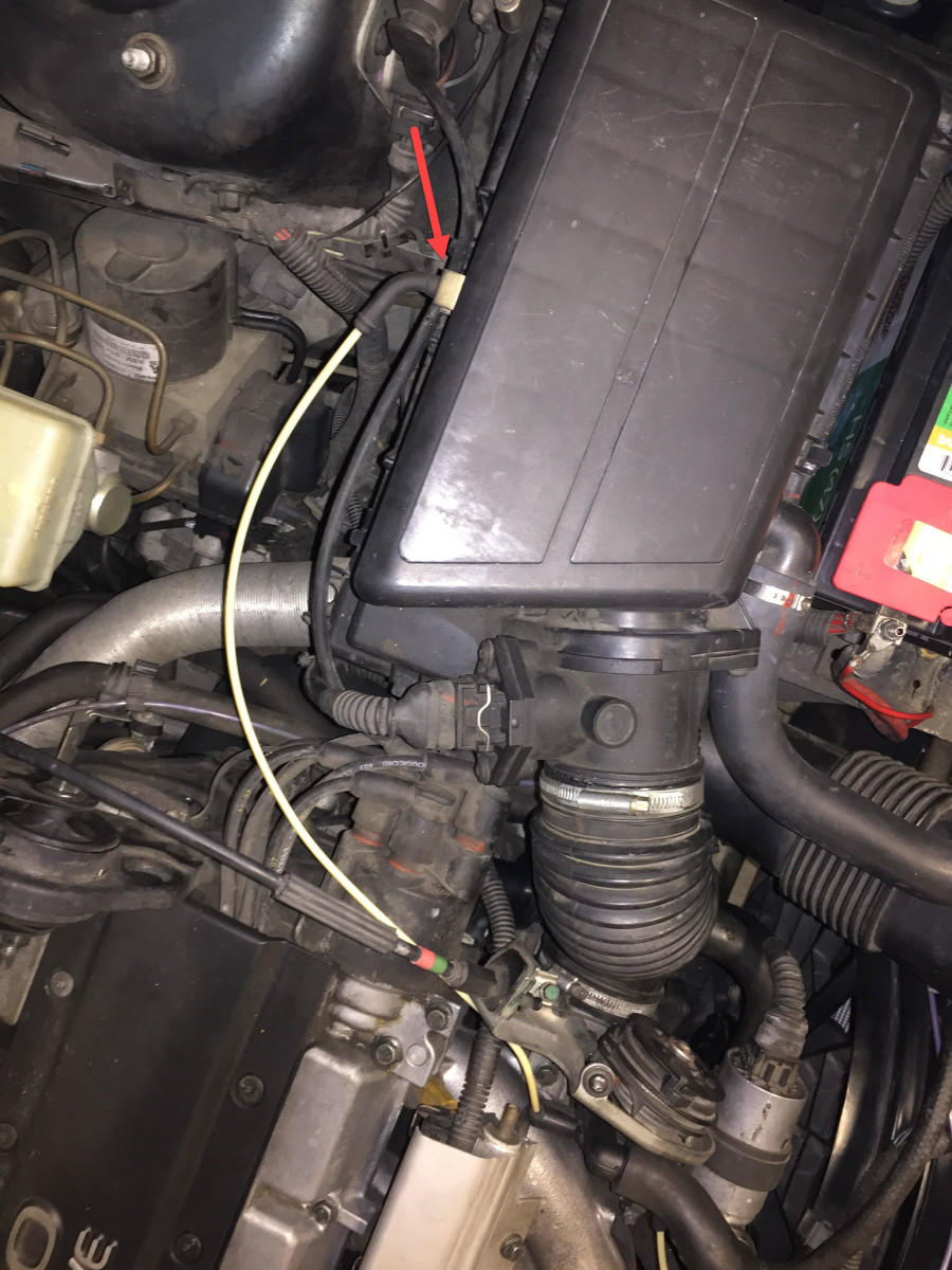

- Small hoses connect to vacuum T all hold vacuum except for the line to the airbox. Is it ok for the vacuum line to the airbox to hold no vacuum? Should the connection to the airbox (see arrow) have a check valve?

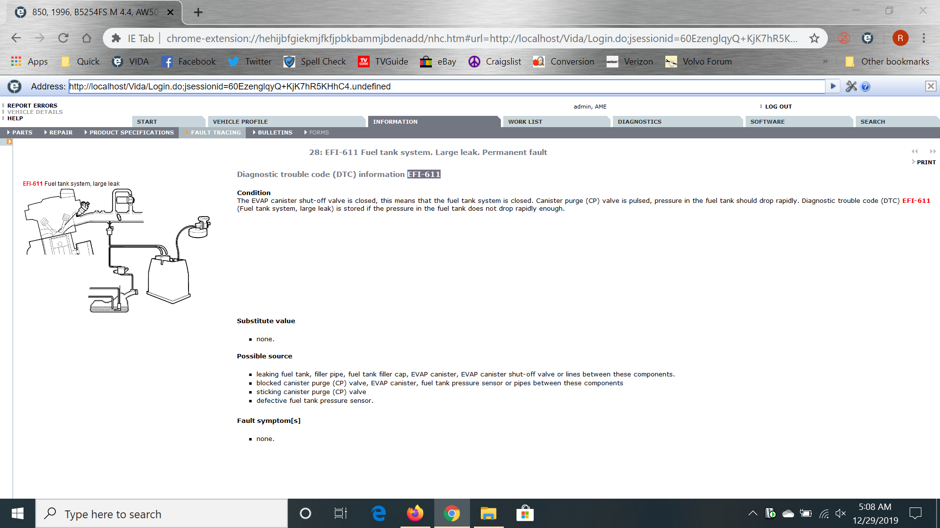

Possible source
Possible source
- Leaking fuel tank, filler pipe, fuel tank filler cap, EVAP canister, EVAP canister shut-off valve or lines between these components.
Blocked canister purge (CP) valve, EVAP canister, fuel tank pressure sensor or pipes between these components
Sticking canister purge (CP) valve
Defective fuel tank pressure sensor.

A lot of failure points identified by EFI-611 are near the tank. Maybe I should do some more smoke testing in that area.

Anyone know if the white tube going into airbox should hold vacuum? Thanks.

Yes it does. It drives the air box motor to regulate the air box temperature, so it doesn’t hold vacuum it’s letting in unmetered air into the throttle body
