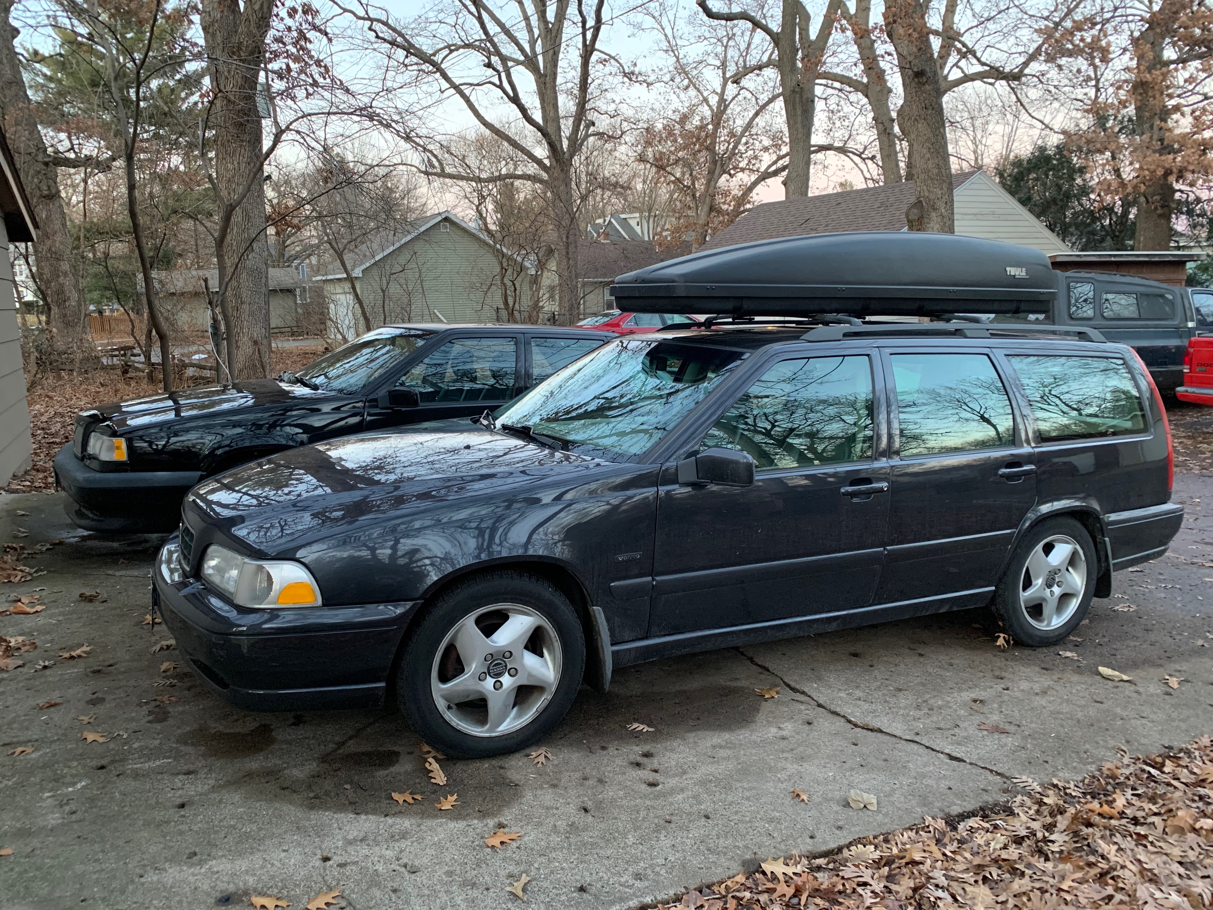

I rarely post any pics of my cars - here's one!
The V70 is 427 black, here it is the day after finishing a 2,000 mile round trip over the December holiday. I like the 427 color, it edges a bit toward gray. The 850 R in the background is standard 426 Black, you can see the color difference somewhat here.
427 black V70 and 426 black 850

Are those the Perfo or Columba wheels on the V70? Paint looks incredible on a decades oldcar(s)

Post by raivis_rsn »
Columba

Post by bmdubya1198 »
Those are Columbas. I love 427, such a cool color. I've only ever seen one in the junkyard, unfortunately.
