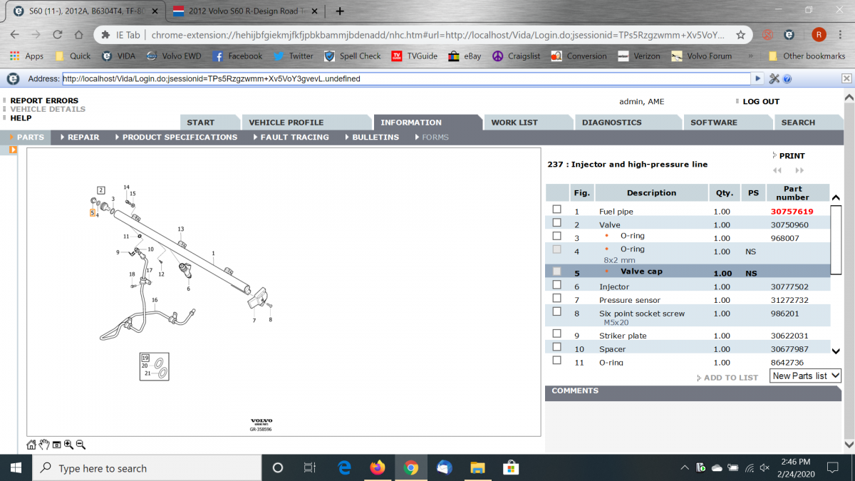

On that car there i no way to do the injector leak test. The fuel line is a hard line with no way to have injectors out of ports and fuel line still connected. But you don't need to test for leaking injectors that way. Leaking injectors give black smoke on start and almost always will do this after 15 min or longer shut down and then start within 1.5 hours. If it restarts fine after trips into the grocery etc but has long crank cold then fuel line draining due to check valve is more likely. On that late models (1999 and later for most models) the fuel system is dead end and for the air to get out the injectors have to cycle to vent it. If you cycle the key on twice and then go depress fuel test port schrader valve and let air out and then a little fuel passes and then you cycle key once more and it cranks immediately then the check valve is the issue.
Thanks for this info. Sadly, there doesn't appear to be a schrader valve on the fuel rail on these vehicles. How do you test the fuel pressure without relying on the fuel pressure sensor if there is no valve??jimmy57 wrote: 16 Feb 2020, 18:37 On that car there i no way to do the injector leak test. The fuel line is a hard line with no way to have injectors out of ports and fuel line still connected. But you don't need to test for leaking injectors that way. Leaking injectors give black smoke on start and almost always will do this after 15 min or longer shut down and then start within 1.5 hours. If it restarts fine after trips into the grocery etc but has long crank cold then fuel line draining due to check valve is more likely. On that late models (1999 and later for most models) the fuel system is dead end and for the air to get out the injectors have to cycle to vent it. If you cycle the key on twice and then go depress fuel test port schrader valve and let air out and then a little fuel passes and then you cycle key once more and it cranks immediately then the check valve is the issue.
- RickHaleParker
- Posts: 7196
- Joined: 25 May 2015, 14:30
- Location: Kansas
- Been thanked: 977 times
Unscrew the Valve cap on the end of the fuel rail.ncnmra wrote: 24 Feb 2020, 13:01 there doesn't appear to be a schrader valve on the fuel rail on these vehicles.
