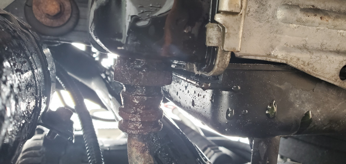

Any tips to get lower oil line off the radiator?
Can NOT get this to come out. Any tips?

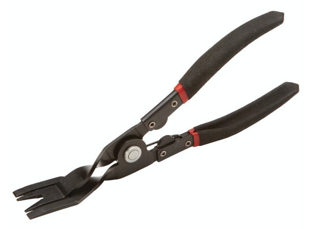

Tricky! It should pull directly out, but the rings and spacers are probably preventing it from releasing.
If you have a pair of panel clip pliers, those might allow you to get it out.

Sat in PB Blaster for a few hours. Still wont budge.
The housing that it fit into spins, so I most likely broke something.

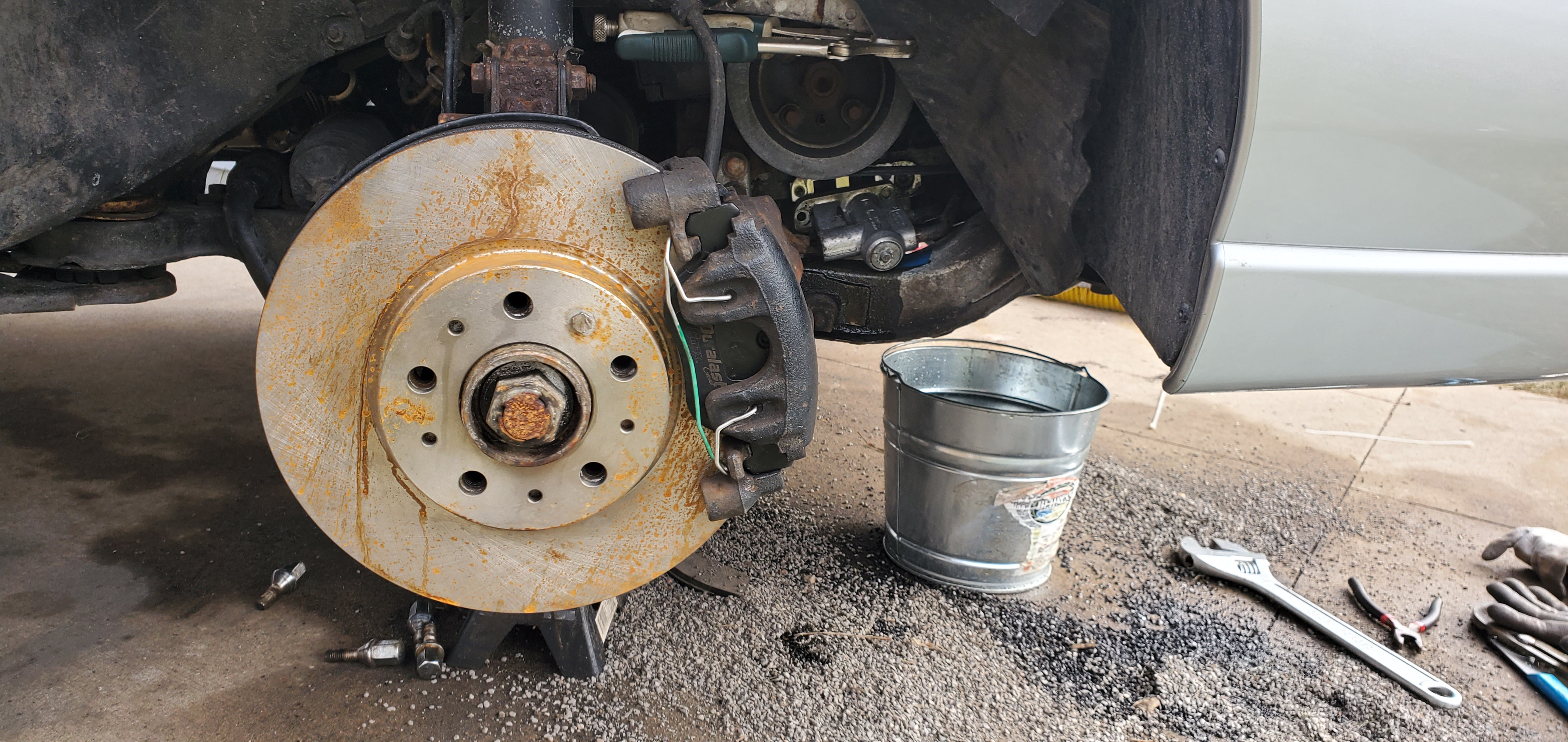

PB Blaster for a day and a half. Wrenches, Channel locks, pliers, rubber mallet. This this absolutely will not budge....
Sucks, because it's the only thing holding me back. Oil thermostat is off and I got new brakes all around. Just need this lower hose off and I get to drive her again.
