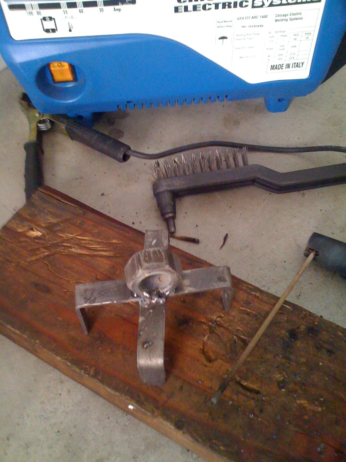

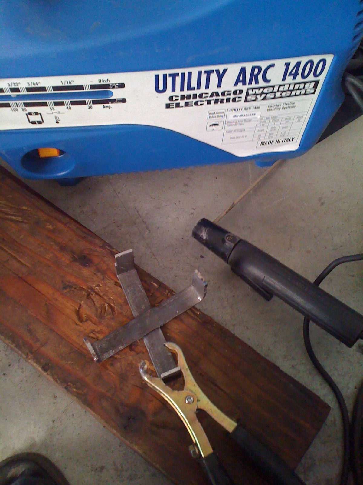

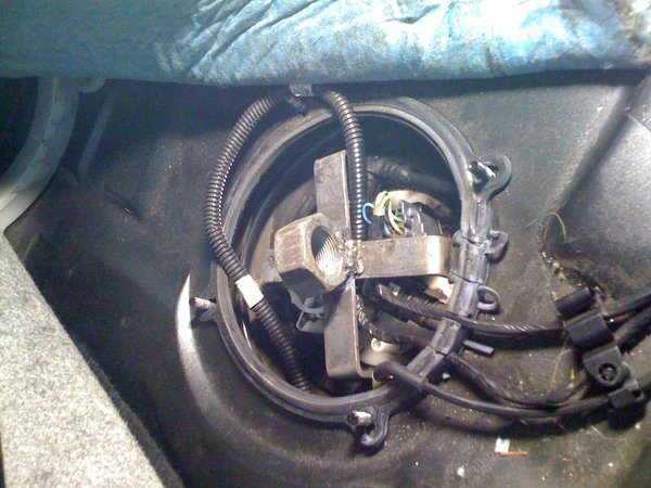

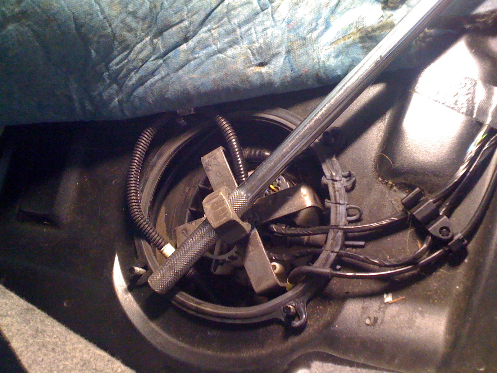

I just finished my tool made w/ a 1/8 x 3/4 flat bar, welded them together and put a axle nut on top
and use a power handle to turn the retaining ring on top of the fuel pump. The fuel lines and the
wire harness has to be removed first before turning. My welding is sloppy - I'm still learning but
the tool works perfect. I think I'll have this patented????? :lol: I'll post some pics here so it would be
\easy for u to make your own in case u want to open up your fuel pump. BTW I had to grind off one
side of the flat bar so they would fit into the slot of the ring.
tool sitting on top of fuel pump w/ power handle inserted into the big nut
