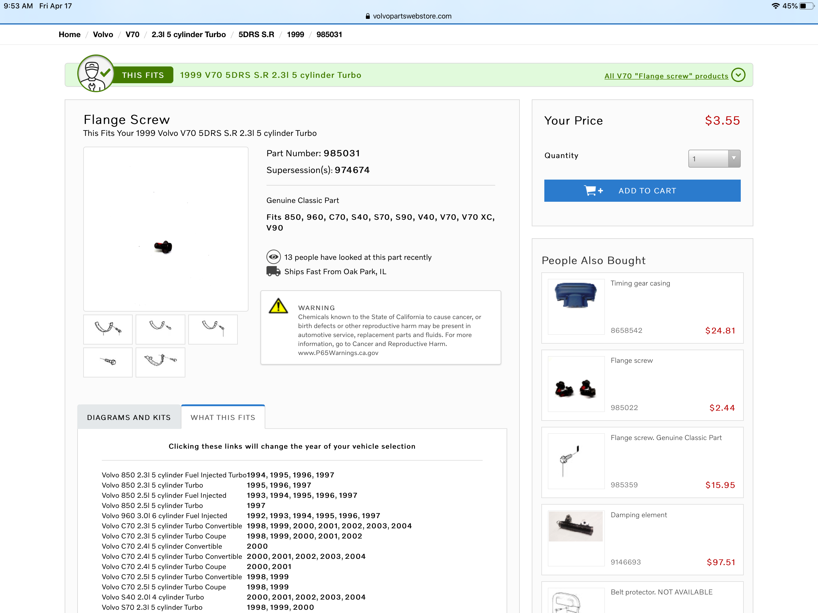

From research it looks like these bolts changed to M6 with a boss at the top shank in 1999

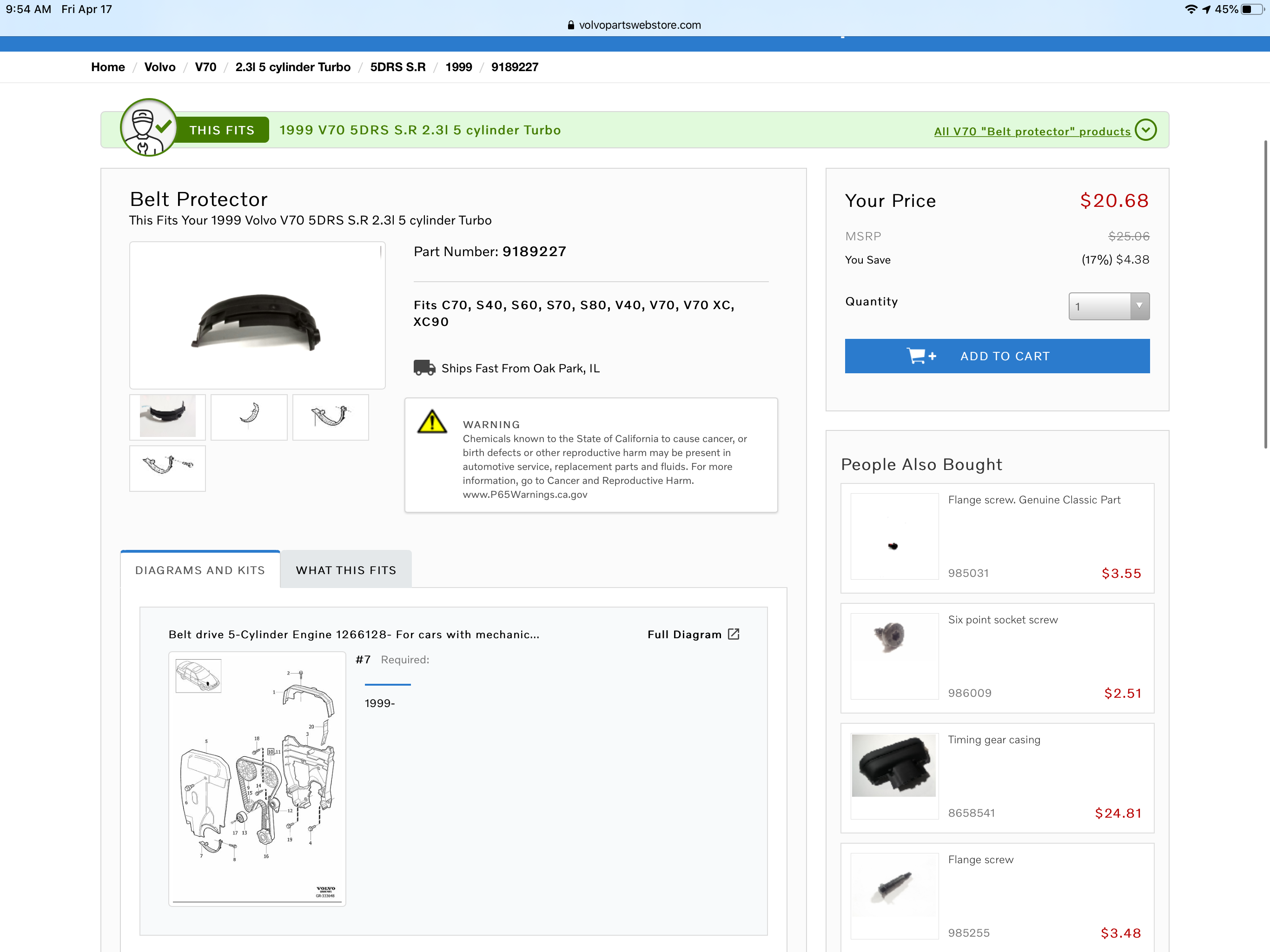

There is also a third bolt with big rubber washer for the rear, inner timing belt plastic shown

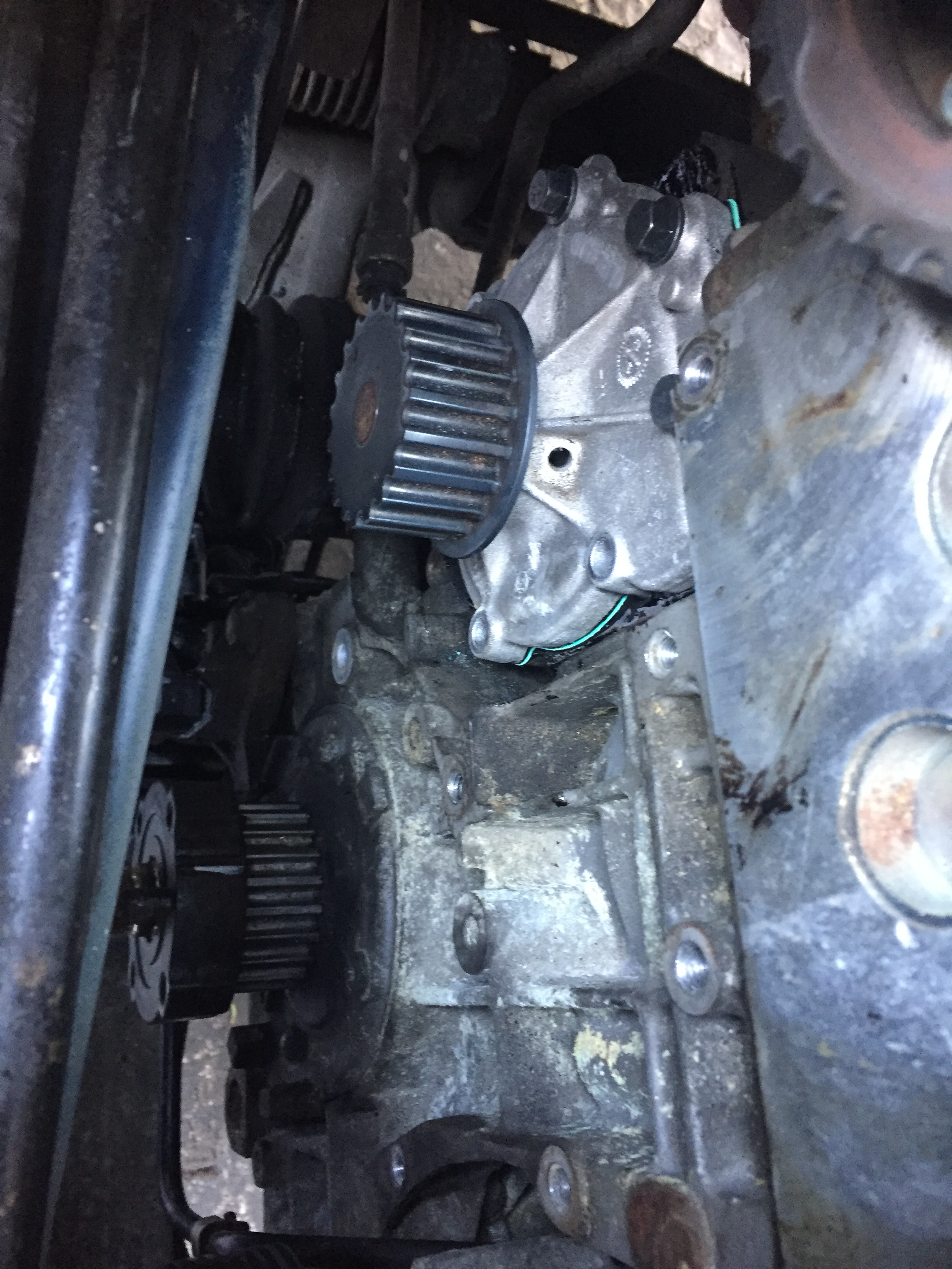

You can clean the plastic while you remove the water pump you just installed by mistake as it has to go on first.

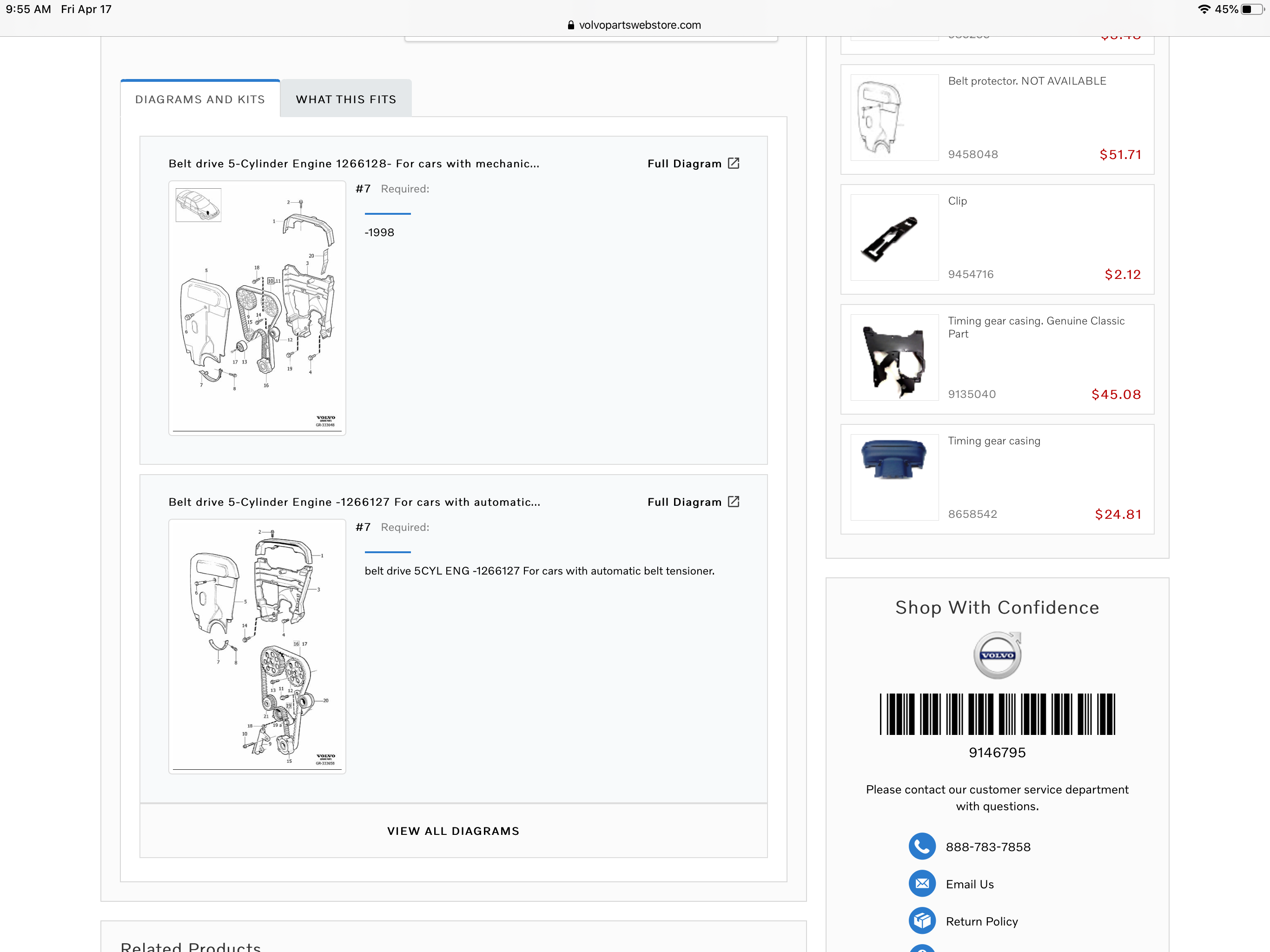

Further research. There is a mid 1998 chassis break on the tensioner that’s changes both the lower engine guard plate and the flange screws

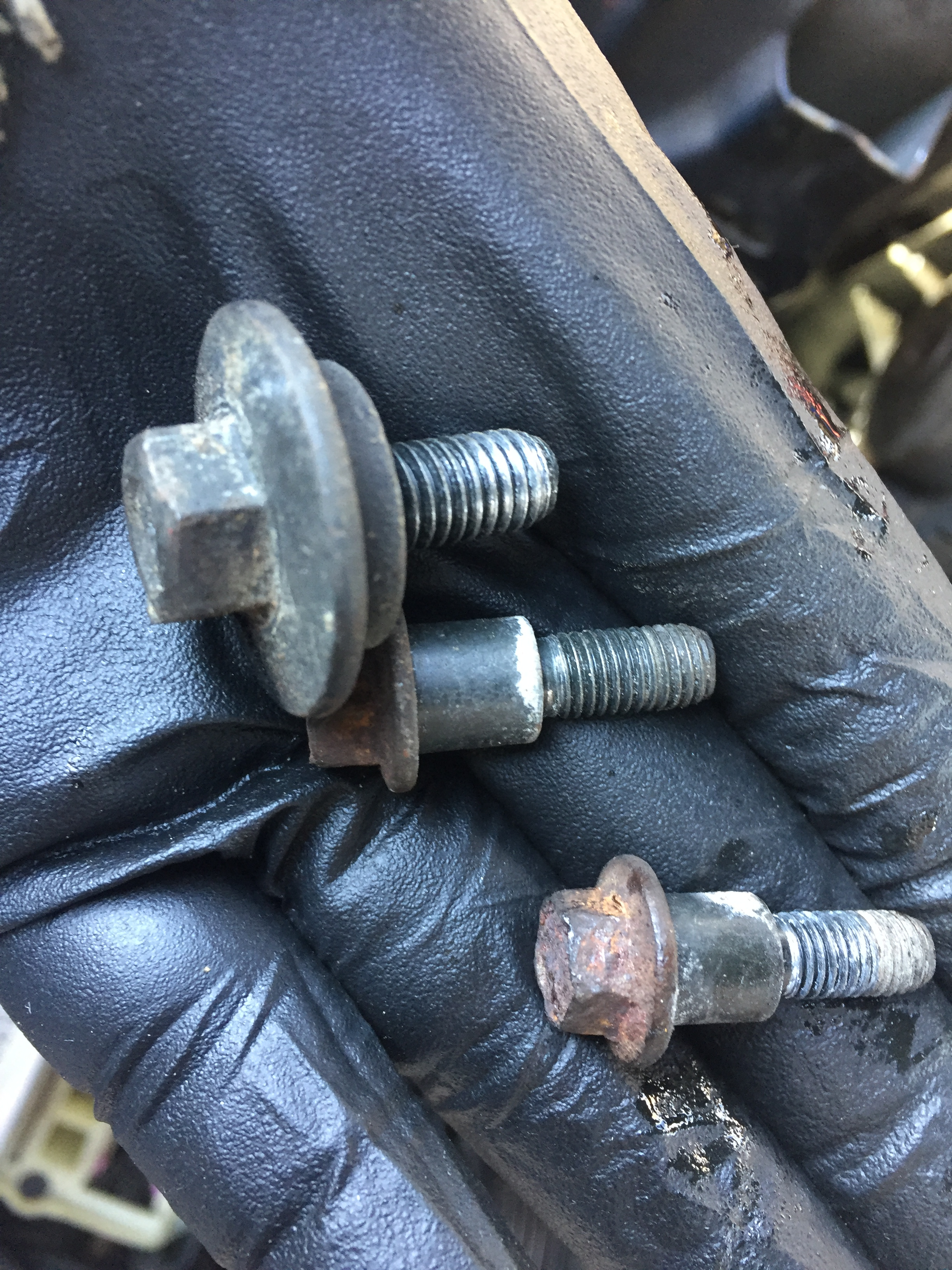

Don’t lose these !
1999 lower timing belt guard bolts
