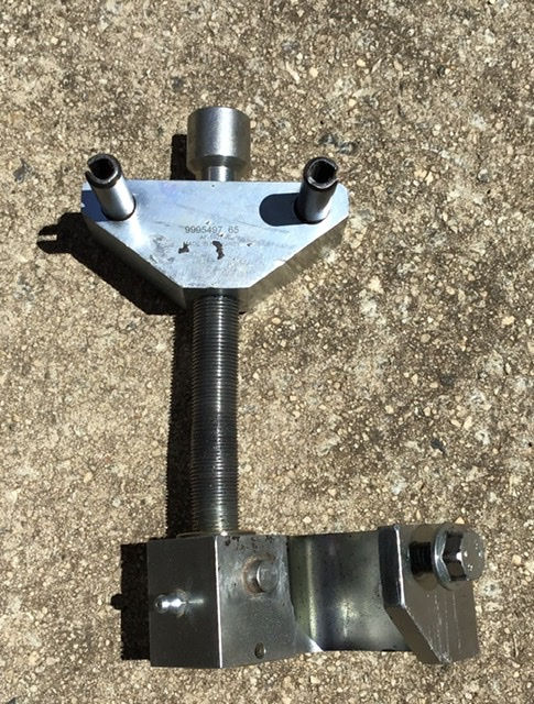

Funny you should ask... the threaded shaft bent while removing the second bushing (this was before I knew extreme heat was my friend). Since I owned it for a whopping one week and used only on my car they issued me a store credit.abscate wrote: ↑26 May 2020, 11:34I wonder if you bust the tool, is it still under the FCP warranty program?my98s70glt wrote: ↑26 May 2020, 10:43 FCP has them as well... https://www.fcpeuro.com/products/volvo- ... vo-9995497

Did this require a breaker bar or an impact driver?
my98s70glt
- Posts: 24
- Joined: 16 December 2019
- Year and Model: 99 V70R, 07 V70 2.5T
- Location: Concord, NC
- Has thanked: 11 times
- Been thanked: 5 times
I used a breaker bar, it was a bear of a job without using enough heat to melt the outer plastic shell on the bushing.

They say not to use an impact driver on those tools...
I run a drill bit through the plastic bushing sleeve on the top of the bushing.
It allows the shell to break away from the arm. Also, it leaves no melted mess.

The force required to bend that is crazy...my98s70glt wrote: ↑26 May 2020, 15:09Funny you should ask... the threaded shaft bent while removing the second bushing (this was before I knew extreme heat was my friend). Since I owned it for a whopping one week and used only on my car they issued me a store credit.abscate wrote: ↑26 May 2020, 11:34I wonder if you bust the tool, is it still under the FCP warranty program?my98s70glt wrote: ↑26 May 2020, 10:43 FCP has them as well... https://www.fcpeuro.com/products/volvo- ... vo-9995497

I bought mine from IPD. It was such a challenge getting them out, that I stripped the threads on the tool. I think the picture you are showing is the transverse arm bushings. On my 96 850 the rubber looked good but the metal bracket was broken.
