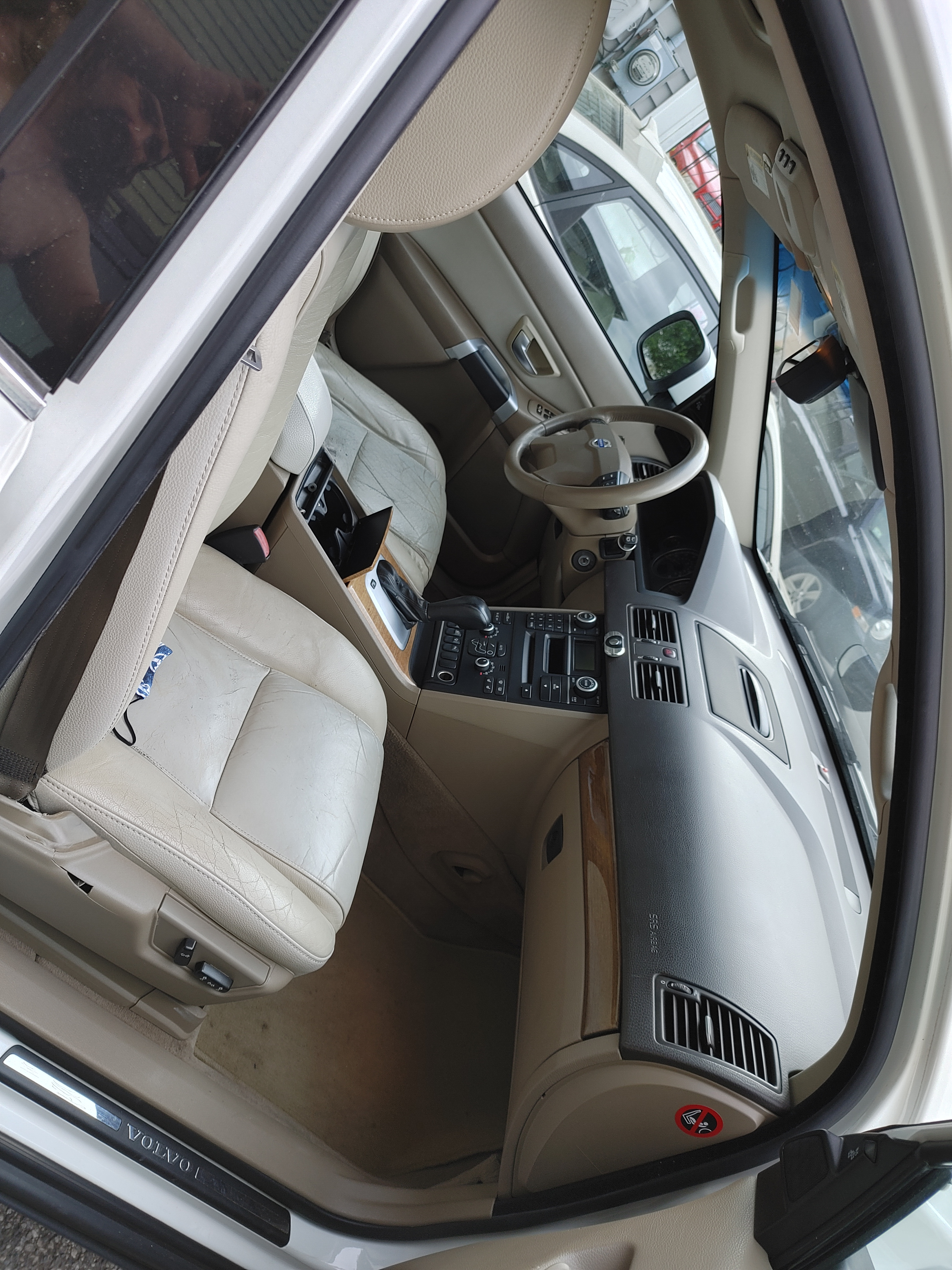

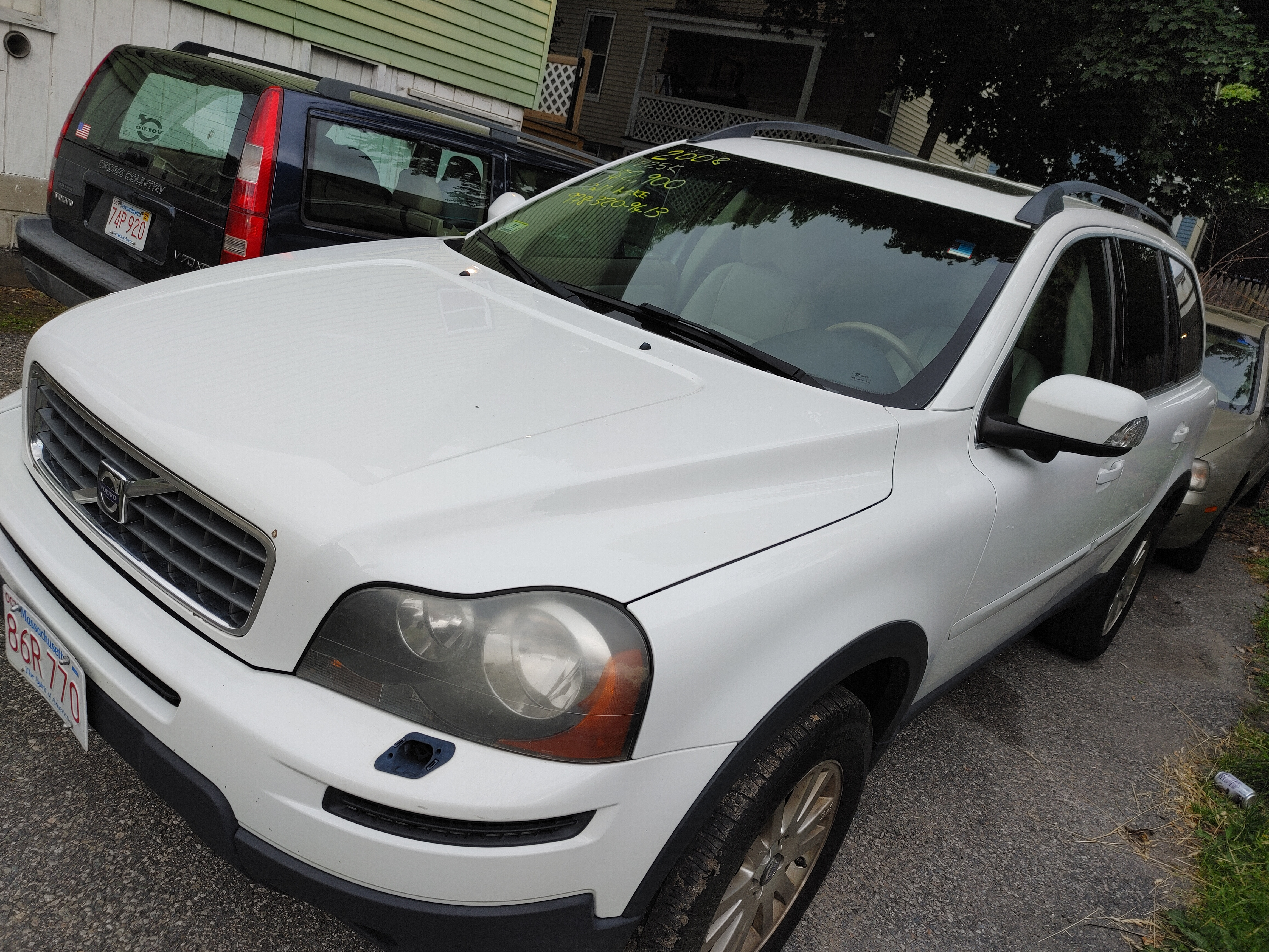

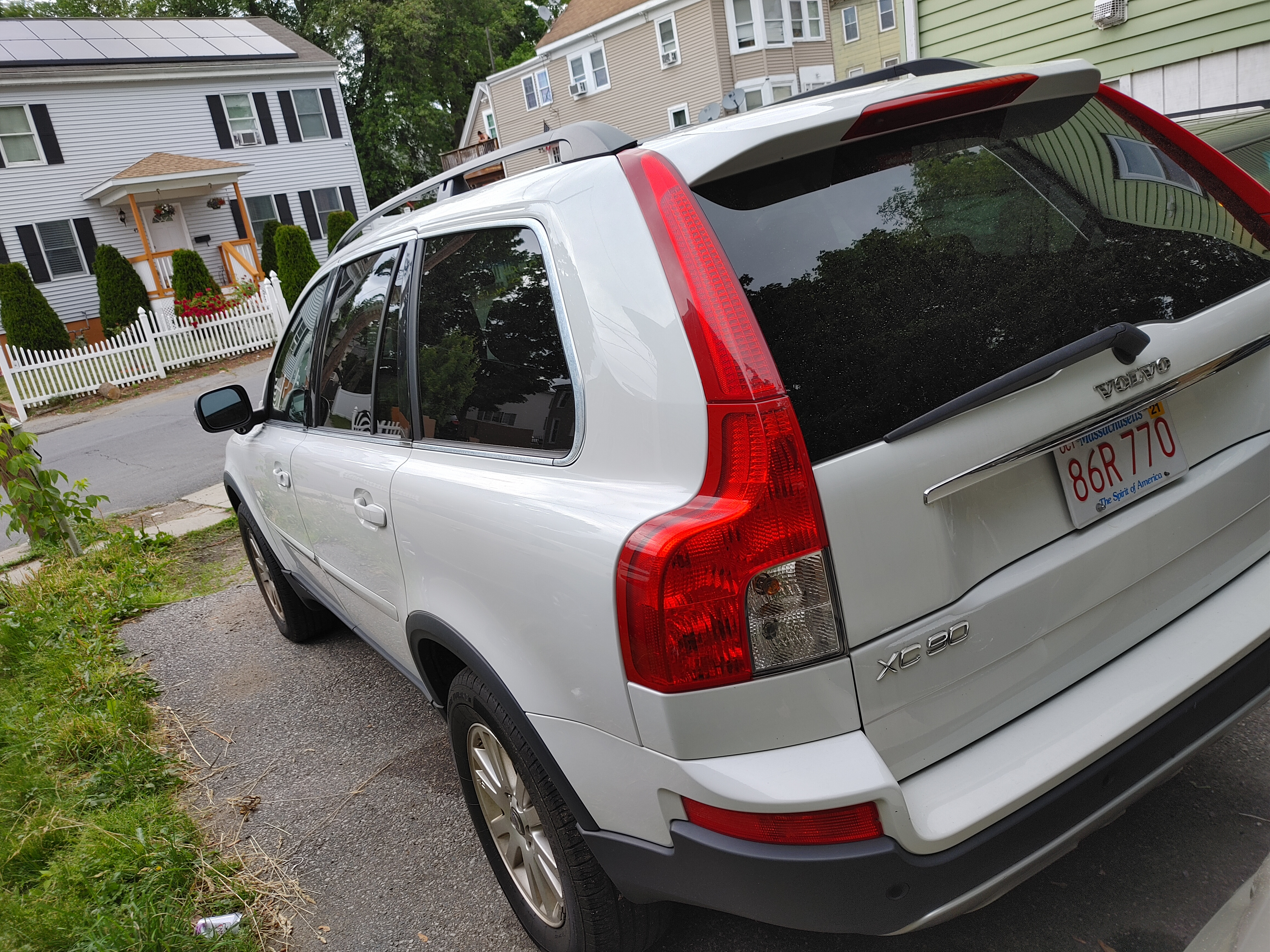

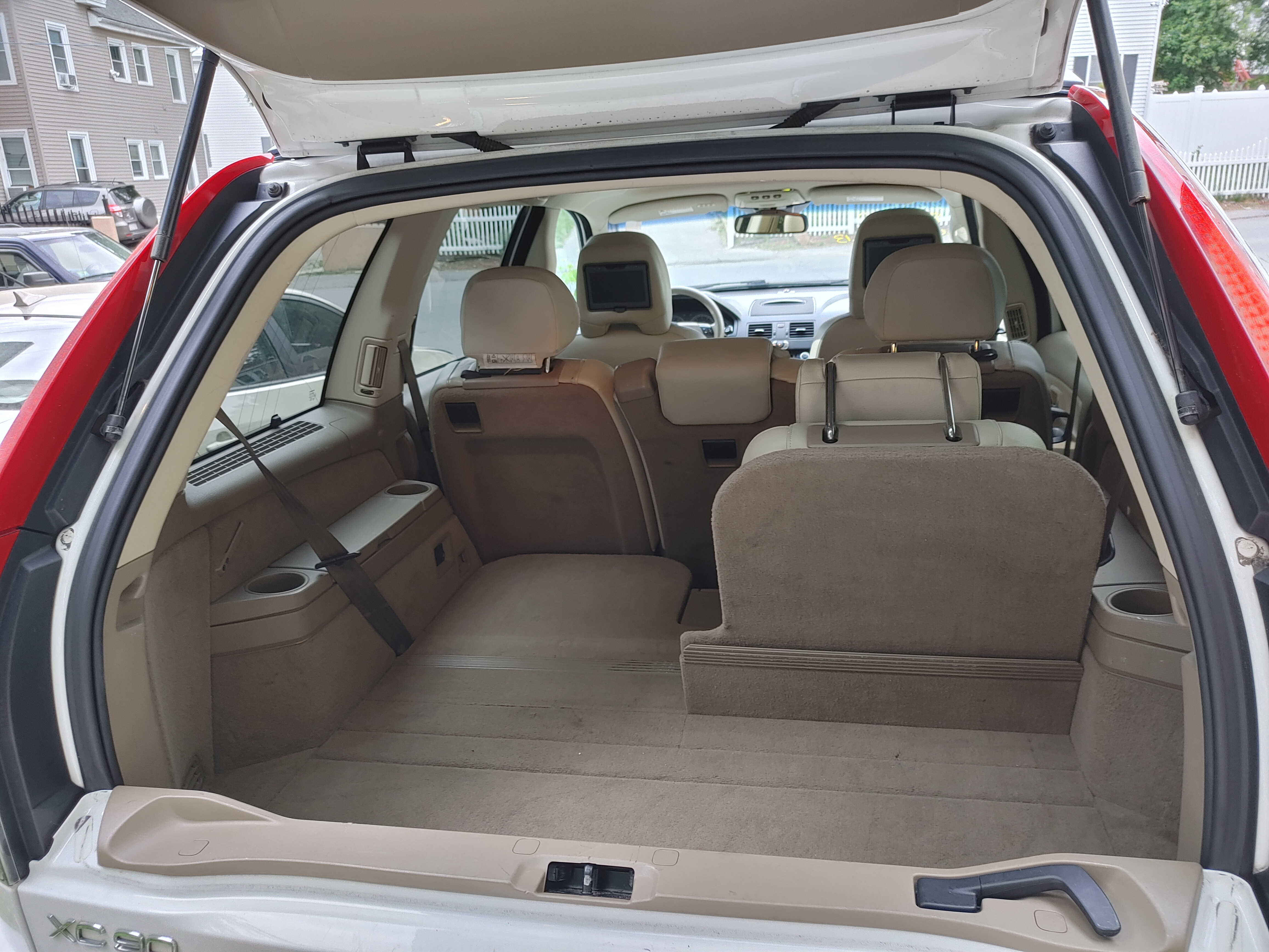

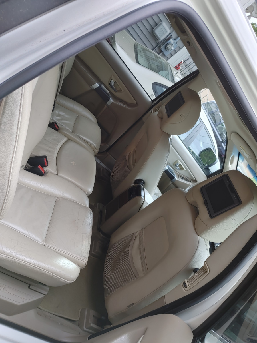

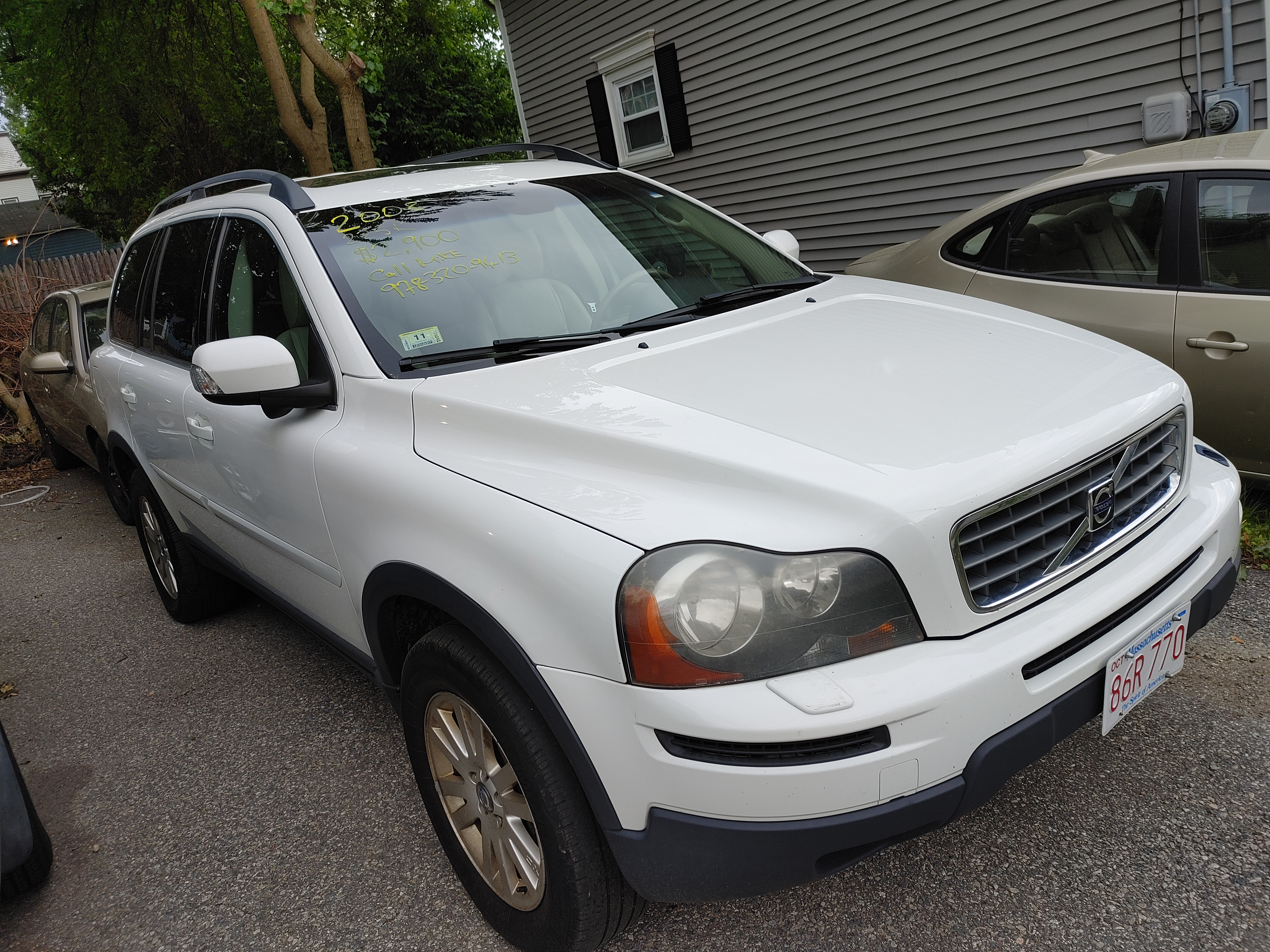

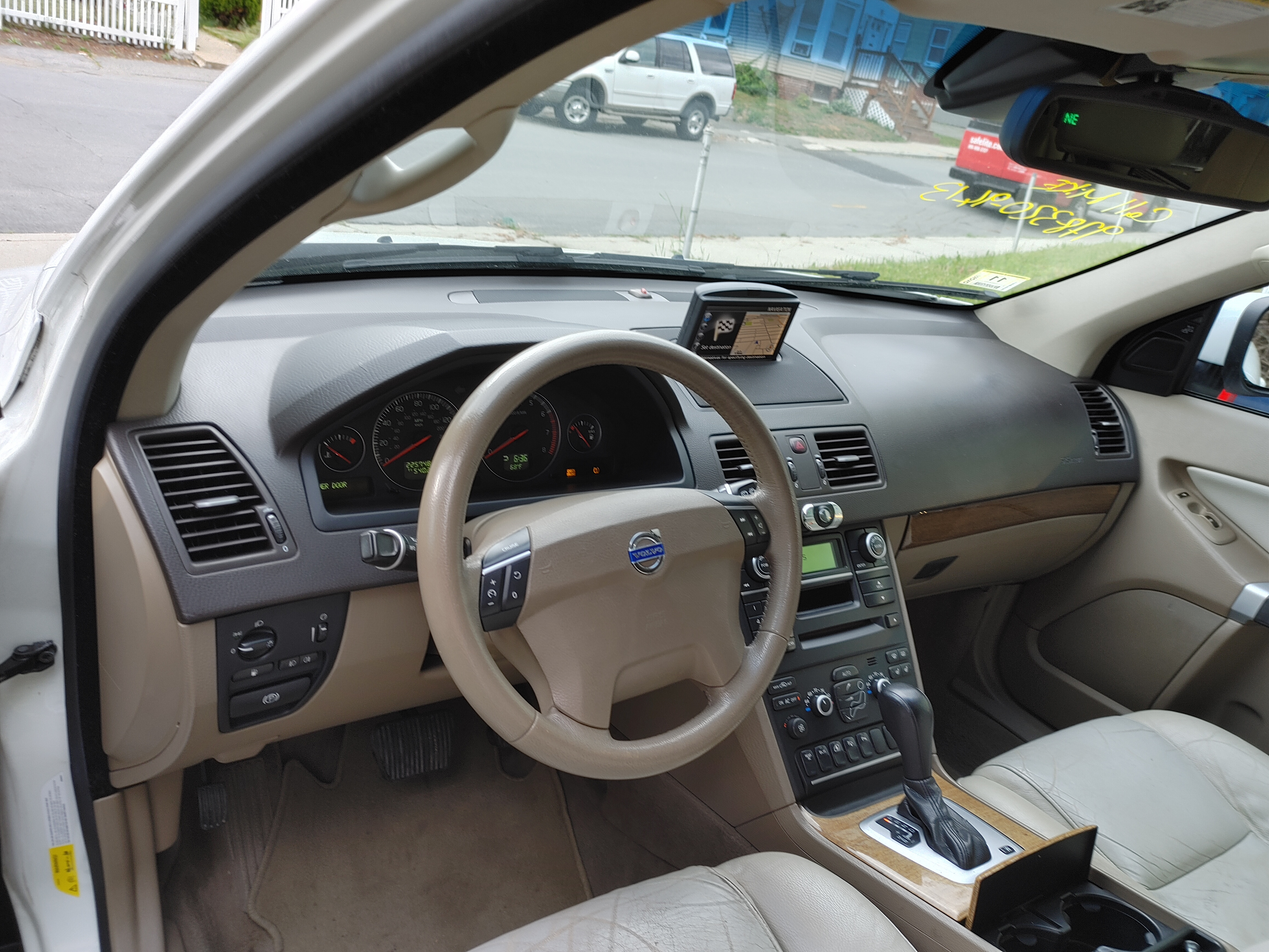

So I just picked this gem up. 08 xc90 3.2. She has high miles but in great shape. It needs tires and the only messages is service tire monitoring system but I'm hoping a trip fie new tires will take care of that. I bought it off a small dealer and it came from an auction. By all checks it appears to have been maintained fairly well. The only thing I noticed is under hard throttle I hear a noise that almost sounds like a wheel bearing going bad, mostly on the front right side sitting in the car. Any thoughts on what to look for there? But I think a good snag for $2500.
