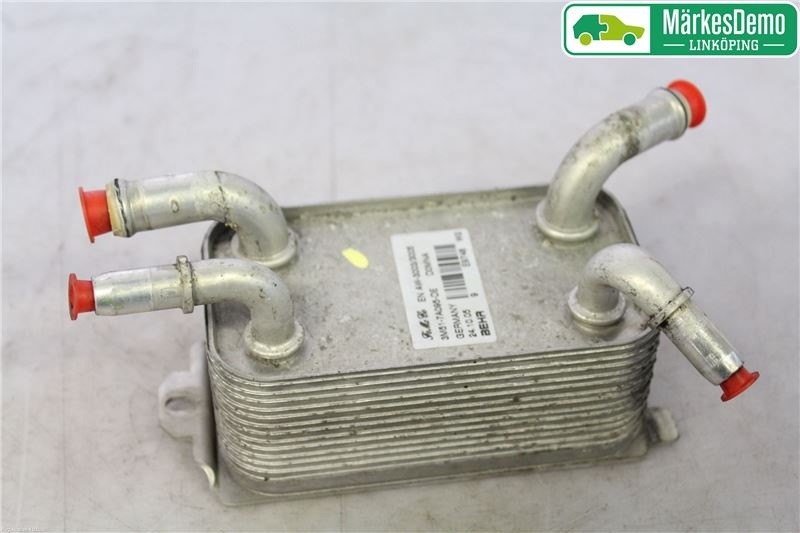

My 2006 V50 2.4i overheats when driven aggressively. Its a B5244S4, made in Belgium, and has a Behr oil cooler (3M51-7A095) with 4 ports. One of the top lines is coolant and the other is vacuum line.
located on the front, left of the radiator
Is it the transmission cooler? The information indicates oil coolers are found either on a diesel or turbo engine.
Could this oil cooler become blocked intermittently causing the engine to overheat?
https://www.autoparts24.co.uk/item/D_0071_567234/
used behr UK.jpg (66.19 KiB) Viewed 1024 times
Please advise / direct.

That’s the transmission oil cooler. I don’t think it being clogged would cause overheat. I’d be looking at the thermostat, coolant temp sensor, or radiator/cooling fan function
