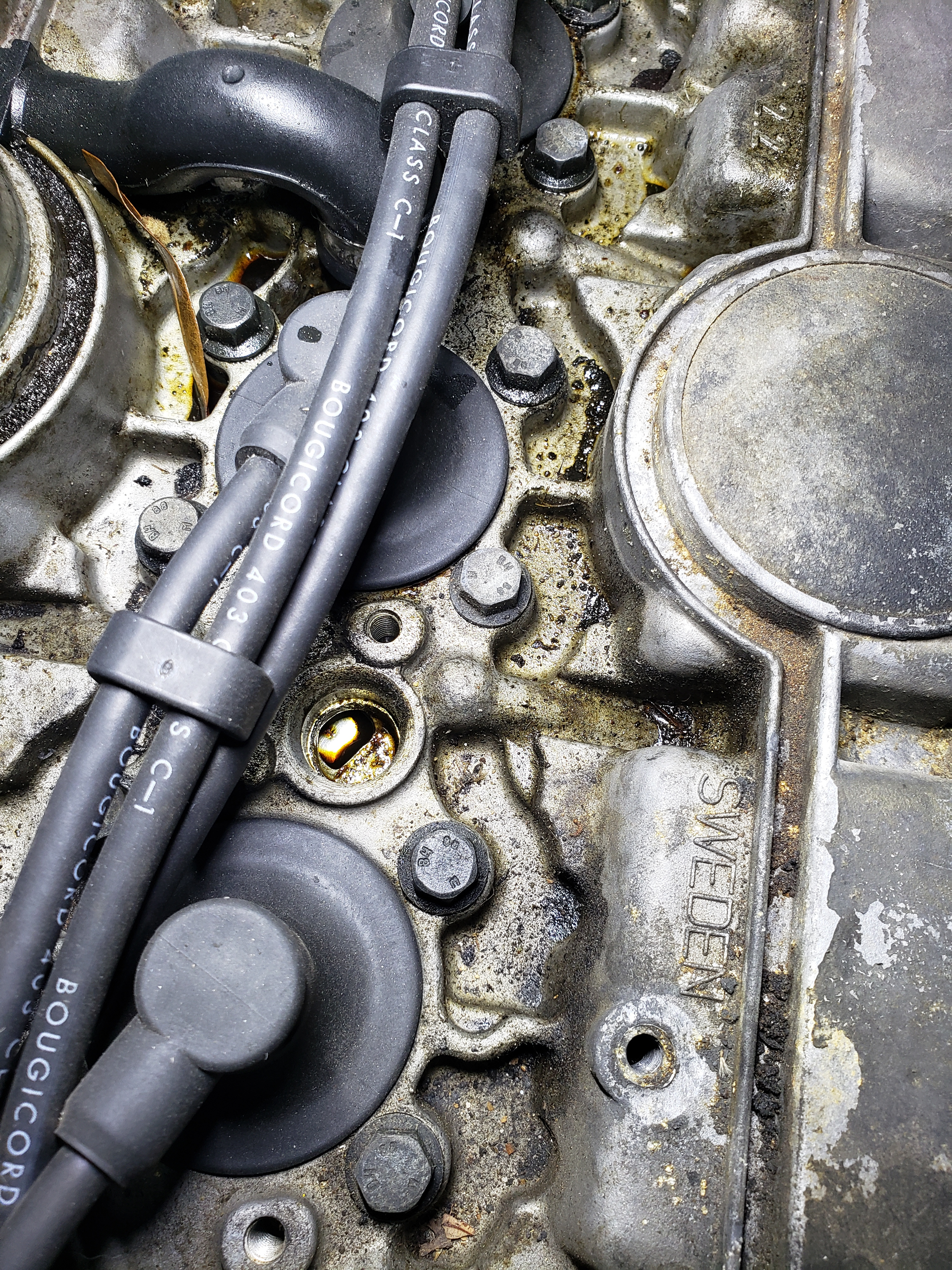

In addition to the valve seal leak at "the hole" and some seepage elsewhere, I'm concerned about a bad head gasket. I'm playing the "is it worth it game."

So... I'm on the fence about simply plugging "the hole" and I'm on the fence about doing an entire head gasket job. Need to determine if the engine/car is worth the work (180k miles and 22 yrs old...).

Chuck W wrote: 09 Jul 2020, 05:01 I know I replied to this last night...
That hole is normal and as you guessed, there seal on the cam cover has failed, for whatever reason.
There is another THREAD on this forum discussing the same issue.
I read a long thread on it and searched on some others a while back, but can't remember where it was, but the deal is that on earlier versions of the engine, that port was actually connected to something in the head itself. The turbo models never had this system.
At some point, the head was revised, deleting that port, but the cam cover never was, and thus there is a "hole" to nowhere. (Well, it's blanked off on the head).
If oil is coming out of it, your cam cover seal has failed.
Your "rock" is probably just random debris that happened to wind up on top of the engine, and not part of anything engine-related.
To throw a spanner in the works, my 96 850 T5 has that hole.

Cookeh wrote: 10 Jul 2020, 16:47
Is something connected to the hole or is it left empty? It looks like they made the change somewhere in '93 or '94.

Keep in mind, that hole is only in the cam space, The PCV hose coming in should be the only pressurization this space gets. This area is NOT tied to a head gasket leak.
Your coolant symptoms may be. The combustion gas test is a MUST. the only sure way to know.
I drove the POS70 for three years adding a little coolant every week. ( and oil regularly) But never had the test fluid turn green/yellow, or lost compression. Ran like a champ.
These motors have been known to run steady compression, not overheat as long as the fluids are monitored, and have minor HG leaks.
Mine was at a stage 0-1/2 because of the leaks. Verify that your cap and bottle are good.
As does my '97 T5.
Like has been mentioned, there is nothing behind it on the head.
They changed the head, but didn't change the cam cover casting.

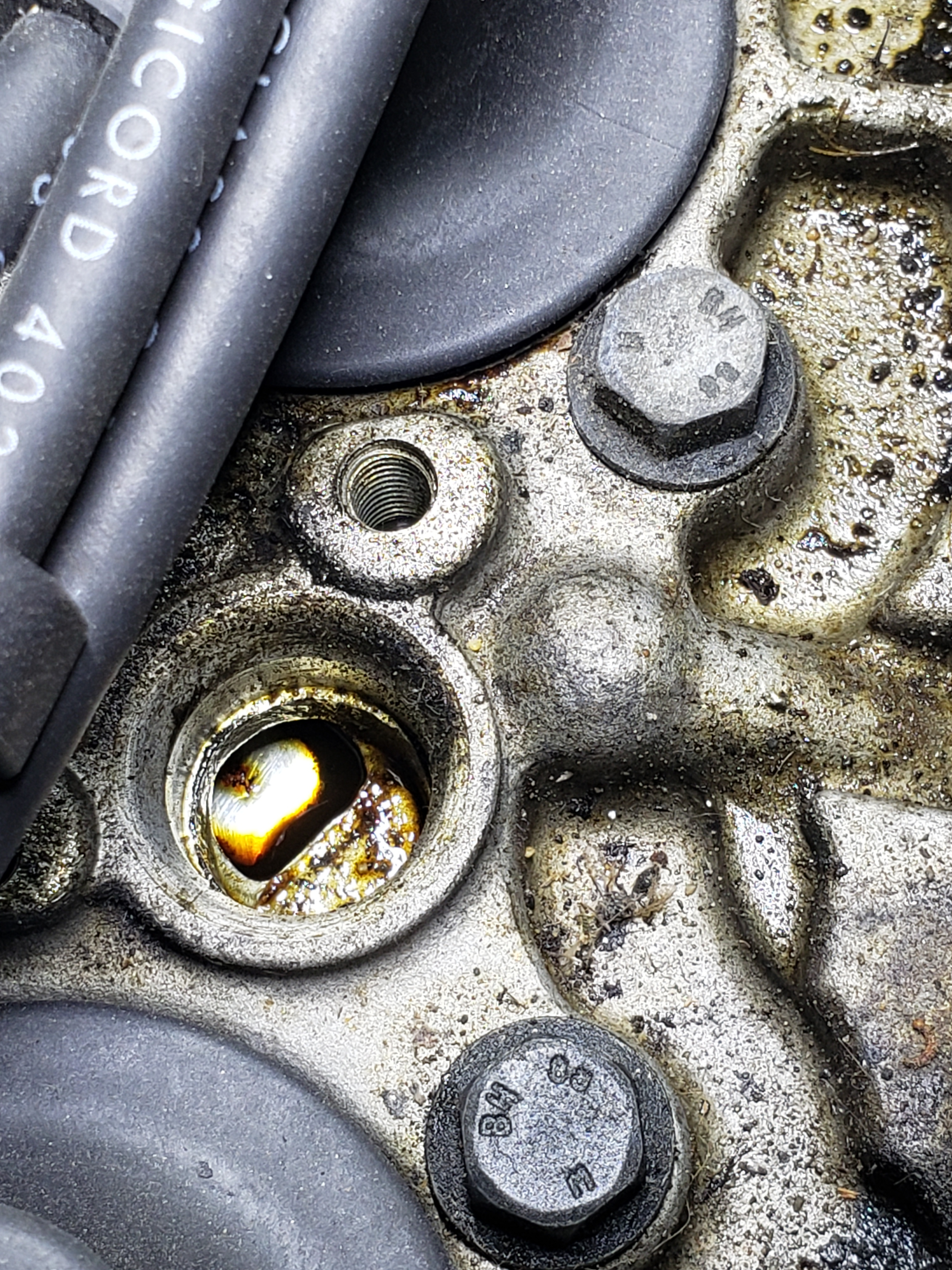

Post by ZionXIX »
My 850 turbo has it too. Didnt even know.
I tried to probe it with a zip tie but it goes nowhere. My engine gives off a lot of crankcase pressure and I've never seen anything come out of there.

Thanks for the close up picture. That’s exactly how mine looks except more oil. That hole is just plain weird! Haha.
Looks like there’s a little oil in there but if you have crankcase pressure it’s probably coming through the PCV hose.
