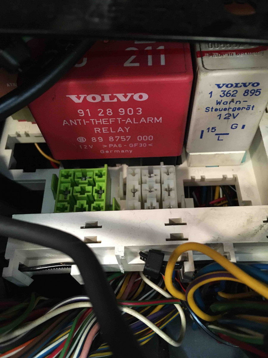

Here's a pix of my relays "board". Can some one tells me to what correspond the 2 empty spaces ?
If I unplug the anti-theft alarm relay, will it just cut off the alarm, will the car still function normally or will it be immobilized ?

I don't know what goes to the empty space, I think it is used or not used depending on if you have a manual or AT car. Not sure about that, though.
What I can tell you though is that you will have to jumper 2 ports of the 210/211 relay, or you won't be able to start it. If you can't find the correct ports shoot me a pm and I will liok it up in my car.
