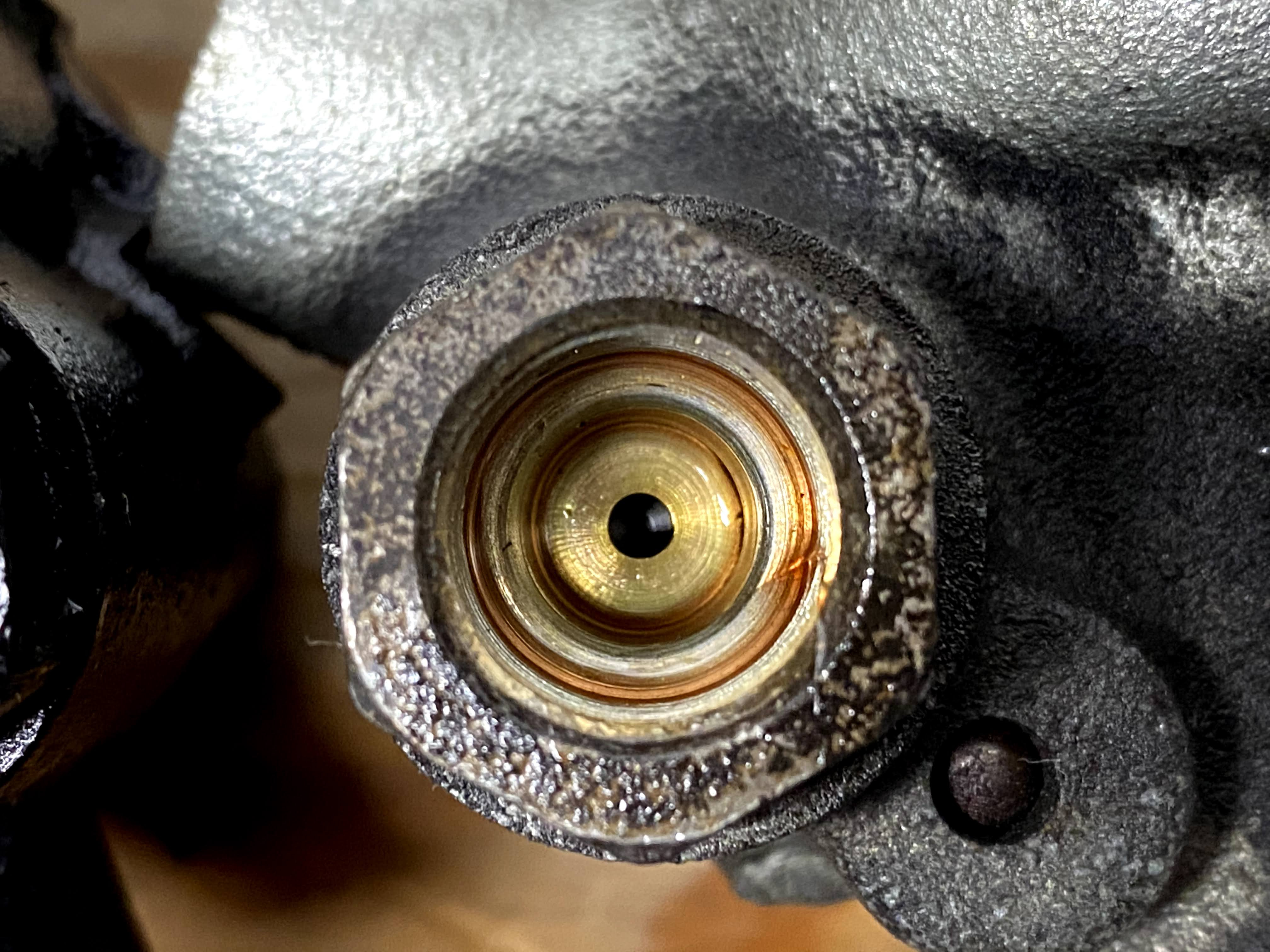

A small report on the pump replacement, which went quite smoothly. I'd give it a 3/10 on the difficulty scale, mostly because there's a couple annoying bolts and special tools required. I used a 3 jaw puller to remove the power steering pulley, and the reinstalling tool from this rental tool - https://www.canadiantire.ca/en/pdp/oem- ... p.html#srp to put the pulley on the new pump.
First impressions on the AC Delco pump - it's clearly an OEM Volvo part which has been plastidipped black, quite poorly as you can see how it started peeling when I removed the sticker to check the part number cast on the pump. No primer or anything, just black plastidip type paint straight onto the dirty part. No biggie, I peeled it off and it looks just like my original pump. There were a couple quality issues that I noticed, which was the lack of an o-ring for the reservoir attachment point, requiring re-using my original pump's o-ring. And a generally dirty-appearing fitting for the reservoir - you can see how my original pump is nice and clean and brassy, the reman pump has particles in the ATF still. I cleaned it out and while it's probably just fine, if I were someone who didn't give the pump a once-over, it could cause issues, especially installing the reservoir without the o-ring.
Final cost: $121 for the pump shipped from RockAuto - I can get $33 back for returning the core, but I pay shipping. And $7.50 for a quart of ATF.
About 2 hours of labour working on the car, and about an hour and a half with the pump out of the car once I had the right tools to remove the pulley
I've only driven about a dozen km so far, and the steering feels fantastic, buttery smooth once again. At this point I'm happy with the purchase! I'm going on a 1600km road trip this weekend, so I'll report back next week...

Original pump high pressure fitting
Reman pump high pressure fitting before cleaning
