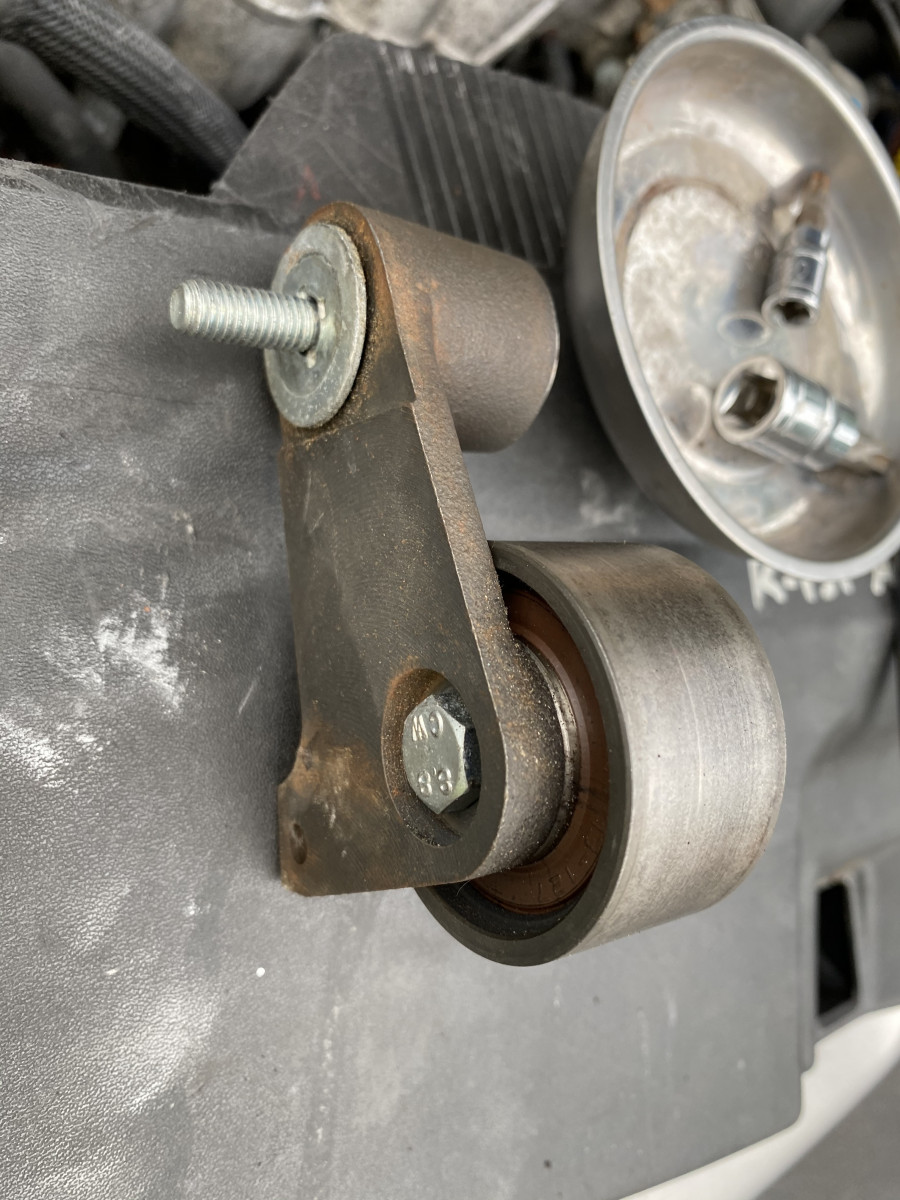

P80 hydraulic tensioner detail 9135036

Engine is in. Very little room to fit the fastener.
Picture was from one of engines in the garden out front

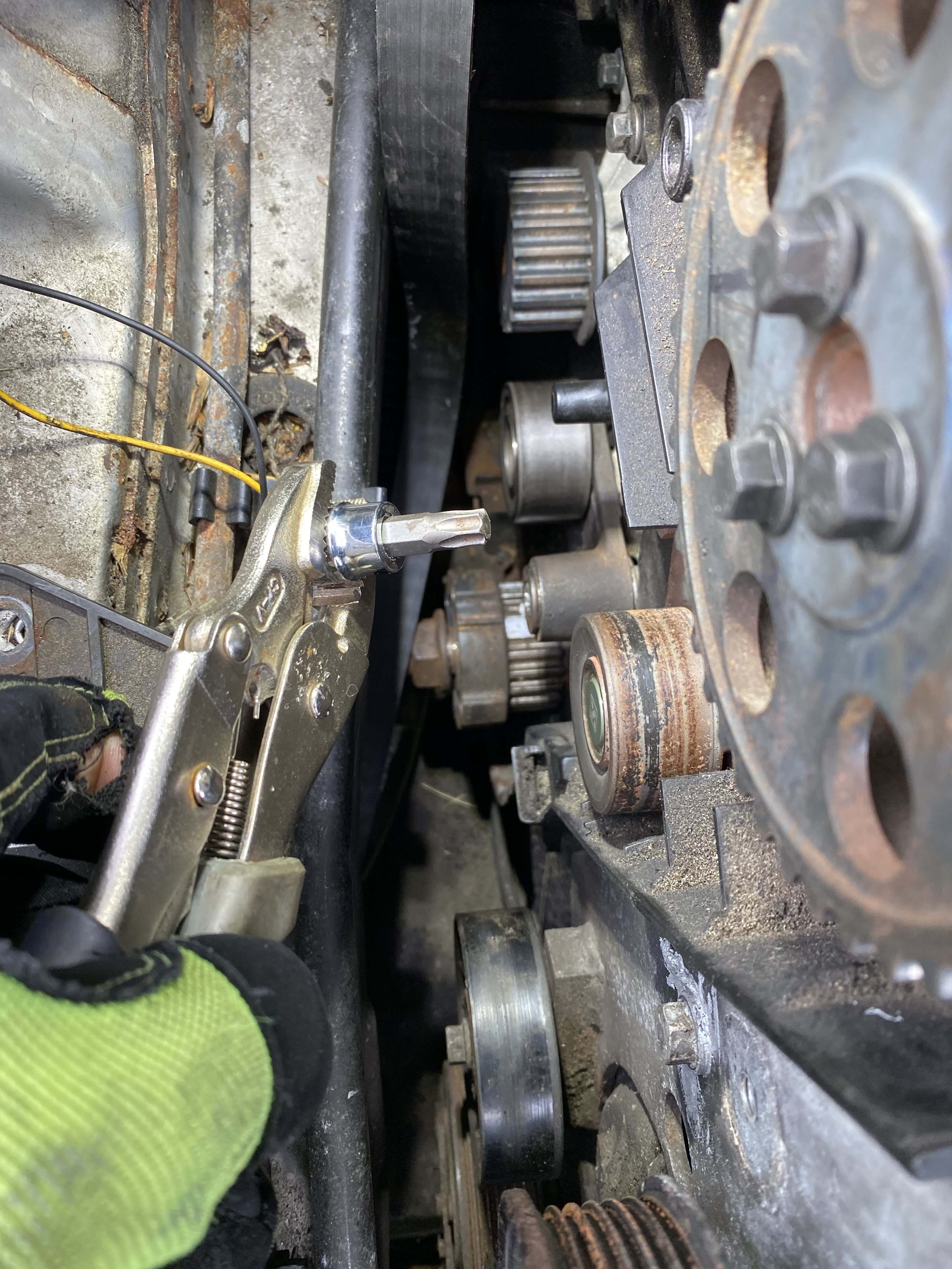

The lisle 27740 t45 is the right tool to release that tight clearance torxon the tensioner
I adapted, improvised, overcame
My longer torx would not clear the bolt for removal so I turned the threads with needle nose pliers, ugh

By the way, I fought installing the belt for 39 minutes trying to install on tensioner last.
When I switched to idler last it took 39 seconds.
I turned engine over twice to tension and confirm alignment before pulling the pin

I bought my T45 stubby at Harbor Freight. I used it with a 3/8" thin profile Craftsman ratchet and it worked well. However, I looked on HF's site and can no longer find it. It was a T40, T45, T50 set I believe. I wanna say it was classified as a torx brake kit or something.
The total width of the ratchet + torx bit is 53.2mm
I too fought the belt. I think in the end, I said screw it, got my impact and took off the crank pulley. Took like 10 secs!

It’s rare that the L shaped torx key won’t get them out. Glad you got it done
- Posts: 36149
- Been thanked: 4068 times
I had ordered an L shaped Torx and also ordered the Lisle bits as I will be doing another 1998’in VT soon
You can’t get as much slack in the Hydraulic tension As you can in the mechanical, it sure was nice slipping it over the idler in a few seconds
