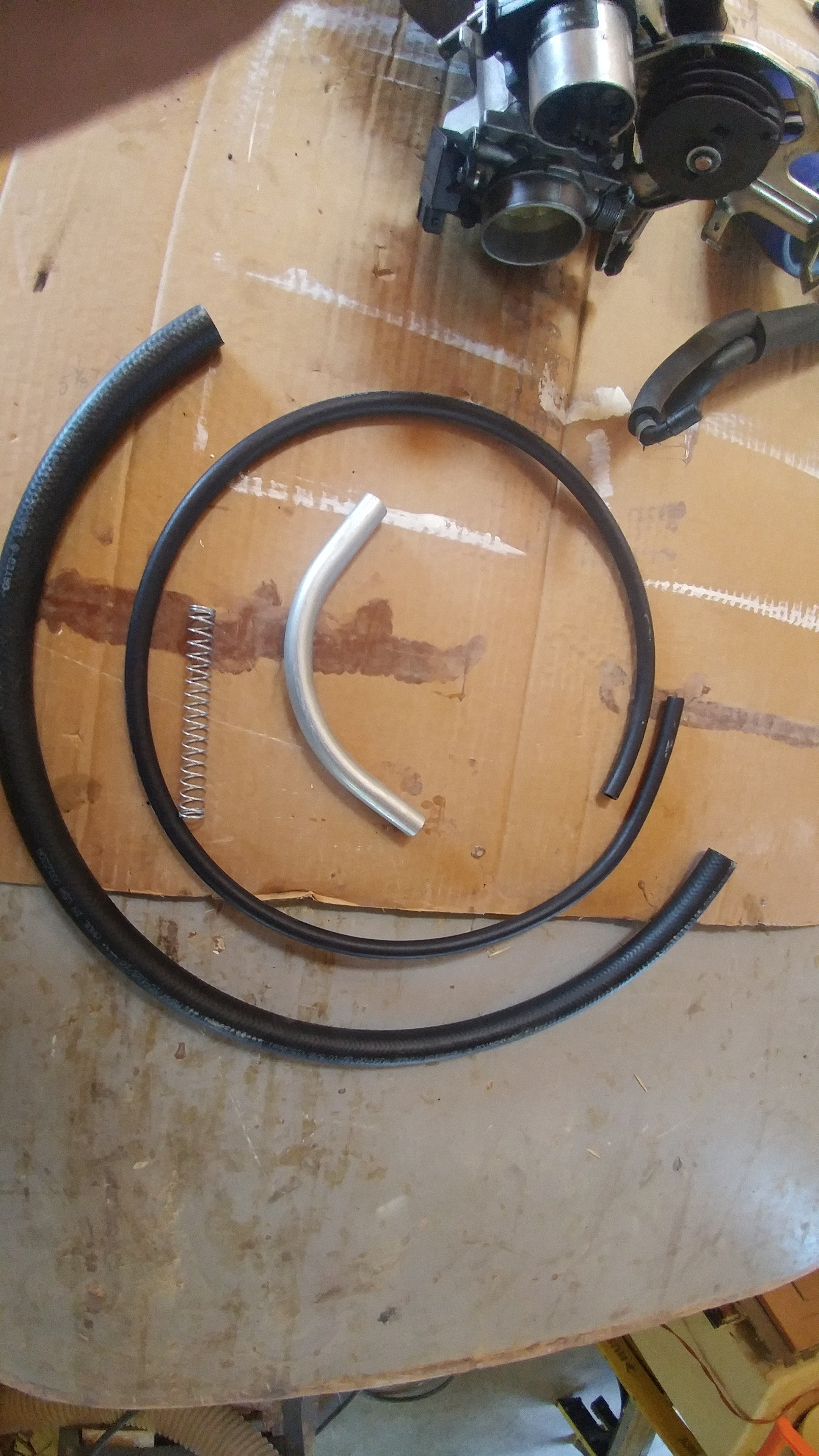

Did the PCV upgrade and it helped with the pressure.
I used ZionXlX's internal spring idea, but incorporated a EMT sweep for the 90*
3ft of the oil resistant 5/8" hose ( from a heavy equipment parts store )
4ft of the same in 1/4"
A relatively light compression spring
1/2" EMT sweep
$ 20 and change.
