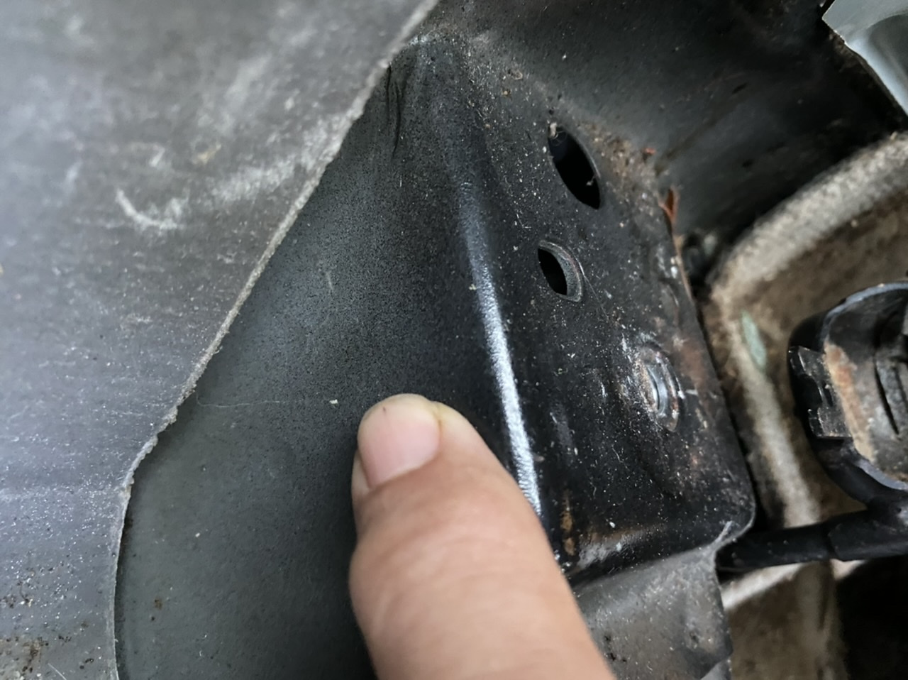

I’ve got my 1998 she’ll in the driveway and will take a picture of what you are looking at.
Sounds ugly. I think you can sneak a vice grip onto that nut, but not positive
Plan b, grind off top of the M10 bolt. Ugh.
Good news is you have to do that for safety reasons anyhow. Seats need to be firmly bolted in

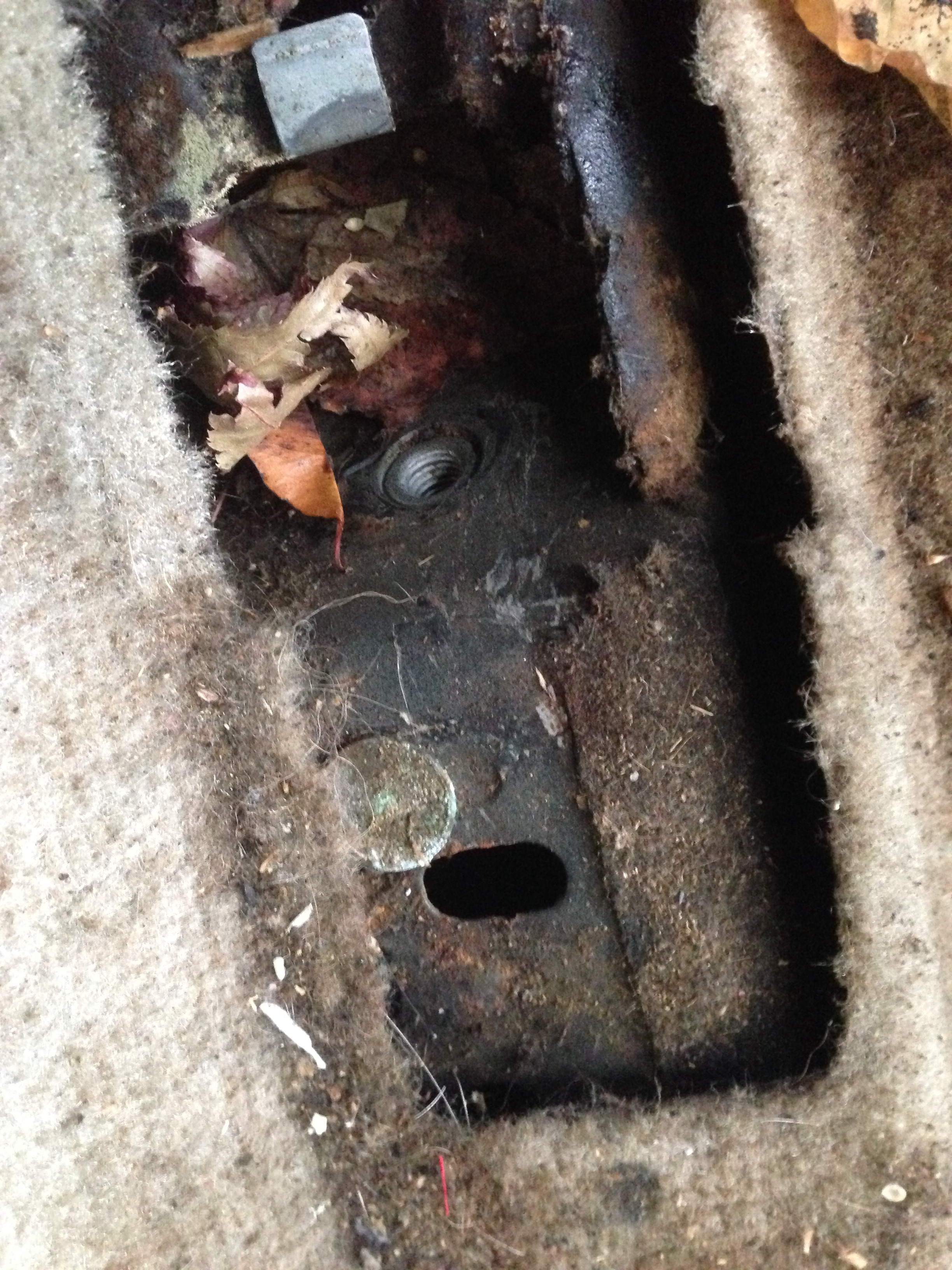

Yes, same thing happend to me, with the nut nearer to the passenger side.
Only solution was to cut a flap in the carpet and drill a hole (I used 2 holes side by side) into the metal so I could put something through to hold the nut. Also a lot of fun when reinstalling... It really sucks, but can be done.
When you bend the carpet flap back in place it is not visible.
I have had this issue on a few nuts already... they seem to be pressed into the chassis, but have come lose over the years... not the best Idea volvo had there.

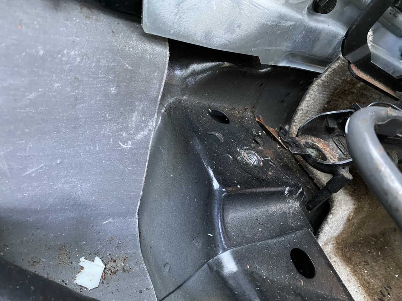

I’ll load those pictures this morning, sorry
Crap that box is built to last. Looks like front cut and weld back

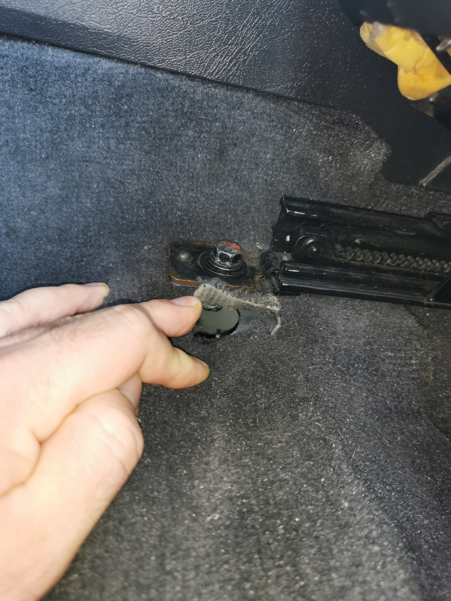

I think I remember taking it off I got off easy with wedging a screwdriver in there to get it under tension and using an impact gun to get it out. Don't remember exactly.
Took a quick pic; maybe there are better ways to do it.

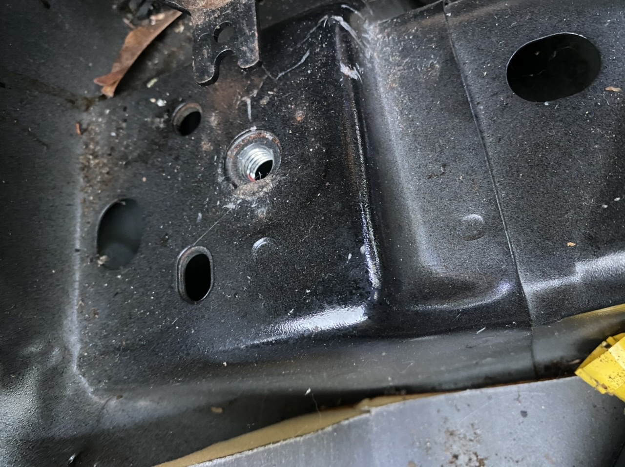

I’ll take a picture of the back right on my parts v70, 1998 so you can see the detail. Carpet is out
Well , it's ugly. It's in a metal box , I think I would just grind the heAd off the bolt

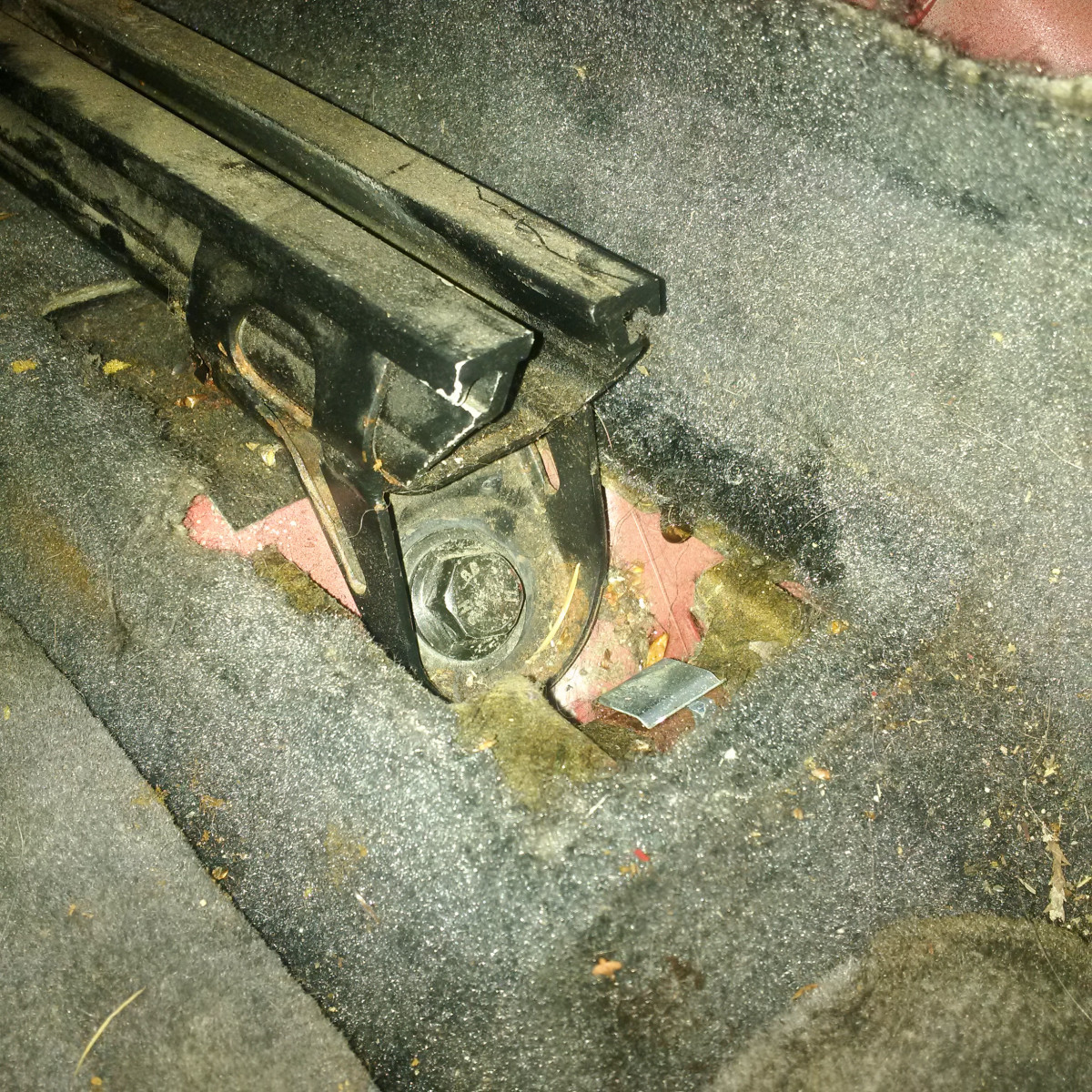

Hello Everyone,
Thanks for the replies... I attach a photo of the offending spinning bolt... As you can see it's well-protected
by some flanges on the seat base and the runner above. Getting a grinder on it is impossible. Any suggestions for
other types of cutting devices to get the head off the 8.8 grade bolt? Die grinder? I'm always happy to buy another
tool(s)...
Cheers, John.
tool(s)...
Cheers, John.

You could drill it out but you're gonna be there a while. Then you have figure out how to reattach the blind nut or slip a new one in there with some spot welds on it or something. I dont know what the other side looks like but I imagine if you could locate it from underneath and drill a hole just big enough for a socket to fit through, that could work. Then you would need to pain any bare metal then plug the hole. Just a thought, haven't had this problem yet.
- Posts: 36172
- Has thanked: 1613 times
- Been thanked: 4078 times
Drill it out and push a bolt through, then lock nut on the outside.
A Dremel tool can probably get in there, or you need to cut the frame and then reweld it when done
