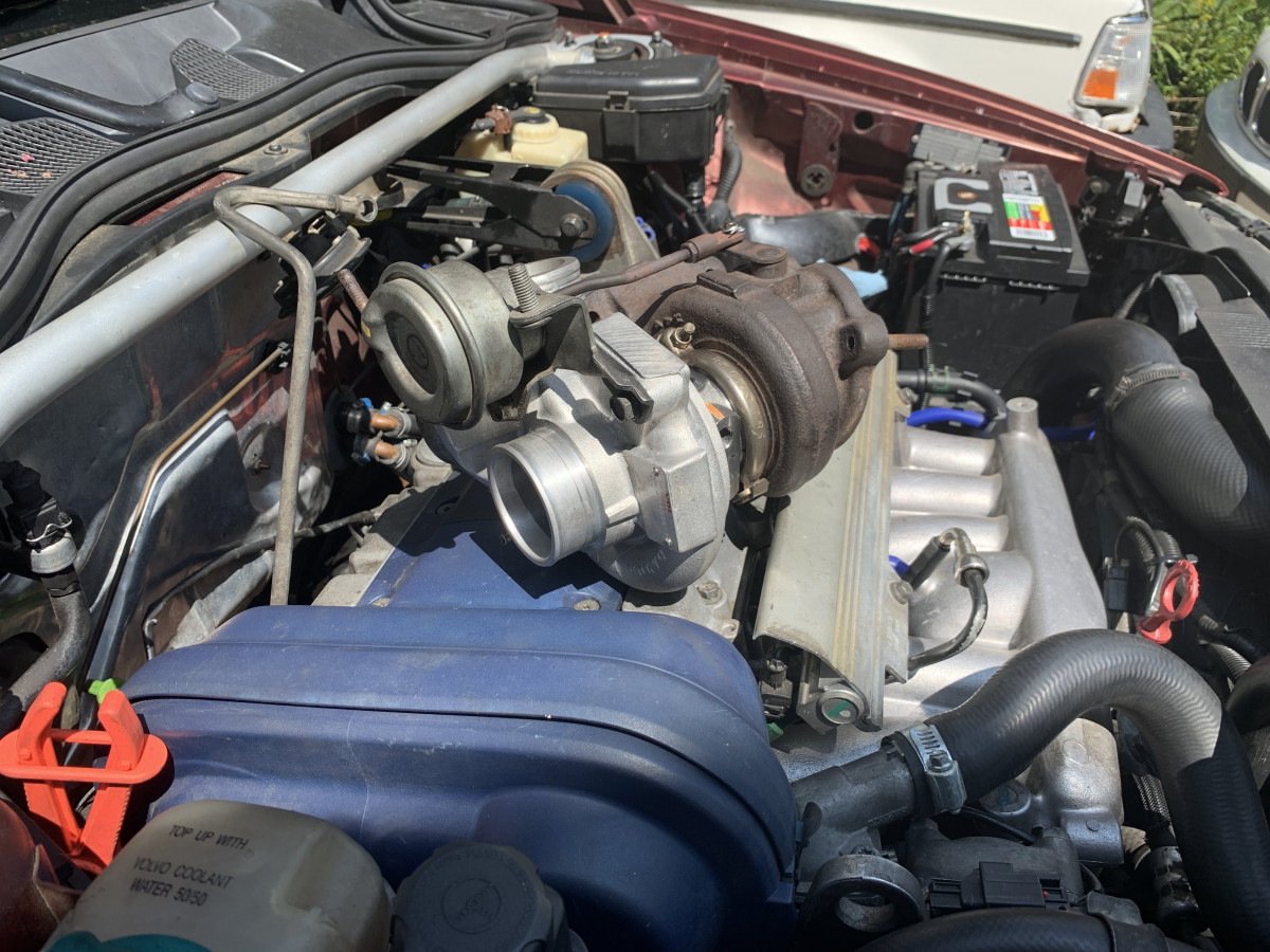

The turbo is back in the car with a new CHRA... and the problems persist. Still have that annoying whine and the boost still acts weird. I'm down to a clogged cat on the boost issue... I have NO idea what else it could be. It boosts to around 12 PSI, backs off to 10, then eventually builds back up to 15 PSI where it should be. Really weird.
Anyway, the Japanifold added a nice sound to it in the high revs, so that's nice! Definitely worth the upgrade while I was in there, especially considering the flow increase.
On a positive note, if anyone needs a new turbo, turborebuild.co.uk was a great choice! $185 for a brand new VSR balanced 19t CHRA with 2 day shipping from the UK. Not bad! It even came with all the washers and the drain gasket. They also offer upgrades and upgrade parts. I was considering a billet compressor wheel, but I decided to hold off since I'm still planning on going with a K24 eventually.

Sounds like a collapsing hose or old/torn/leaking CBV.bmdubya1198 wrote: ↑12 Sep 2020, 08:32 The turbo is back in the car with a new CHRA... and the problems persist. Still have that annoying whine and the boost still acts weird. I'm down to a clogged cat on the boost issue... I have NO idea what else it could be. It boosts to around 12 PSI, backs off to 10, then eventually builds back up to 15 PSI where it should be. Really weird.
I've got a Japanifold hanging on the wall in my garage. Hint to myself.

Happen to replace the turbo control valve? My guess is the pressure may be getting high enough to push through it. If it isn't the CBV or a hose, my guess would be this... (Assuming the ECU isn't causing the issue intentionally)bmdubya1198 wrote: ↑12 Sep 2020, 08:32 The turbo is back in the car with a new CHRA... and the problems persist. Still have that annoying whine and the boost still acts weird. I'm down to a clogged cat on the boost issue... I have NO idea what else it could be. It boosts to around 12 PSI, backs off to 10, then eventually builds back up to 15 PSI where it should be. Really weird.
