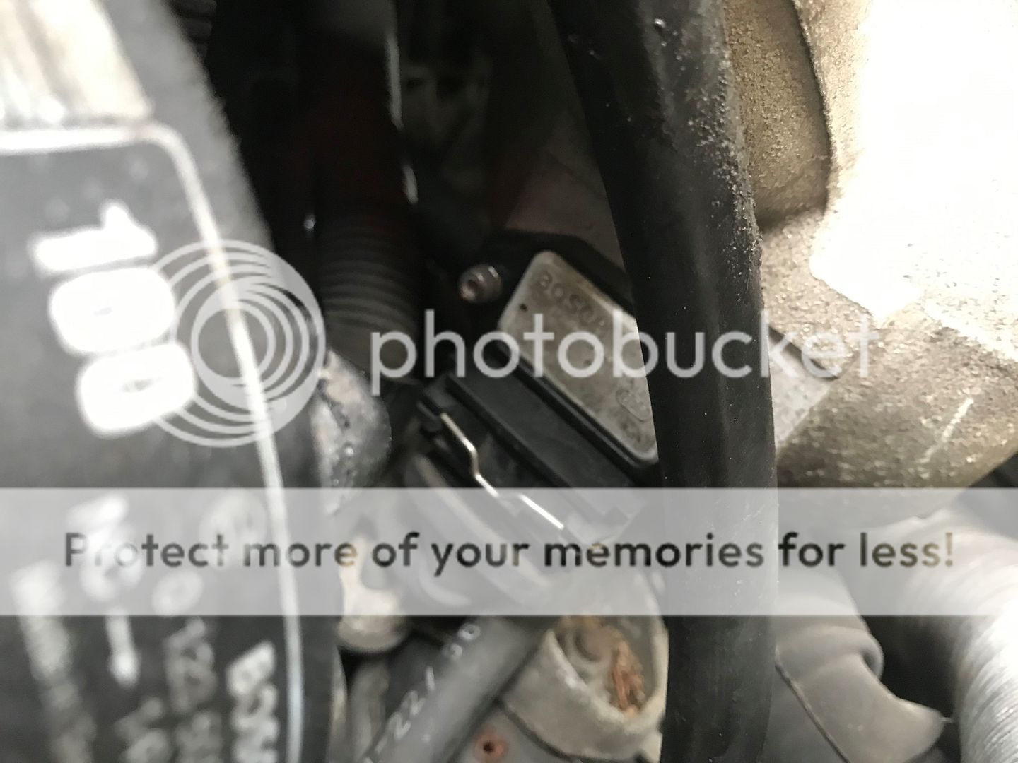

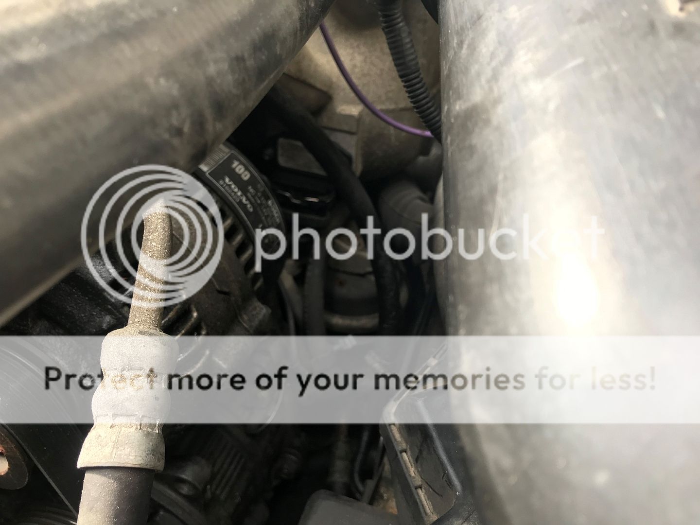

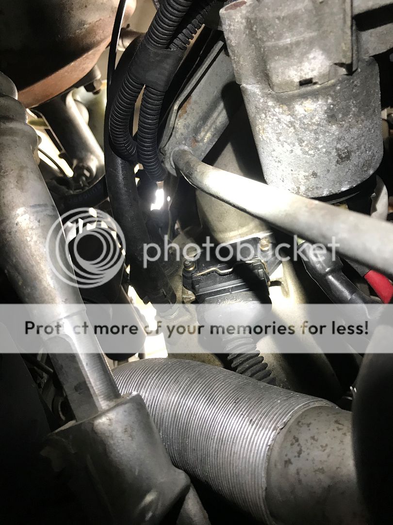

First two pictures are of the odd 1,3,5, right behind the alternator facing the front of the car, the last picture is the even 2,4,6. which is directly on the other side of the other, i took the picture from underneath my 1997 960.
