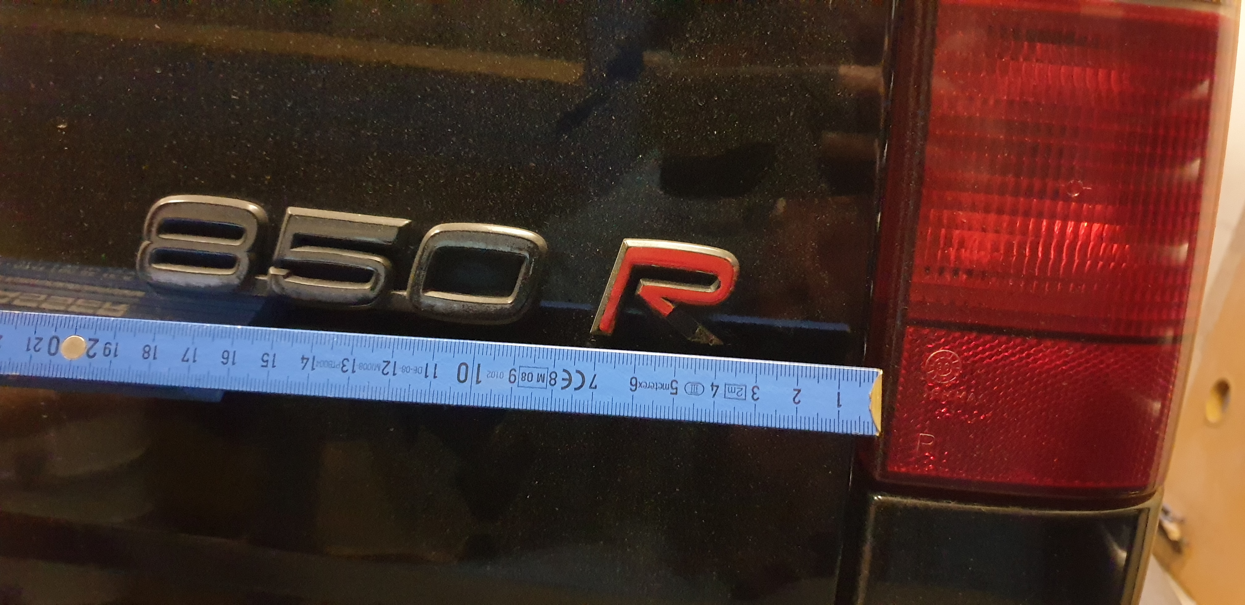

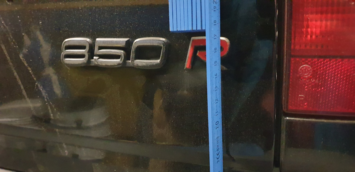

I am also after some genuine Volvo badges, specifically "Volvo", "850 R" for the rear, and "R" for the front grille. Same story, willing to pay any price anywhere in the world. Are there any articles or info on the exact placement of these badges? Mine were missing from my wagon when I bought it a few months ago, the badges would complete the look.

For the badge:
https://www.skandix.de/de/fahrzeug-teil ... r/1032792/
They also have an english version if their website, and they also have the 850 Emblem in stock. Du no if they ship down under, but I'd guess. But your dealer should habe them or get them from Volvo classic parts in Sweden.
The R badge up front was not a factory option for the 850Rs as far as I know. People just put them there.
