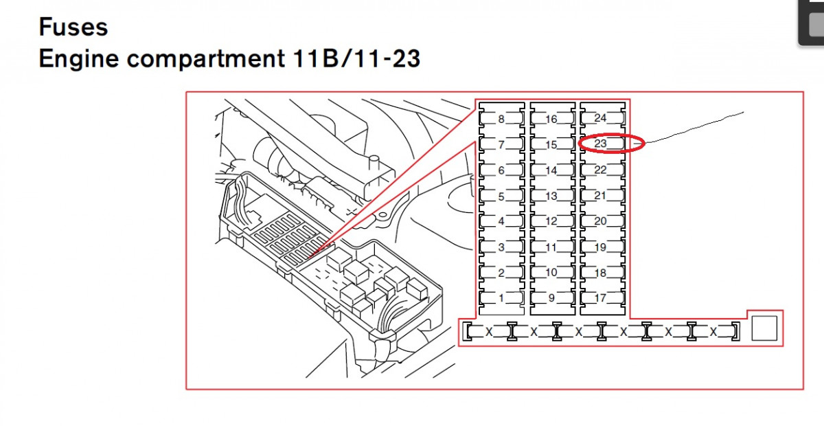

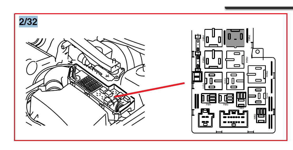

Based on the 2002 wiring diagram I have check fuse 11B/23, which supplies power to the main engine relay. Have you measured if there's voltage to the FMA2 main engine relay?
2_32 FMA2 relay.jpg (128.82 KiB) Viewed 2440 times

1 will check the fuse but which one is 11b/23 the fuses in the box are numbered. but there does appear to be power to one of the terminals pf the main relay I will look and check the other fuses in the block but if they seem just ot labeled numerically I believe thanks steve

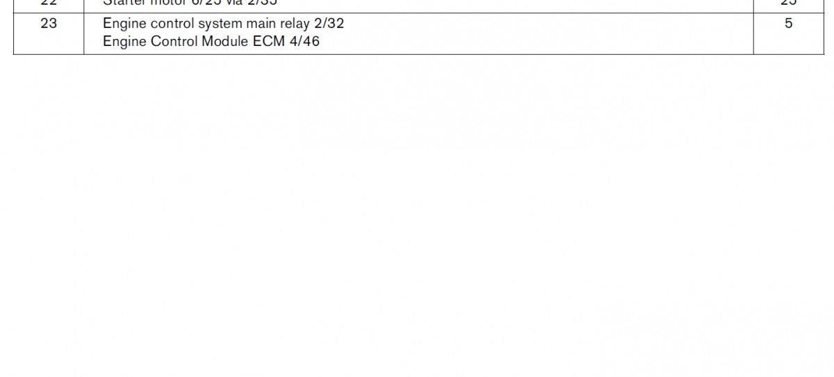

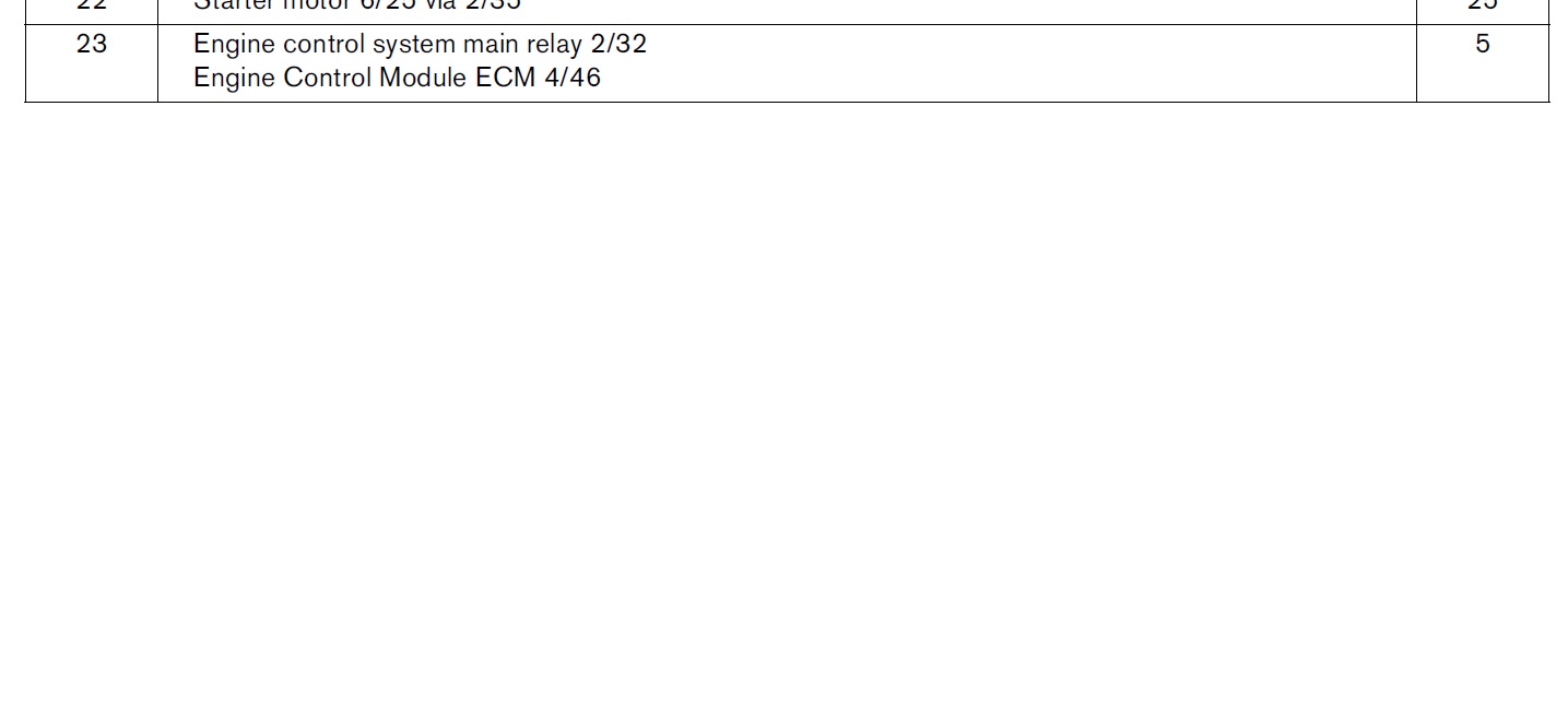

Post by firstv70volvo »
spineda wrote: 04 Dec 2020, 11:34 1 will check the fuse but which one is 11b/23 the fuses in the box are numbered. but there does appear to be power to one of the terminals pf the main relay I will look and check the other fuses in the block but if they seem just ot labeled numerically I believe thanks steve
See attachments, it's a 5A fuse.
