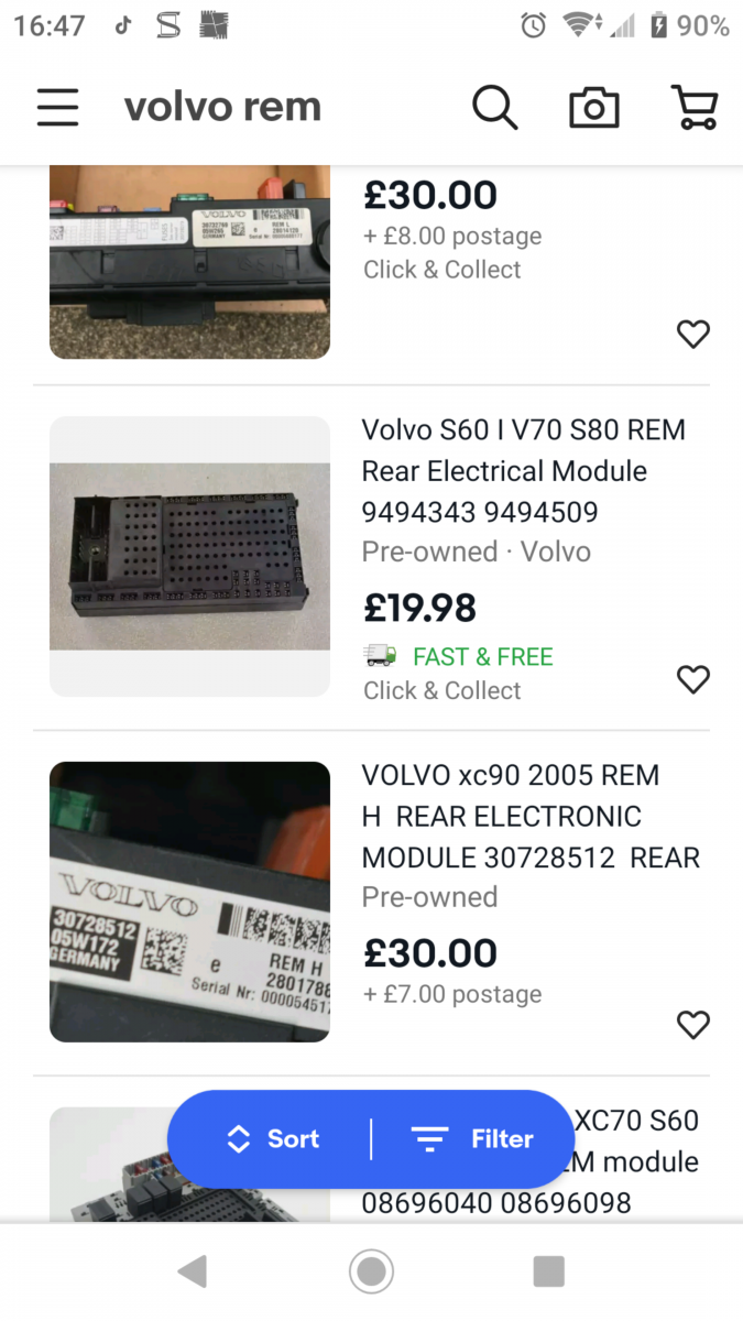

Been looking on ebay too a used rem for £20 it's minus the fuse section and has no shunts or relays... Does the middle of the unit (the circuit board ) just unclip?

Yes, the center section unclips and slides out. All the relays and shunts need to be removed first and it would be a good idea to to label and take a picture before removing everything. Still don't know about the compatibility of the software though.ashleyg82v702001 wrote: ↑15 Dec 2020, 09:48 Been looking on ebay too a used rem for £20 it's minus the fuse section and has no shunts or relays... Does the middle of the unit (the circuit board Screenshot_20201215-164717.png ) just unclip?

Oh OK, for the sake of £20 I might try it. I'll match the part numbers and have a lookski to see if it's like the door modules with a software code sticker.
