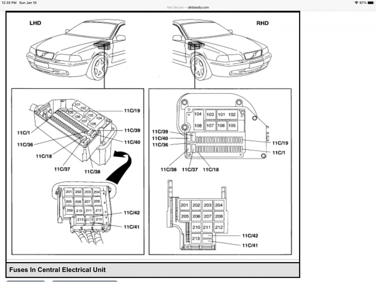

Location of fuses
11A and 11B reside under the kidney shaped fuse cover attached to the strut tower
11C is under the flip cover near the dashboard cowl

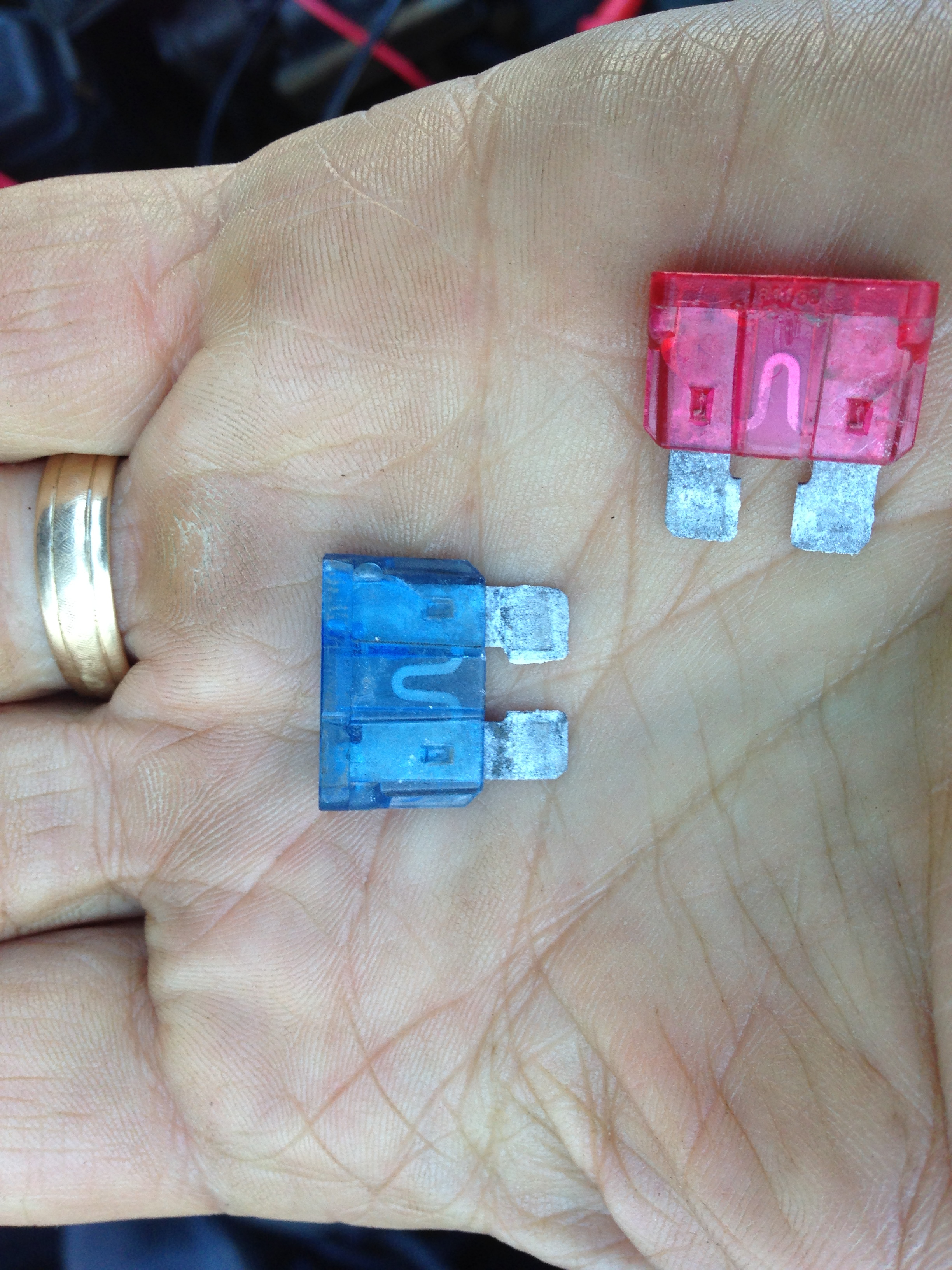

So I finally hit this up today with some great help - because you can't play with the lights while using a multimeter.
In my reseating of fuses I ended up with no turn signals or hazard lights. Not good...
Big problem source -- corrosion in the fuse box. Both the fuses and the terminals were rather bad. Some of that was able to be wire brushed off with a dremel. Then one low beam light blew -- H7. Replaced it. All good. May polish the glass on the the outer lens in the near future. May also try spraying the reflectors with chrome paint this spring and see it that helps them along.
