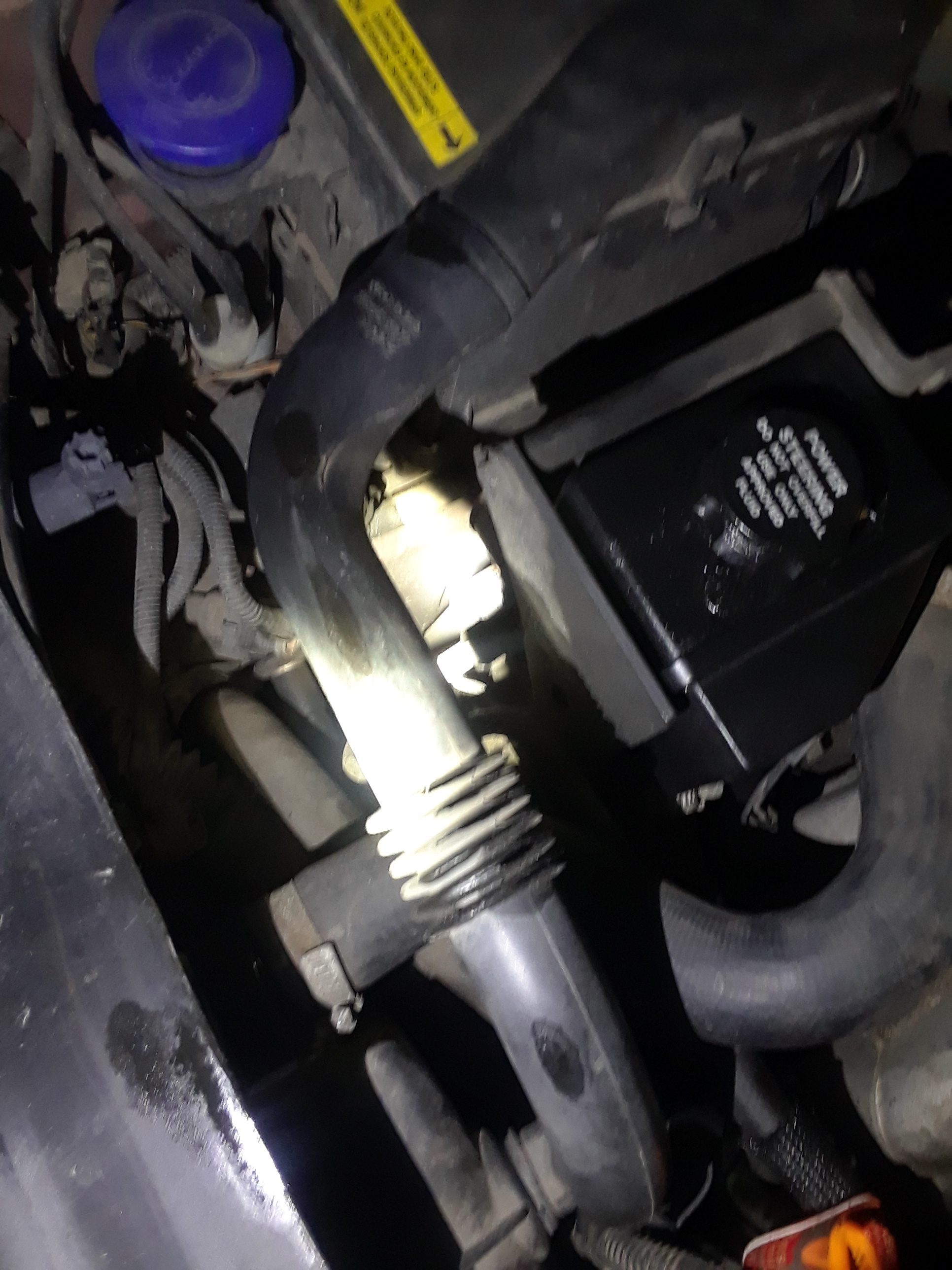

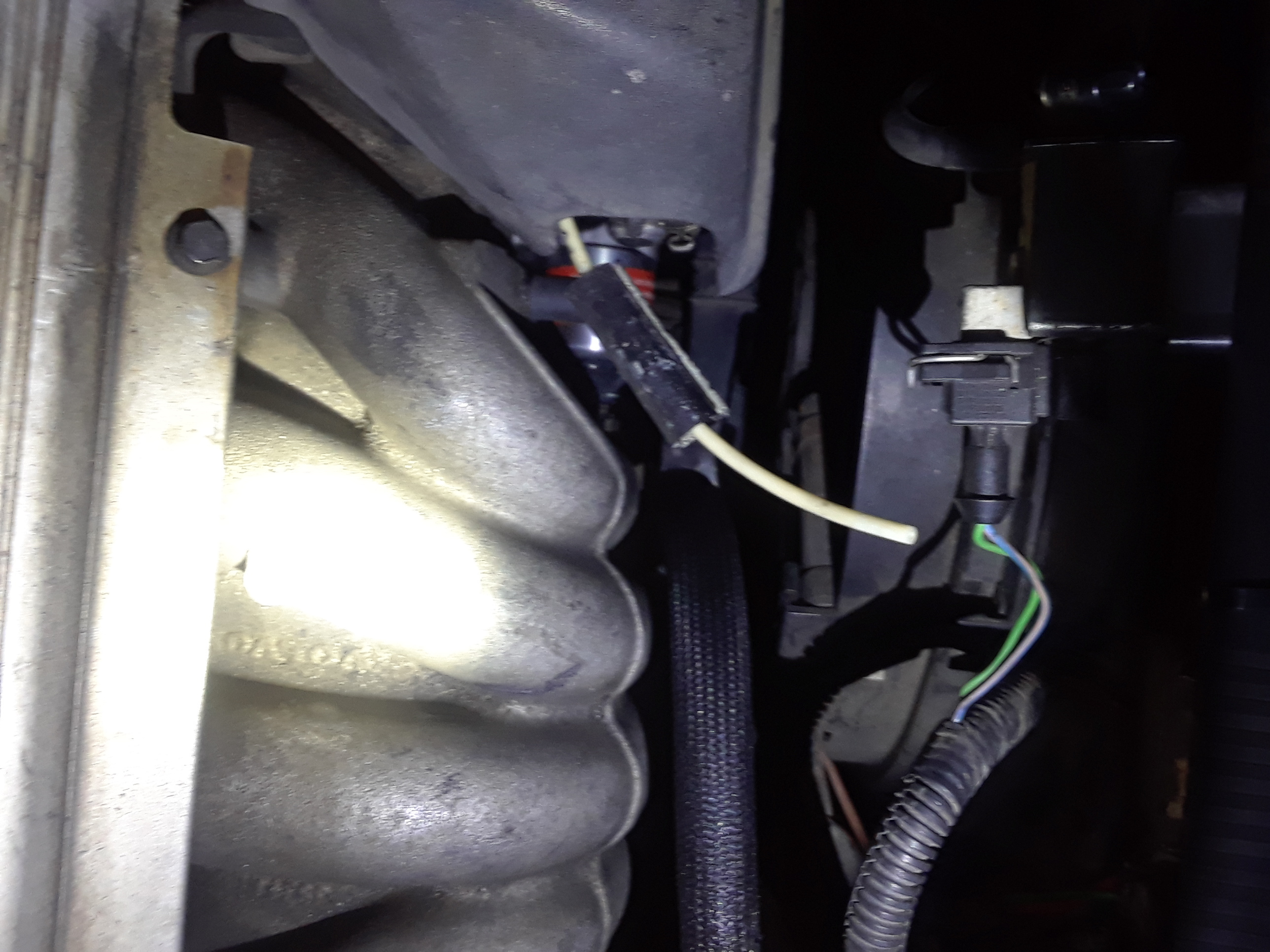

So I thought my flashing transmission arrow issue was fixed by replacing a small leaky hose. Now it's back to solid transmission arrow, that will often go off if I turn it off and sit for a few minutes. I still think it's an air flow issue. And I discovered this little hose (see pic) that doesn't connect to anything on one end. Any ideas where this should be? Could it cause my issues? Also my cracked hose (pictured) might be a contributing factor? As always, I apologize if these are dumb questions, I am obviously not a mechanic.
- Posts: 36149
- Been thanked: 4068 times
That’s either SAS solenoid vacuum or air door vacuum for the air cleaner. I don’t think either one will cause a transmission fault
The broken ECU housing vent, the fat elephant hose, won’t either

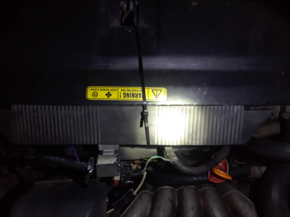

Thanks abscate! After a quick google search I think it’s the SAS solenoid vaccum. (There’s a connection for it that I remember that is now missing). I think part of my issues are that the mount of the panel above the radiator broke and it caused some things to shake loose. (Pic is after I put it back into place with zip ties).
