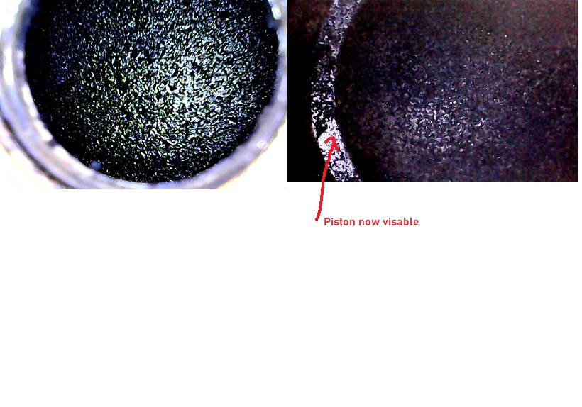

Combustion cylinder Before and after pics
- Posts: 36139
- Been thanked: 4064 times
You blow it out with compressed air and carry on. Engines arent that fragile, unless you have deviated from the path of the righteous.

Here is the before and after pic of cyl 5. I used a product called Threebond my seafoam is yet to arrive and the local parts store said this is what all the mechanics here use. Its also called subaru upper engine cleaner. After just one treatment i can see the piston ring i couldnt see before but the smooth acceleration was the real proof it actually worked. Like others have said its a good idea not to have large chunks coming off at one time, slowly slowly does the trick.

On a side-note, over 25 years ago I worked as a tech on the Lincoln/Mercury side of a dealer, the other side of the shop was BMW/Saab. Apparently Saab's also had a tendency to build up gunk in the combustion chamber so what the techs did was disconnect the wiper washer spray hose from the hood and connect it to a vacuum port on the throttle body and drive it and hit the washer spray button to clean out the combustion chamber...I know they swore by it.

Love this hack!SVO LOU wrote: 18 Feb 2021, 17:51 ... disconnect the wiper washer spray hose from the hood and connect it to a vacuum port on the throttle body and drive it and hit the washer spray button to clean out the combustion chamber...I know they swore by it.
Thoughts anyone? I feel like trying it on my beater 850 this spring.

its quite risky because the engine might hydraulically lock. Emailed a few mechanics that work on volvos over 20years old that have been driven by old lady's consider removal of the head the only real fix.

One car that was in the shop had this rattling sound and the next thing I hear is the motor being rev'd and water being poured into the carb from a used Prestone coolant bottle. They too use it for carbon buildup.

Yes, this is the whole point of speculation. The question is if water injection by this simple hack is controllable enough to minimize the risk.darrylrobert wrote: 18 Feb 2021, 20:35 its quite risky because the engine might hydraulically lock. ...
Water injection systems are common, presumably they clean up the pistons.
