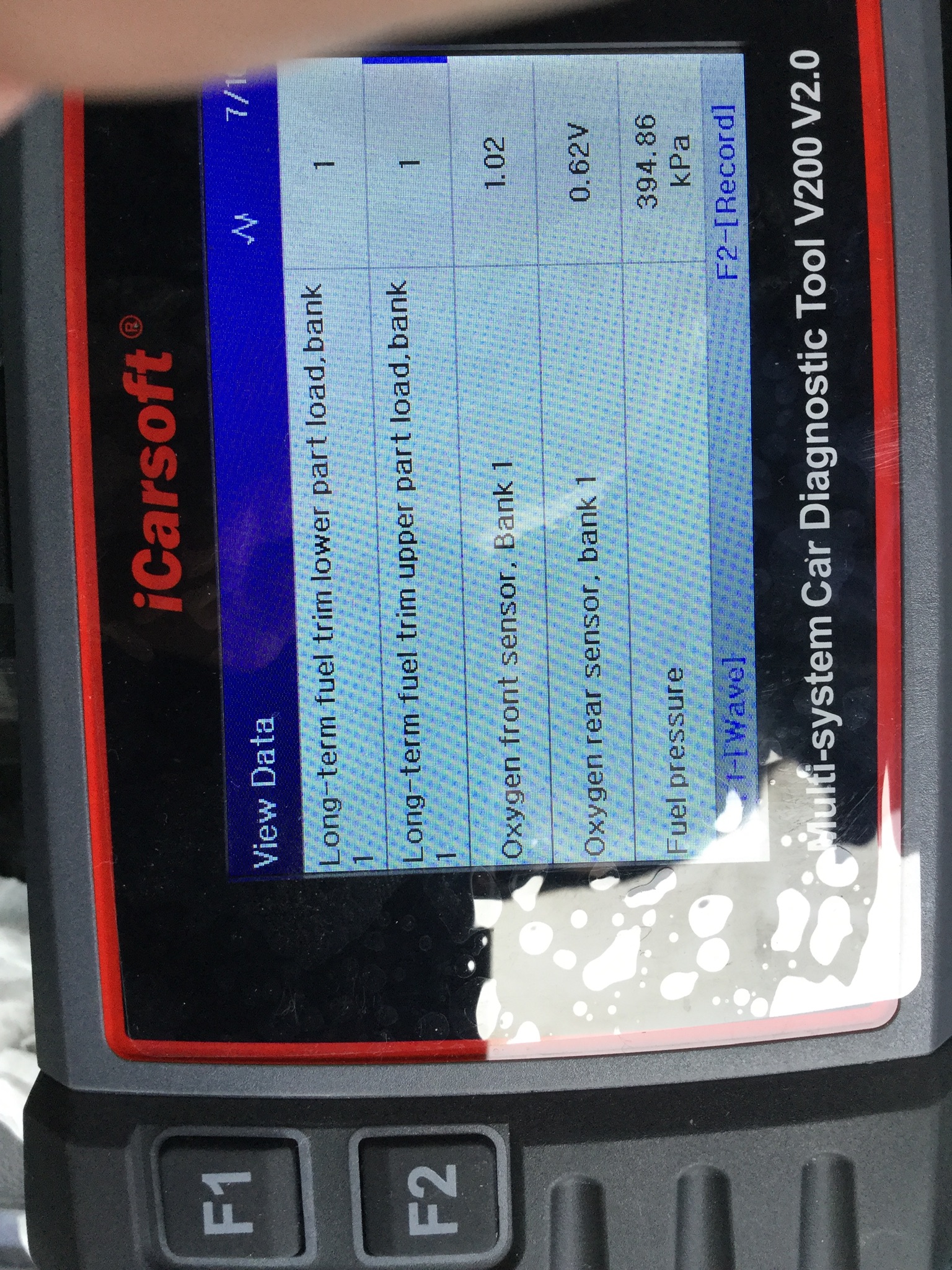

Does anyone know what the values for the Front and Rear oxygen sensors should be?
Attached a picture of the values when idling. Long term fuel levels look good, to my knowledge they should be around 1.
