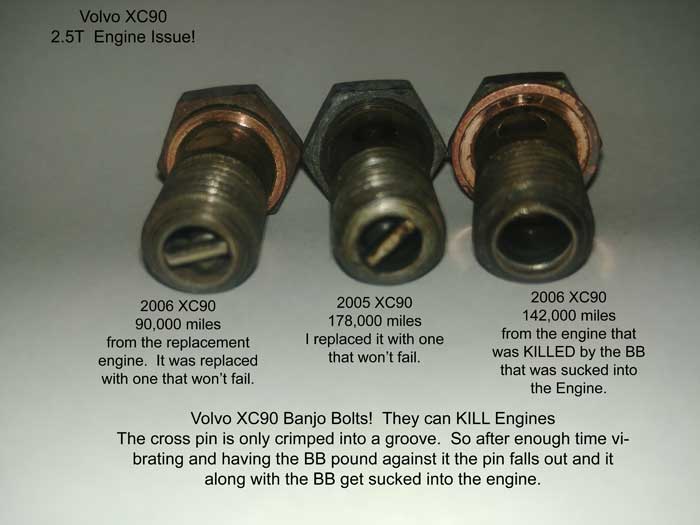

research says they fitted the faulty engine killing banjo bolts from 2005 2.5ltr, so my 2001 2.4ltr should be safe? its going to be a while until i can remove and check it.
engine killer banjo bolt

Thanks for sharing that info. I didn't know about the banjo bolt problem.

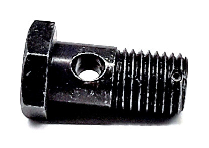

darylrobert wrote: 05 Jun 2021, 03:07 research says they fitted the faulty engine killing banjo bolts from 2005 2.5ltr, so my 2001 2.4ltr should be safe? its going to be a while until i can remove and check it.
With the latest banjo bolt design it looks like the retaining pin is held in place with a through hole crosswise in the bolt. I believe this bolt has 2014 on the head if you want(can) to check which banjo design currently installed in the manifold.

Well damn, when I did my PCV last summer, mine was the old style and all I did was clean it out w/ some carb cleaner. I already had an alternator pulley and decoupler tool in my FCP cart. I just added the new banjo bolt. I should be able to get to it okay w/ the alternator out. Pulley job just got extended.

DonnVa wrote: 05 Jun 2021, 16:01 Well damn, when I did my PCV last summer, mine was the old style and all I did was clean it out w/ some carb cleaner. I already had an alternator pulley and decoupler tool in my FCP cart. I just added the new banjo bolt. I should be able to get to it okay w/ the alternator out. Pulley job just got extended.
Good for you.. I wish I would've known about the stupid bolt back when I replaced my PCV parts years ago..
