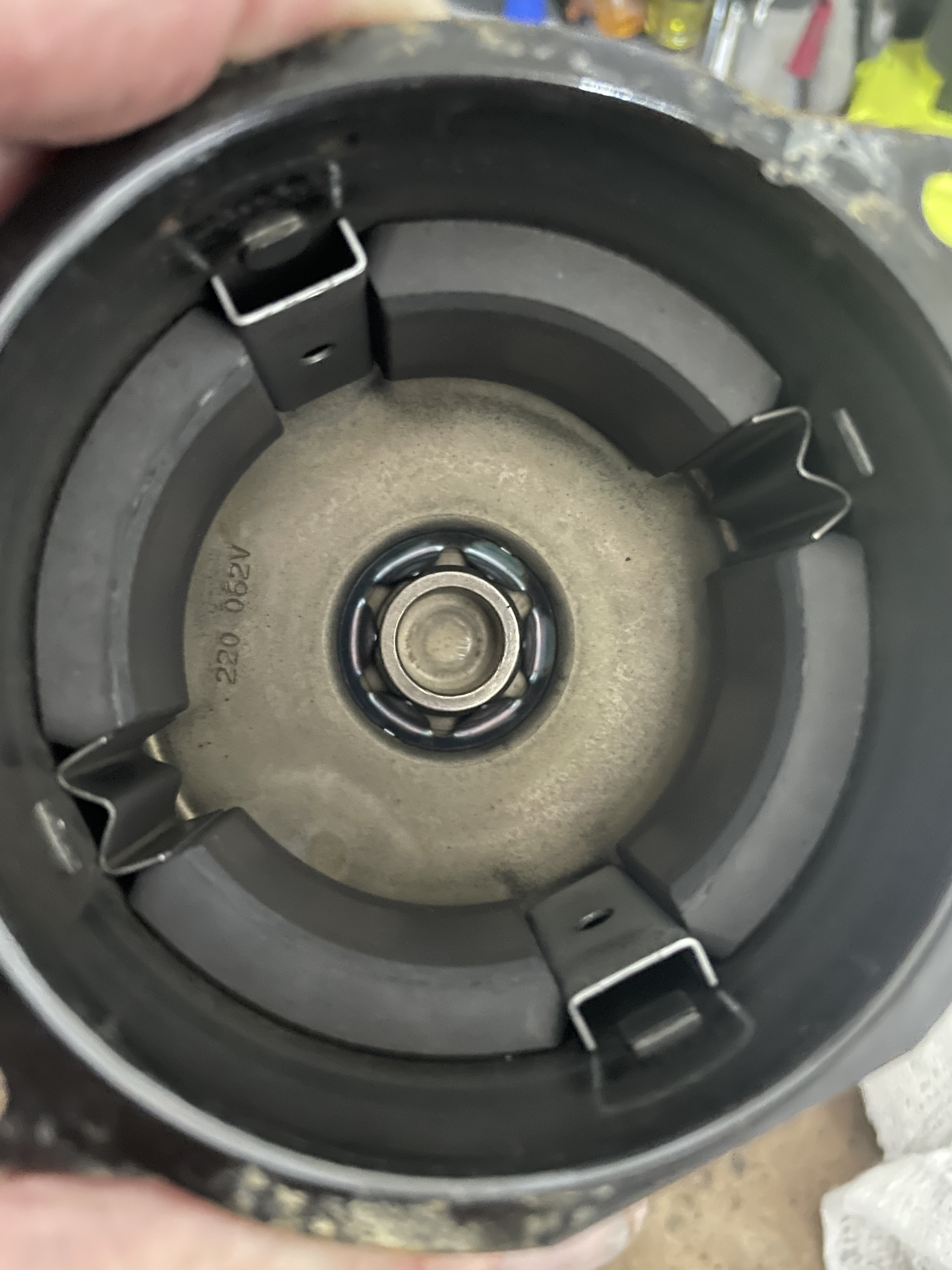

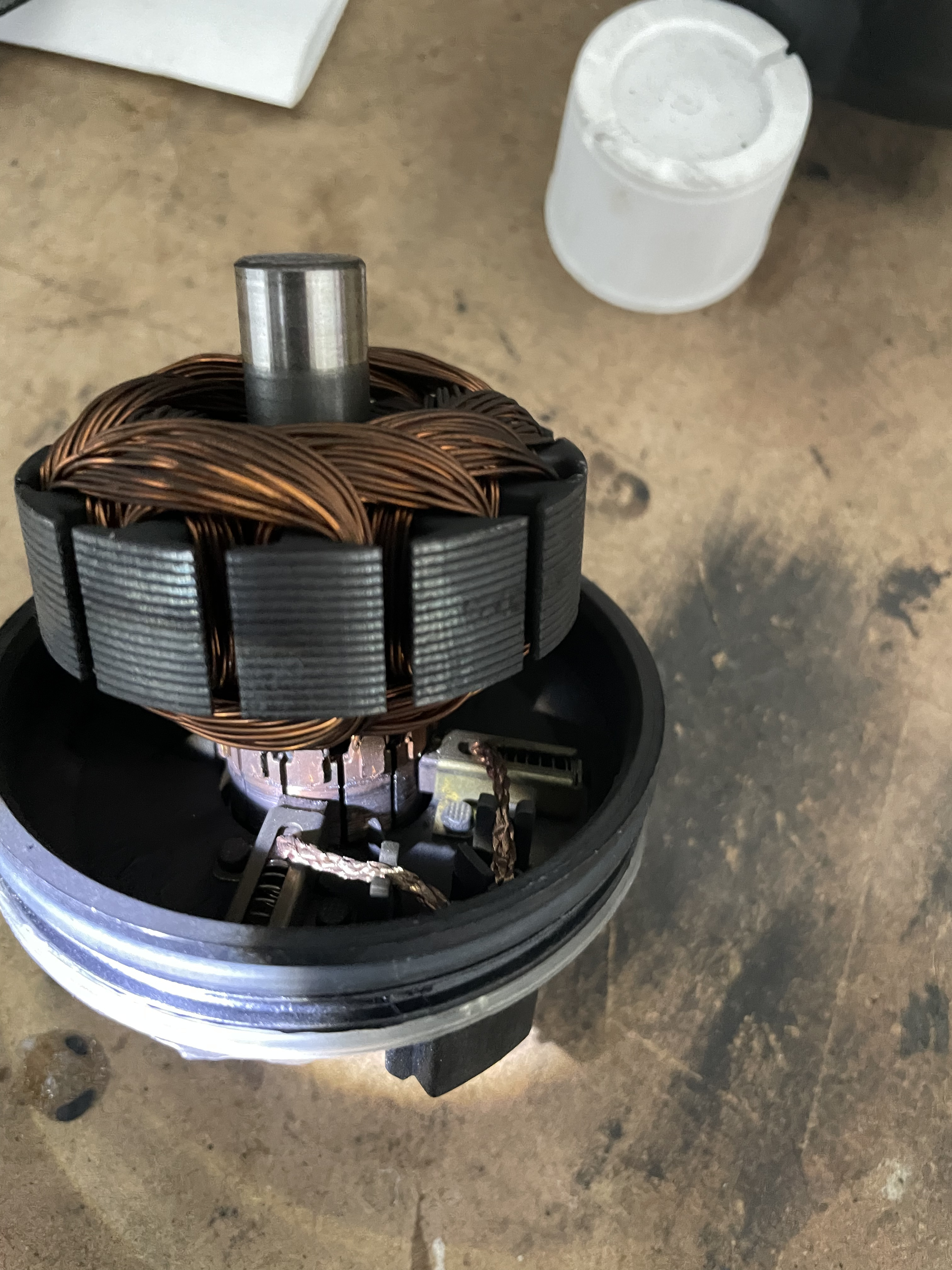

Thanks for the info in this thread. I started getting a BCM-0070 this weekend after the car got hot, but only upon starting again after parking for a few minutes. No other errors. I pulled an ABS pump from a 06 S60 on the way home today and swapped it out with the goal of taking mine apart to take a peek in it and see about replacing the brushes. Well when I pulled mine off it came apart with the little bearing too. I used the YouTube video by XeMODeX to angle the little bearing back into place after cleaning and greasing it. Here are some pictures of the inside of the pump in case they haven’t been posted before..

Nice! Did you replace the brushes? What do you think set of the ABS error? What did you clean/re-grease?

I just swapped out the motor at this point and took it on a few test runs. It’s cleared my error for the time being. I’ve got to source the brushes. They look to be 5mm x 5mm square. Not sure of the depth yet. I also want to source the bearing at the bottom. The top in the cap, as you can see is not a bearing. So when I can get those and clean up the copper I’ll put it back together and wait for the error to happen again w/ the pick a part motor and do the swap.
