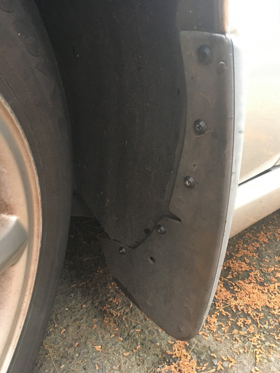

I finally reattached the left front mud guard on the Silver Bullet, which had been hanging by a single rivet at the top.

Those POM rivets are great for those. I’ve tried the cheap little auto store body clips, but they always fall out. I redid all of mine with those rivets a while back and they’re finally solid!

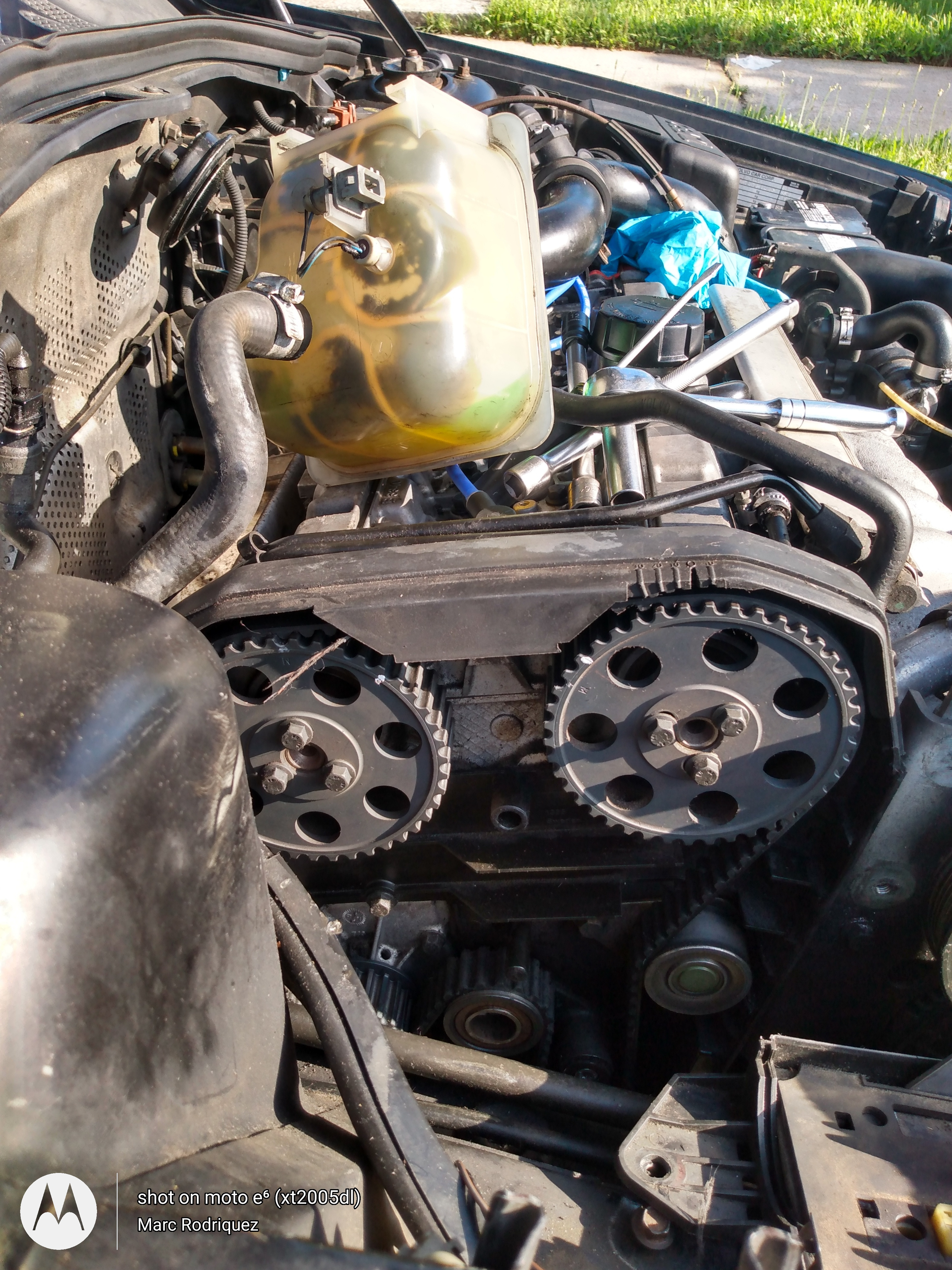

Got the timing marks lined up. Cleaning and new belt tomorrow.

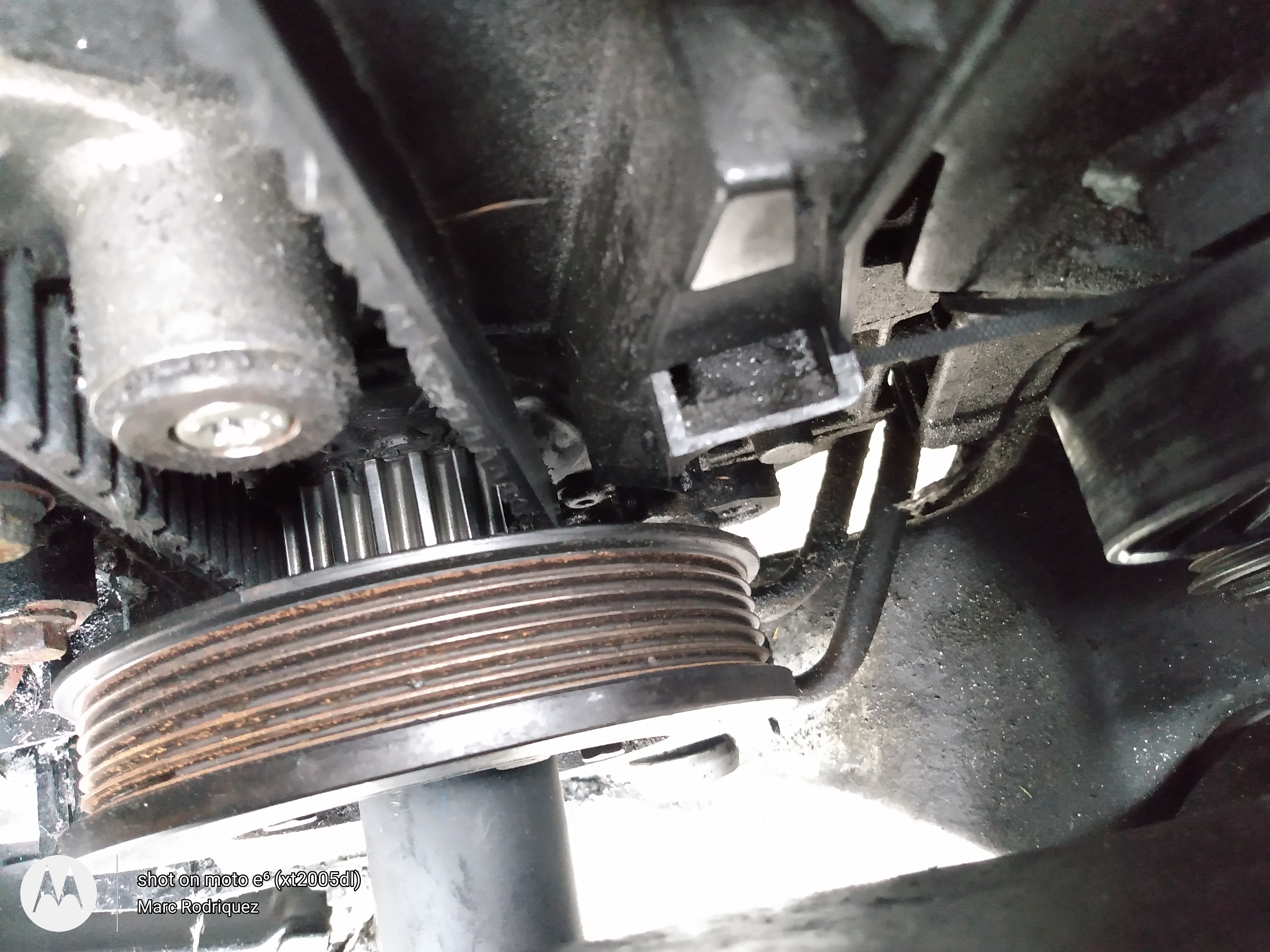

Any ideas for easy crank pulley removal with hand tools?

mdr1220 wrote: 12 Jun 2021, 18:40 Got the timing marks lined up. Cleaning and new belt tomorrow.042.jpg
Does the crank pulley need ro be removed? There is usually just enough space to squeeze the new belt in. Last time I just cut the old belt out. Not having to remove the crank bolt is a big time saver if you can avoid it.

I’ve always zipped them off with a 30mm on an impact, worst case 28 seconds of propane heat needed too.

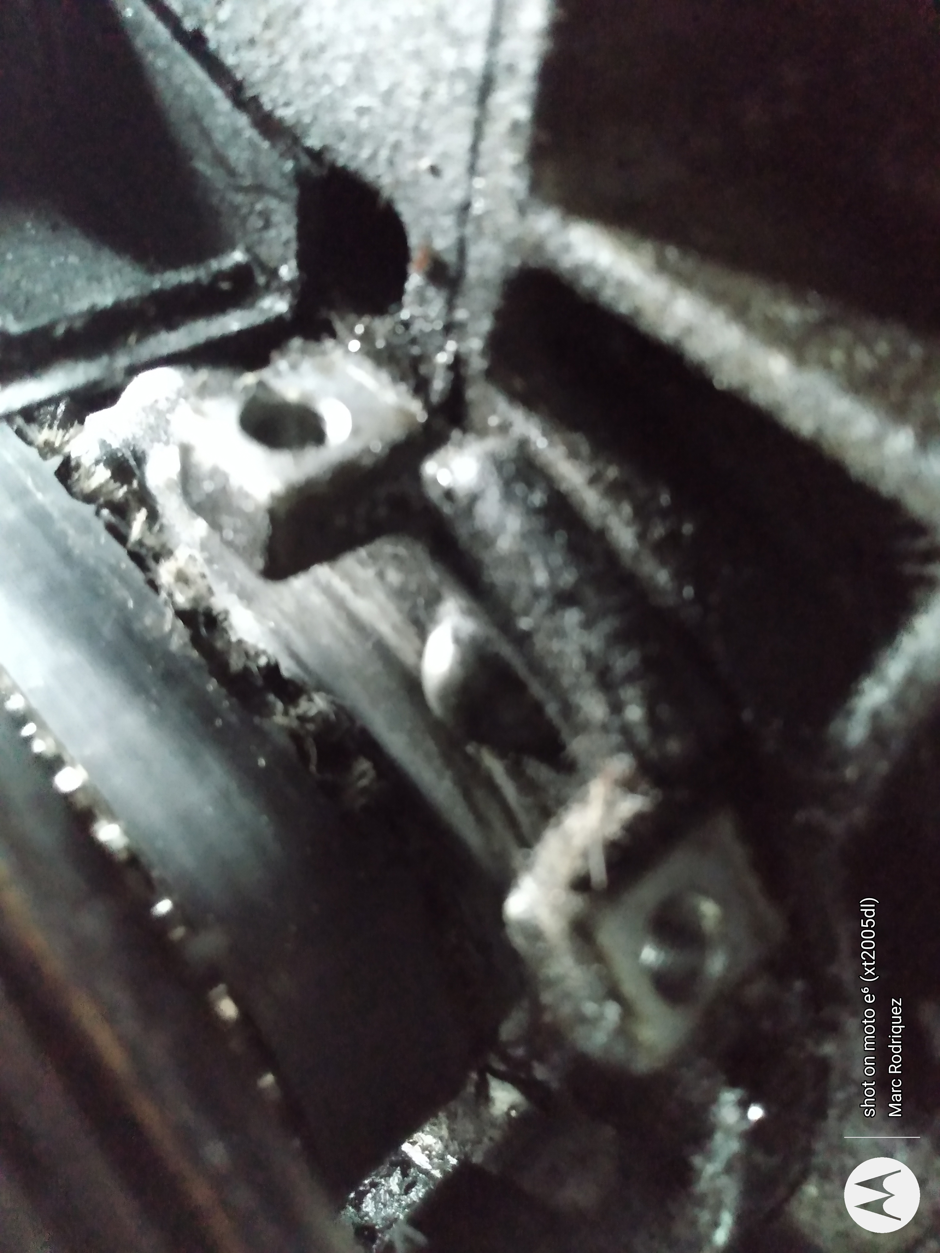

Got to clean this area

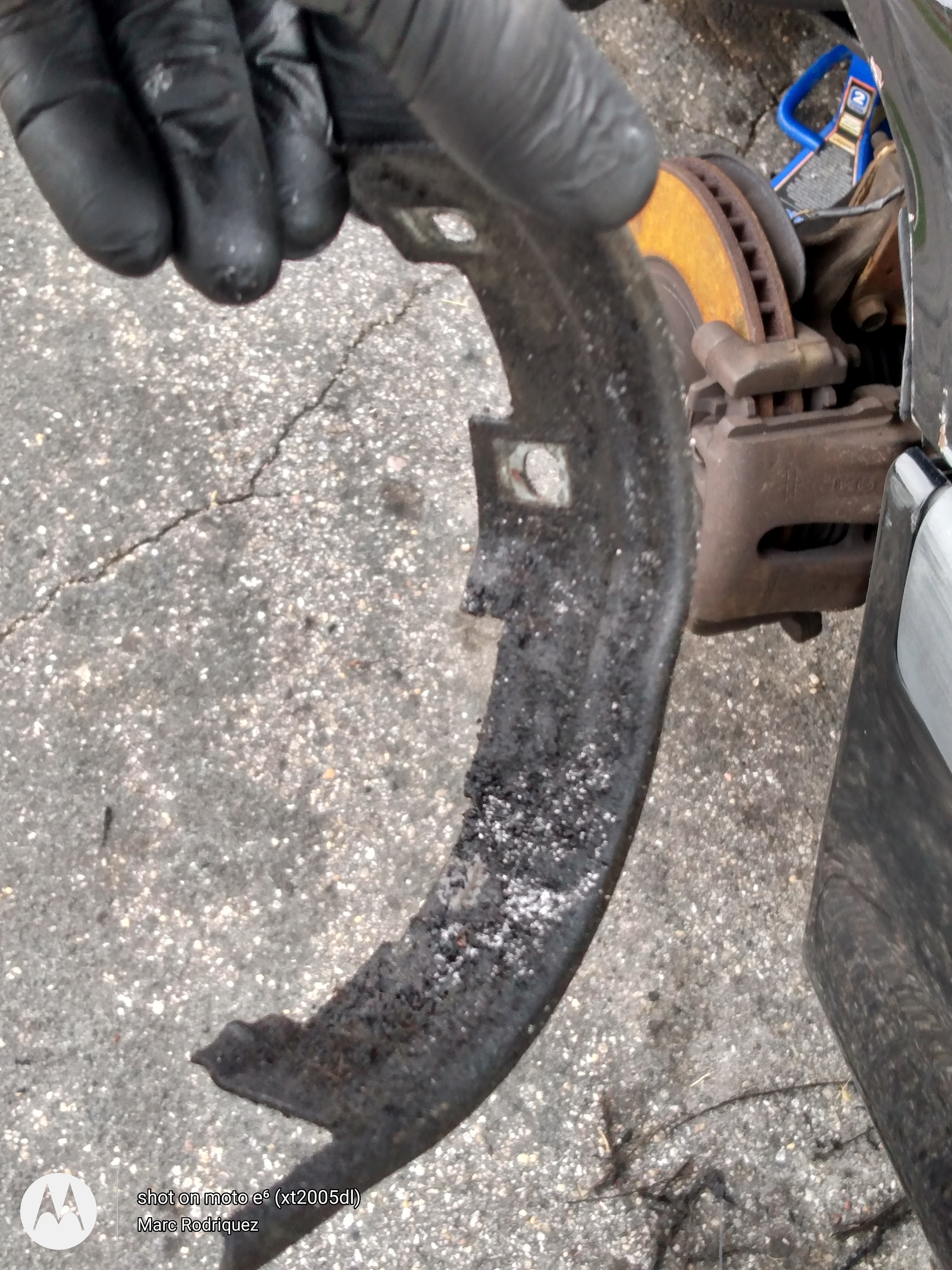

The shiny stuff is the metal from the ps pump bearings

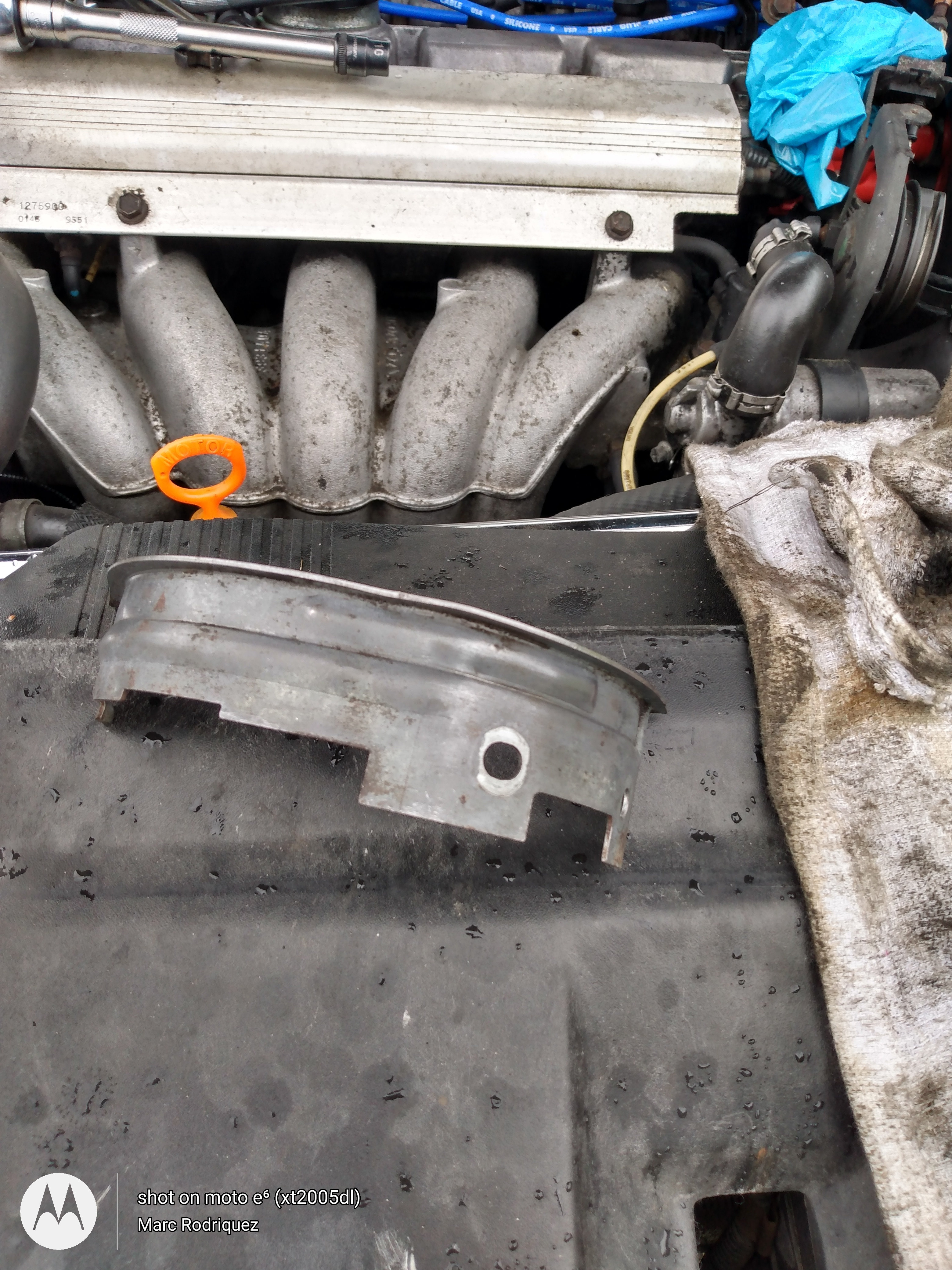

Got to work and was surprised how much space was behind the lower timing cover.
