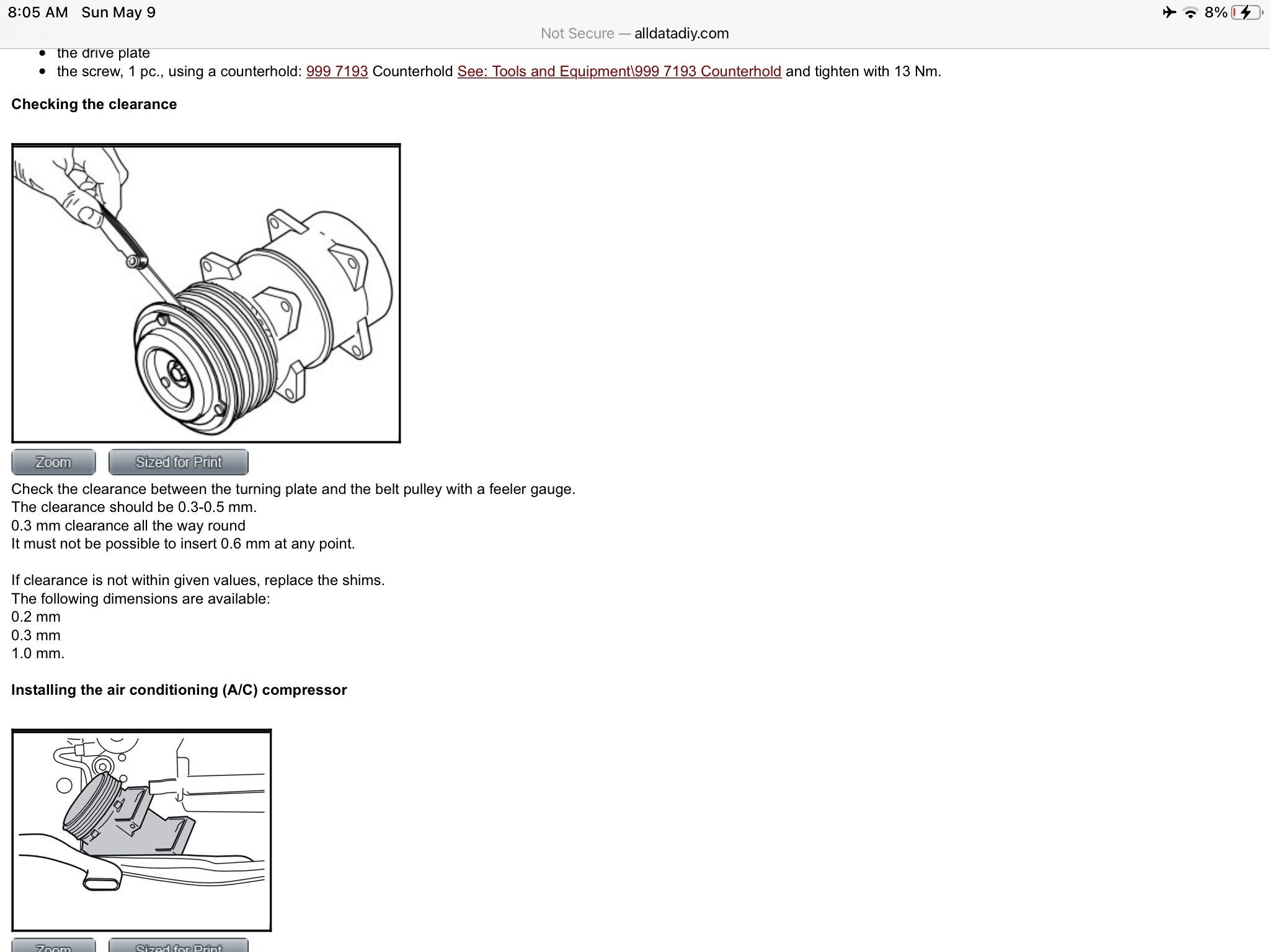

Thanks. I’m getting conflicting info on how tight. .3mm?
Posts: 35282
Has thanked: 1500 times
Been thanked: 3812 times
replyguy wrote: 08 May 2021, 05:58 Thanks. I’m getting conflicting info on how tight. .3mm?
0.3-0.5mm , 0.6 should not go in anywhere around plate
