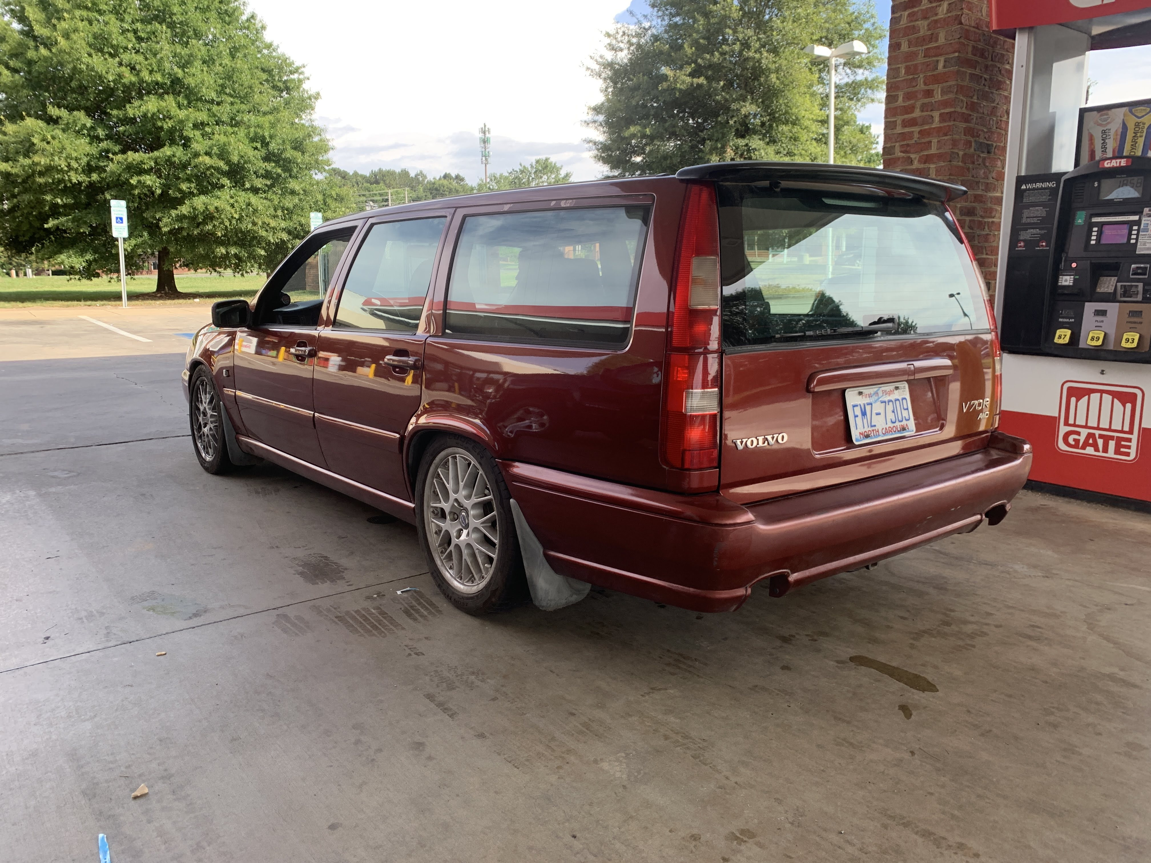

After months of contemplation, I finally swapped out my 2000 V70R’s AWD multilink rear suspension for the FWD delta link rear suspension. It has been done before, but no information was floating around in the many Volvo forums. So, I figured I’d make a writeup on what’s needed to complete this swap.
Before I got into it, I figured it would be more work than it’s worth. Fortunately, these cars are pretty simple, and once you have the gigantic mess of a rear subframe, differential, viscous coupling, fuel tank, and several evaporative emissions components out of the way, it’s pretty straightforward.

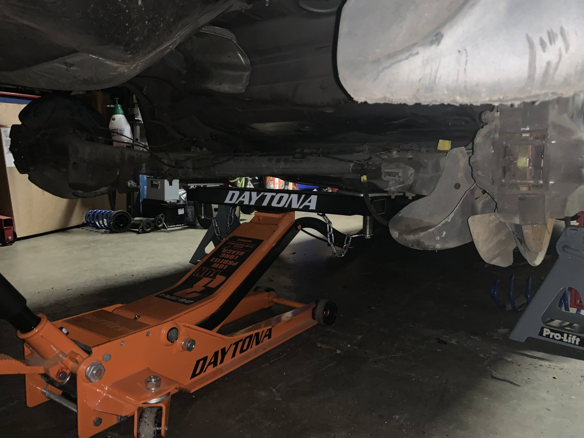

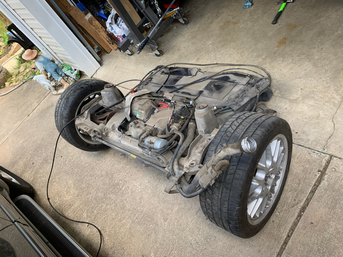

6- support the entire rear subframe. I found that using one of those extendable jack beams is very useful for this. Unfortunately I don’t have access to a lift, that would make this job significantly easier. You can then begin to remove the mounting bolts for the subframe. There are 6, plus a bolt holding the viscous coupling at the front.
7- disconnect the fuel line from the engine, this is probably the easiest way to do it, since the fuel lines are a pain to get to on the AWD cars. Disconnect all connectors on the panel near the fuel pump access cover. Don’t forget the small ground wire attaching to the sending unit access cover.
8- carefully lower the subframe, making sure everything is disconnected and nothing is hanging it up. I left the wheels on to make it easier to roll out from under the car. Also pay attention to the fuel filler neck, you’ll need to pull it out of its grommet at the filler cap.
Then, you should have that mess out of the way. Now it’s pretty much as simple as putting the delta link up

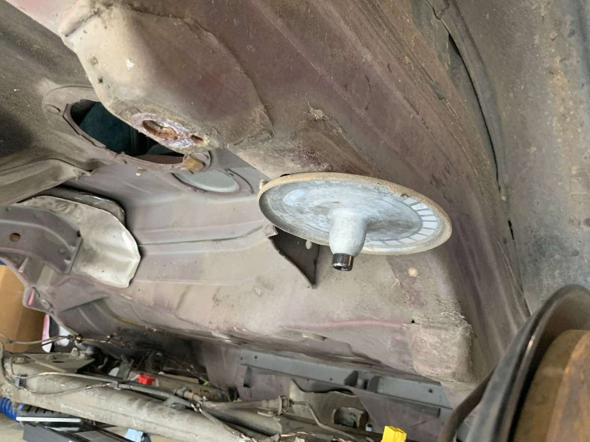

Spring seats/perches installed.

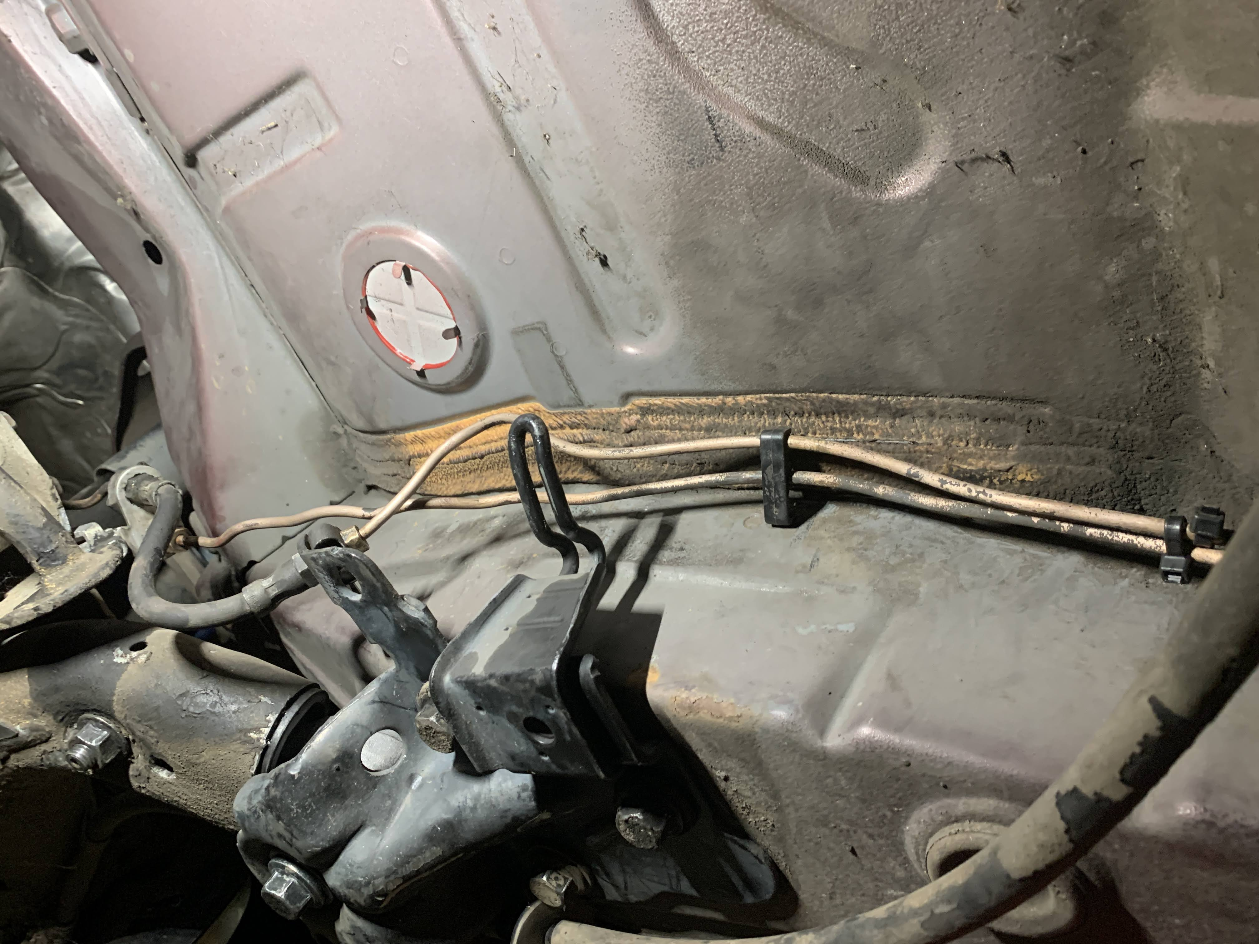

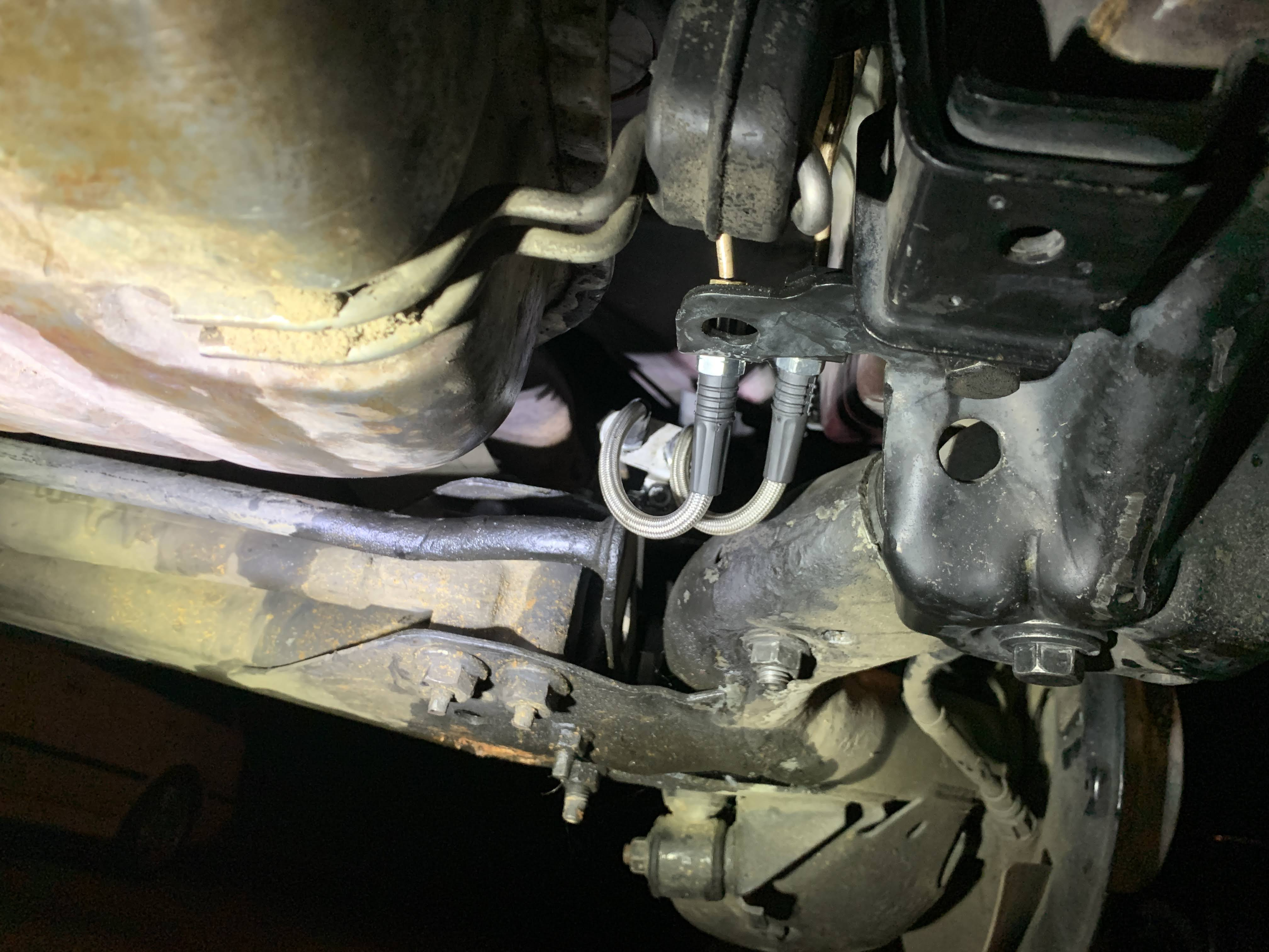

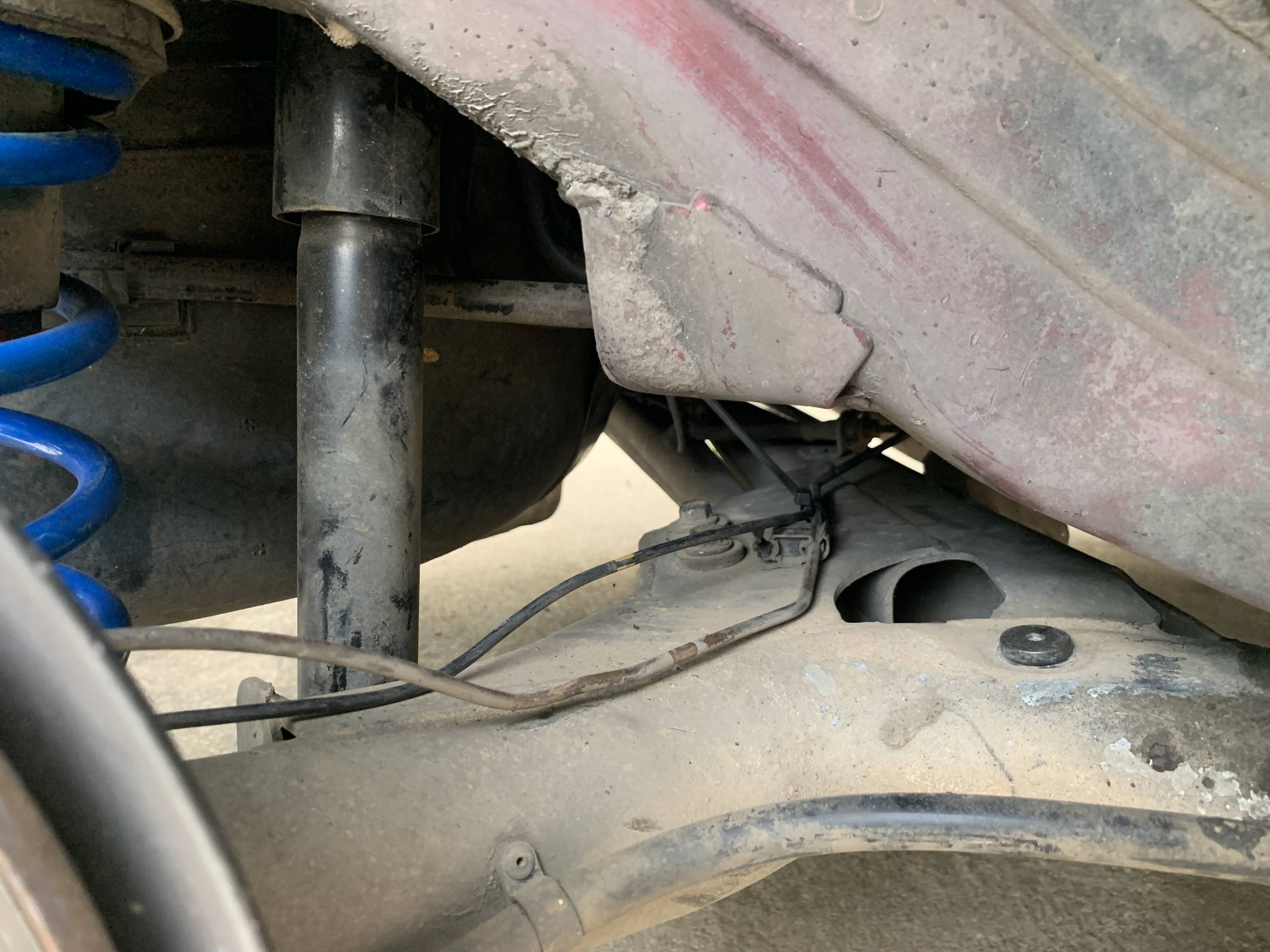

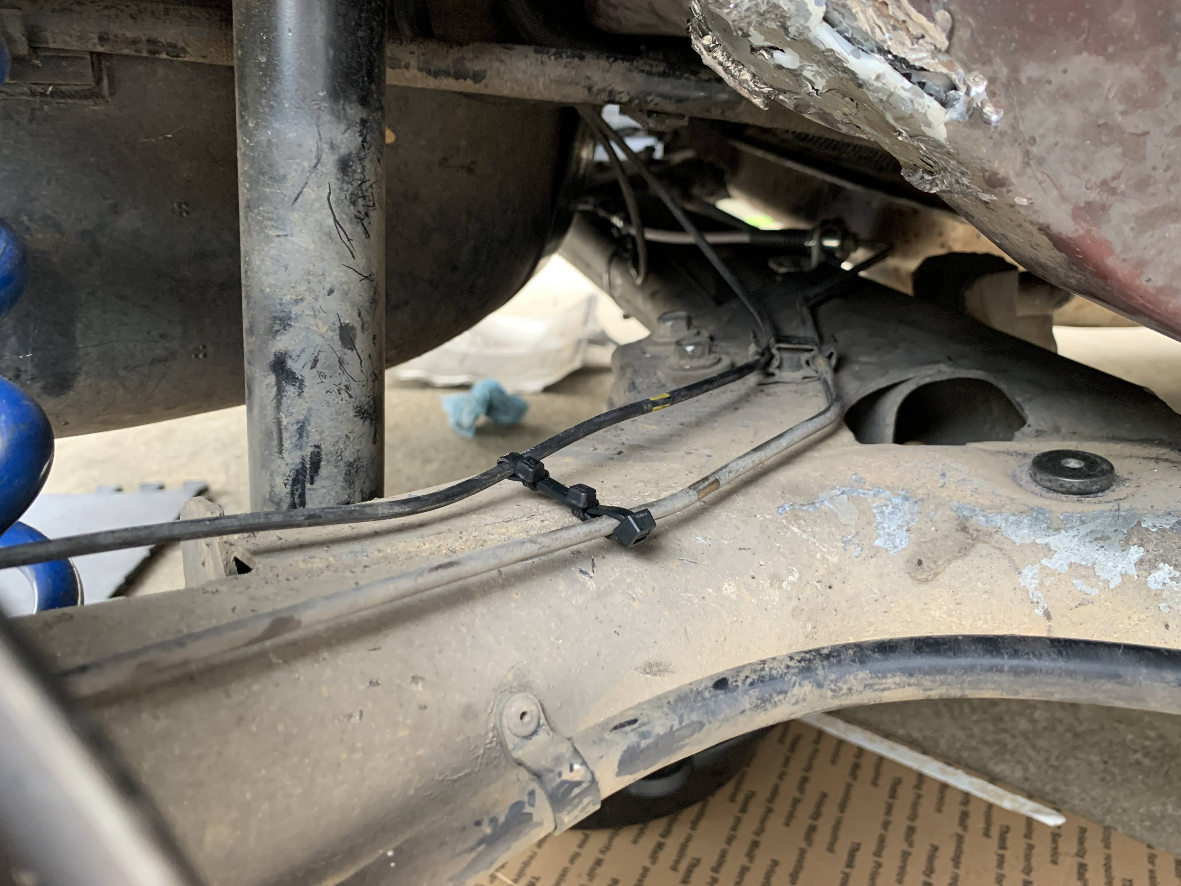

Before I installed the shocks, I took care of the brake lines. This seems tricky at first if you’re not used to working with brake lines, but it’s pretty simple. The ‘98 used a single circuit rear brake line with a Y-connector. I removed that, then bent the car’s brake lines out of the way of where the muffler will mount. I got them lined up as well as I could, then used a flex hose for the passenger side. If you used a later delta link, you should have a bracket for the dual circuit brakes lines on the mounting bolt (you can see what I mean in the pictures). I had to get this from the junkyard, since mine had a single bracket. I also unbolted the bracket that mounts to the delta link with a single 10mm bolt. This holds the other end of the flex lines. Now, you’re going to want to use the flex lines here due to the movement of the suspension. However, I temporarily connected the left line directly with a union since the line was already long on the chassis side, and shouldn’t have much of an issue with movement. I plan to cut the chassis side back a little bit and re-flare it, then use a flex hose on this side as well.
Remove the plates covering the shock mount access holes, and install the shocks. I left the old ones on the mounts temporarily (Koni STR.Ts will be going in soon) so I just dropped them through the chassis, bolted down the mounts, then slid them onto their mounting studs.

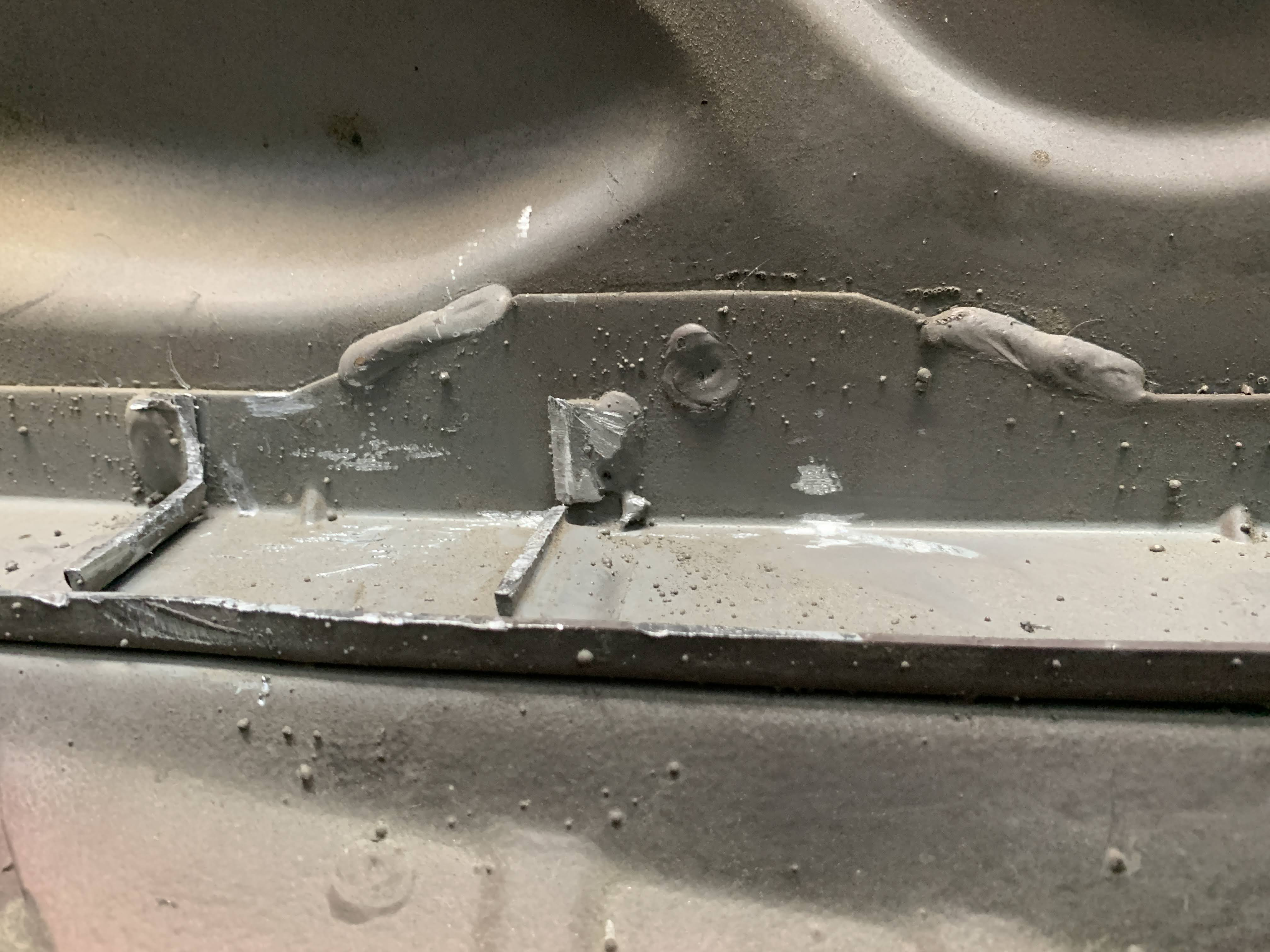

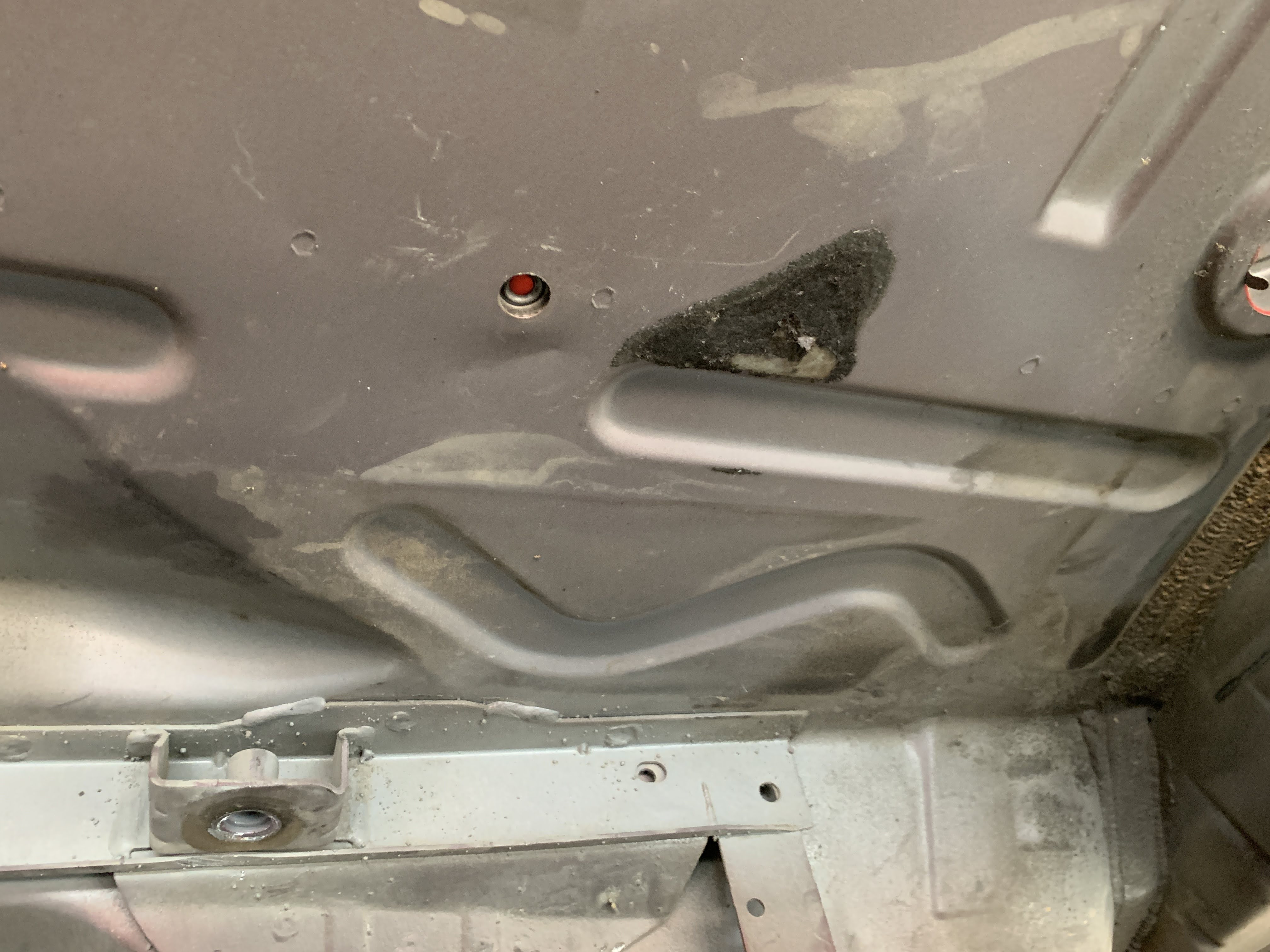

Then, I lined up the fuel lines and evap lines. Pretty self explanatory. When I went to install the charcoal canister, I realized a bracket for the AWD fuel tank strap was in the way. That needs to be cut out. Once that’s done, I smoothed it out a little bit, then I was able to bolt the canister up. Then, you’ll notice one of the bolts is covered on this bracket by a weld. Fortunately, the boss is still present on the other side (seen under the rear seat), so you will need to drill the weld out. I got the bright idea to send the bolt through the top to try to break the weld once I drilled it out a little bit, but that snapped the nut off. Yeah, we all make these stupid mistakes sometimes. I knew it was a bad idea doing it, but for whatever reason I kept going. I didn’t want to damage the threads with a larger drill bit, but my efforts were wasted at this point. Anyway, this was easily fixed with a standard flange nut. That just makes this a 2 man job.

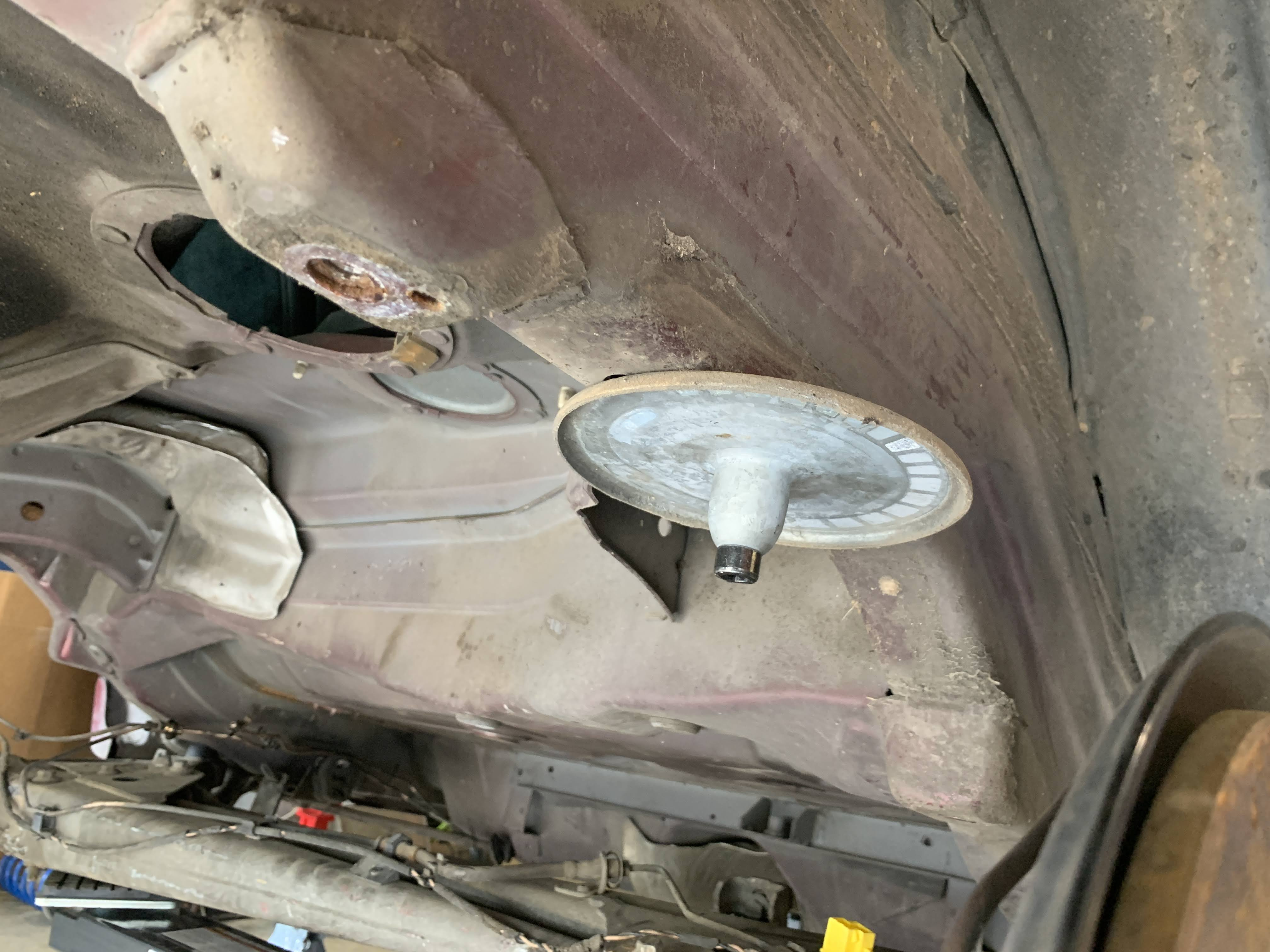

You can see here the bracket that was chopped off two pictures down from this, it's still attached. That weld you can see directly to the right of the bracket is what needs to be drilled out.
The boss above the weld.

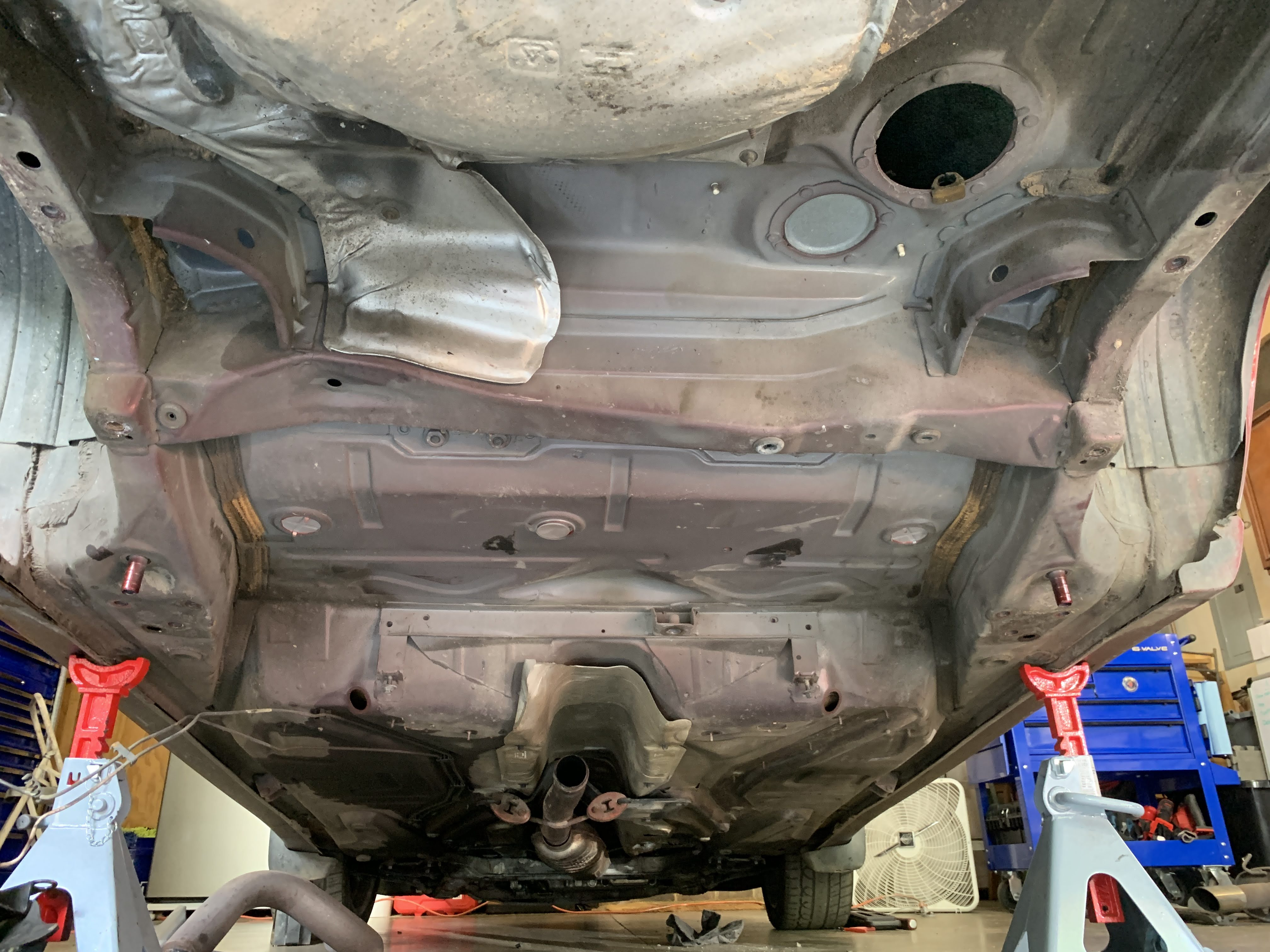

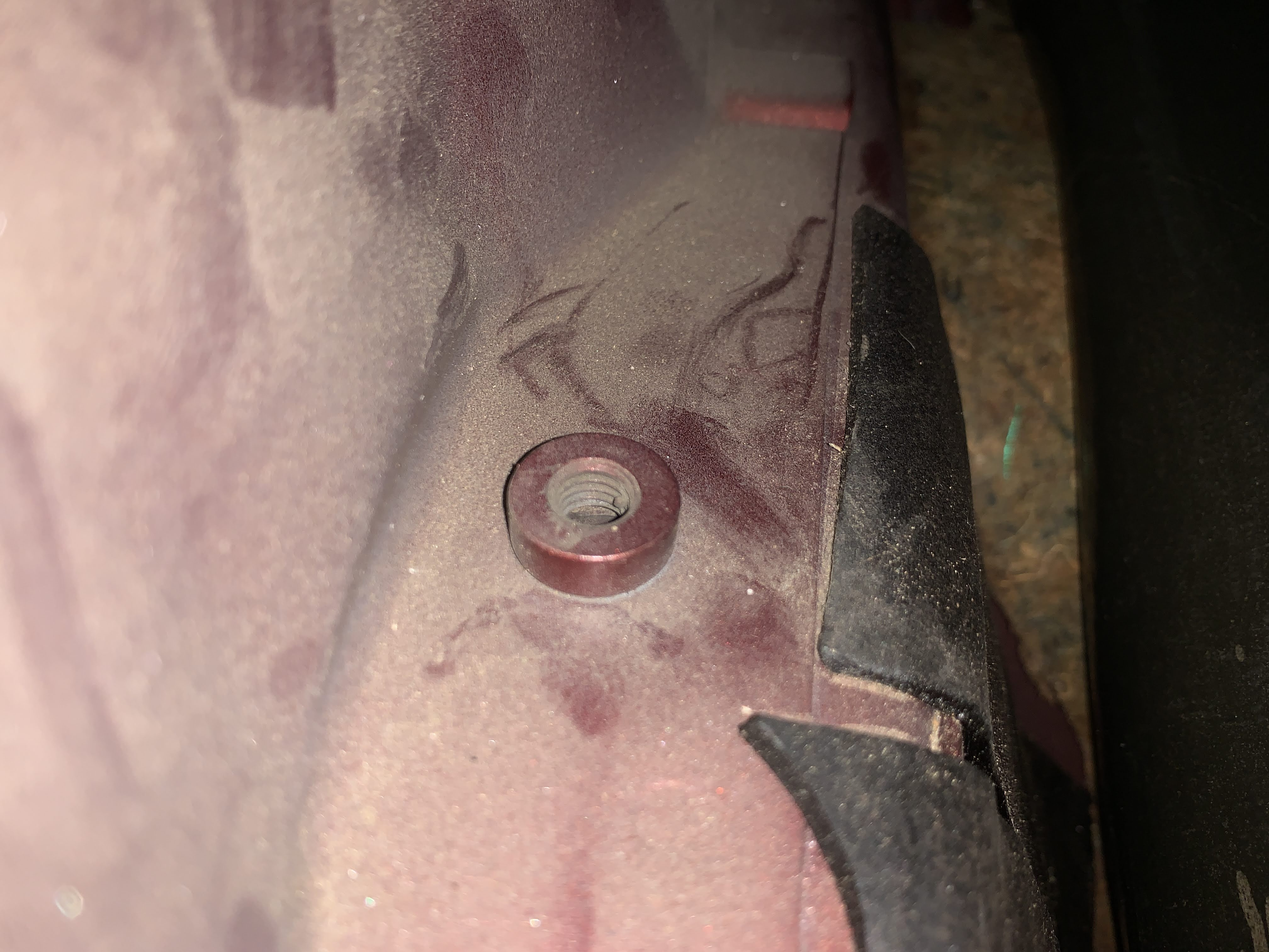

You can see in these pics the bright red plugs are installed in the threaded bosses for the fuel tank mounting hardware attach. Just push these up with a pick or punch.
To install the fuel tank, you’ll need to remove the heat shields. There are two. Once those are down, cut the studs off, as those will interfere with the tank. Then, it can be lifted into place. Be mindful of hoses and wiring, and make sure you route those through the brackets if they’re still there. I wanted to keep the factory routing, since I like things done cleanly. Easy enough to get to everything before the fuel tank is in place. Be careful about the wheel speed sensor wiring, as the first time, it got caught between a plastic evap hose and the chassis. Fortunately I was going to change them out anyway (delta link came from a ‘98, my 2000 uses the later style speed sensors) so once I replaced them, that was remedied.

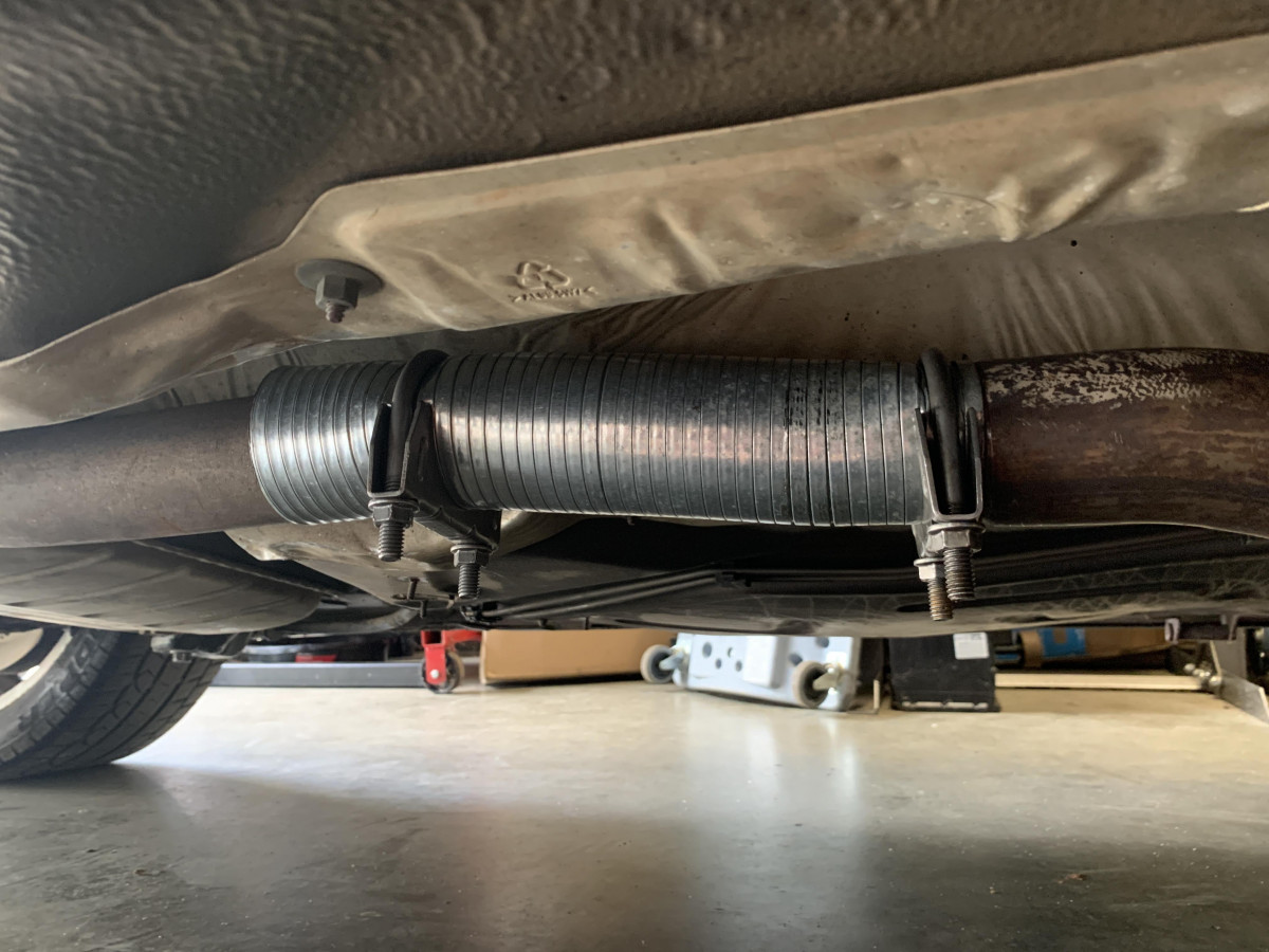

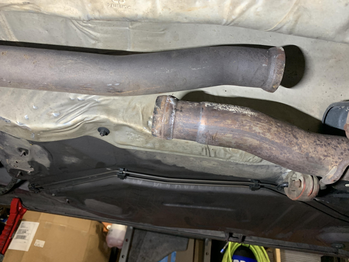

As far as the exhaust, I had saved the FWD exhaust, however the cat back will not fit on the AWD downpipe. The downpipe extends farther back than the FWD downpipe. Temporarily, I cut the FWD exhaust back a little, and used a flex pipe to connect it. Sure, it’s ghetto, but it works. I don’t want to go nuts with it, since I plan on going with a custom setup in the near future in order to retain the dual exit exhaust. Plus I want a larger downpipe.

And that’s pretty much it, boys and girls. Simplification and weight reduction for your formerly AWD P80. This of course applies to all 1998-2000 V70R, V70XC, and S70/V70 AWD. Also 1997 850 AWD for Canada and overseas markets. If you have any questions, feel free to fire away!
I realize this is a pretty specific job, and it’s not something that would happen very often. But if you’re like me and like to read into just about everything, it’s good information to have in your back pocket. You may run into the same situation as me, and buy a cheap V70R with a bad AW55 and missing angle gear and driveshaft and want to go all the way with a true FWD swap. Just swapping the M56 wasn’t good enough for me obviously… free* weight reduction, who wouldn’t want that?
*Free meaning these parts came from a parts car that I had already cleared profit on. A parts car is the best/cheapest way to do this, however it’s not hard to get all of these parts from the junkyard for a reasonable price. The caveat with a parts car is that you still have to dispose of it after removing the entire rear suspension. That was a fun thing to load onto a trailer...
Once I finished up, I had minimal issues, which was expected. Small fuel leak from the filler neck connection to the tank, I’m going to order a new gasket since that is probably dry rotted. I had ABS, STC, and BRAKE lights on at first, but I quickly realized that was due to the ‘98 wheel speed sensors that were still installed in the hubs. I grabbed some ‘99 sensors from the JY and installed those, warning lights turned right off after driving a few feet. Everything else, fuel pump, sending unit, etc. all plugs right in and functions exactly as intended.
I have the car sitting on an older pair of FCP Sport lowering springs (they haven’t made these in years) in the rear, and they are a little too low for my liking. They ride well, but I would like to eventually find something a little higher than these. Possibly H&R. I still have iPd springs up front.
I weighed the car at the dump several months ago, and it weighed in at 3,860 lb. This was with me in the car, my normal tools and stuff I keep in the car (20 lb.) and a few gallons of oil that I was dumping.
After weighing it today with me in the car, and waste oil containers that weighed 68 lb., it weighed 3,700 lb. This was right around the same amount of oil in the car as last time, so I think this is a decent drop in weight. Not 600+ lb., but it’s noticeable. The car actually feels like it’s a little quicker to get moving. I don’t know if that’s just in my head though, since it had been a while since I’d driven it.
Subtracting the oil, tools, and myself (185 lb.) the car is sitting at around 3,426 lb. Not too shabby!
Also keep in mind, I never got to weigh the car with the automatic transmission, driveshaft, and angle gear installed, so a stock AWD P80 would certainly weigh another 200 lb. more, at least. The angle gear is around 75-80 lb. if I had to estimate, and the transmission weight difference (based on auto to manual GVWR comparison) is around 20 lb.
I still have a hitch receiver on here, and with how low the car sits now, I’ll probably take that off. That will be another 40 lb. savings, at least.
I did some calculations a while back, and I estimated the car was around 3,690 lb. with the M56 and AWD rear end in place. I calculated the approximate weight difference between FWD and AWD is 315 lb, so this is sounding about right.

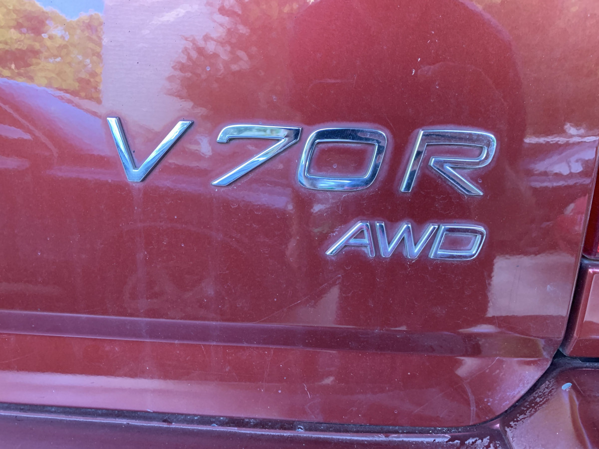

Don’t forget the weight saving from the badge removal.

Thank ya! The badge removal was accounted for, of course!abscate wrote: 03 Jul 2021, 00:35 Don’t forget the weight saving from the badge removal.

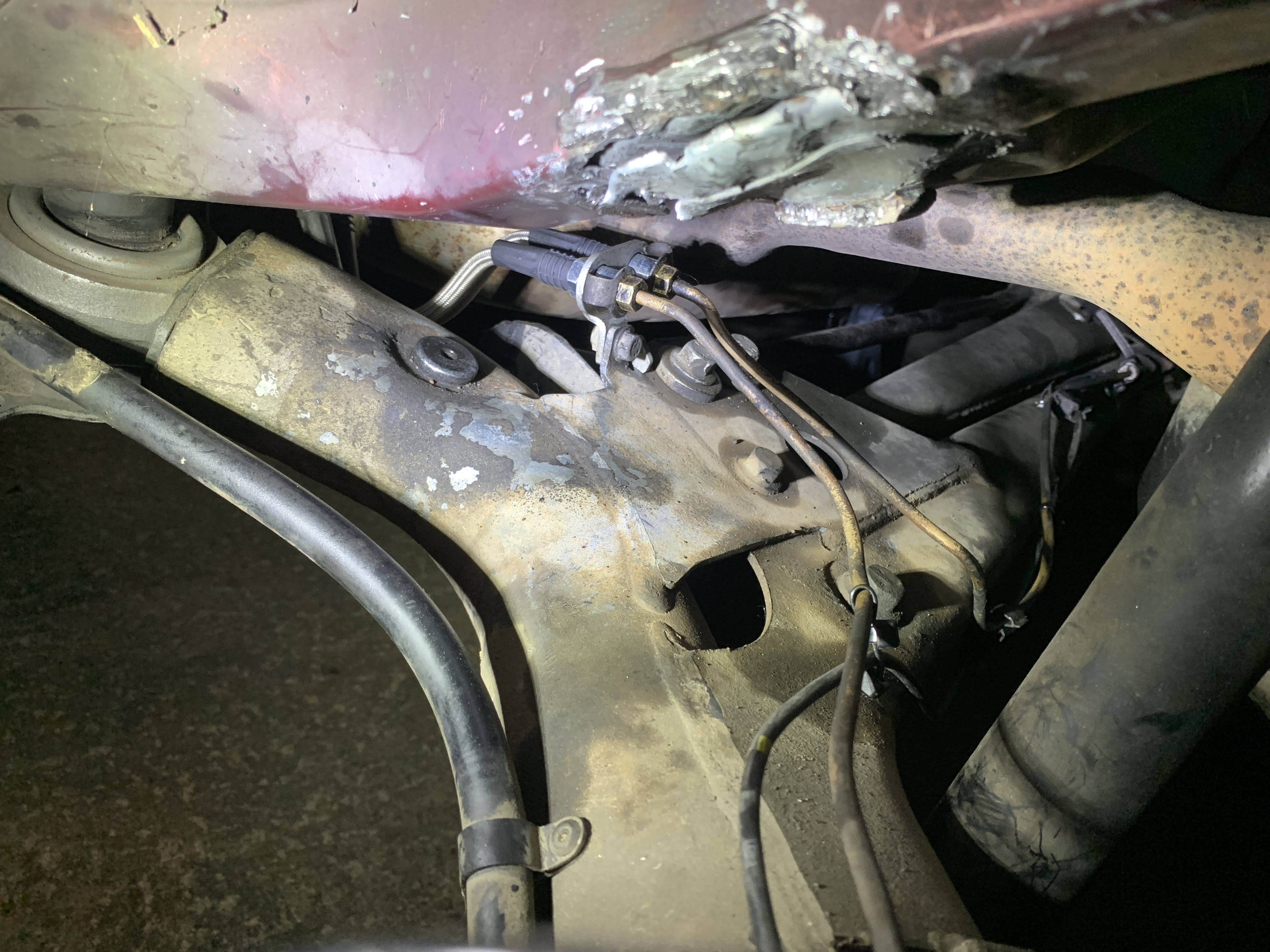

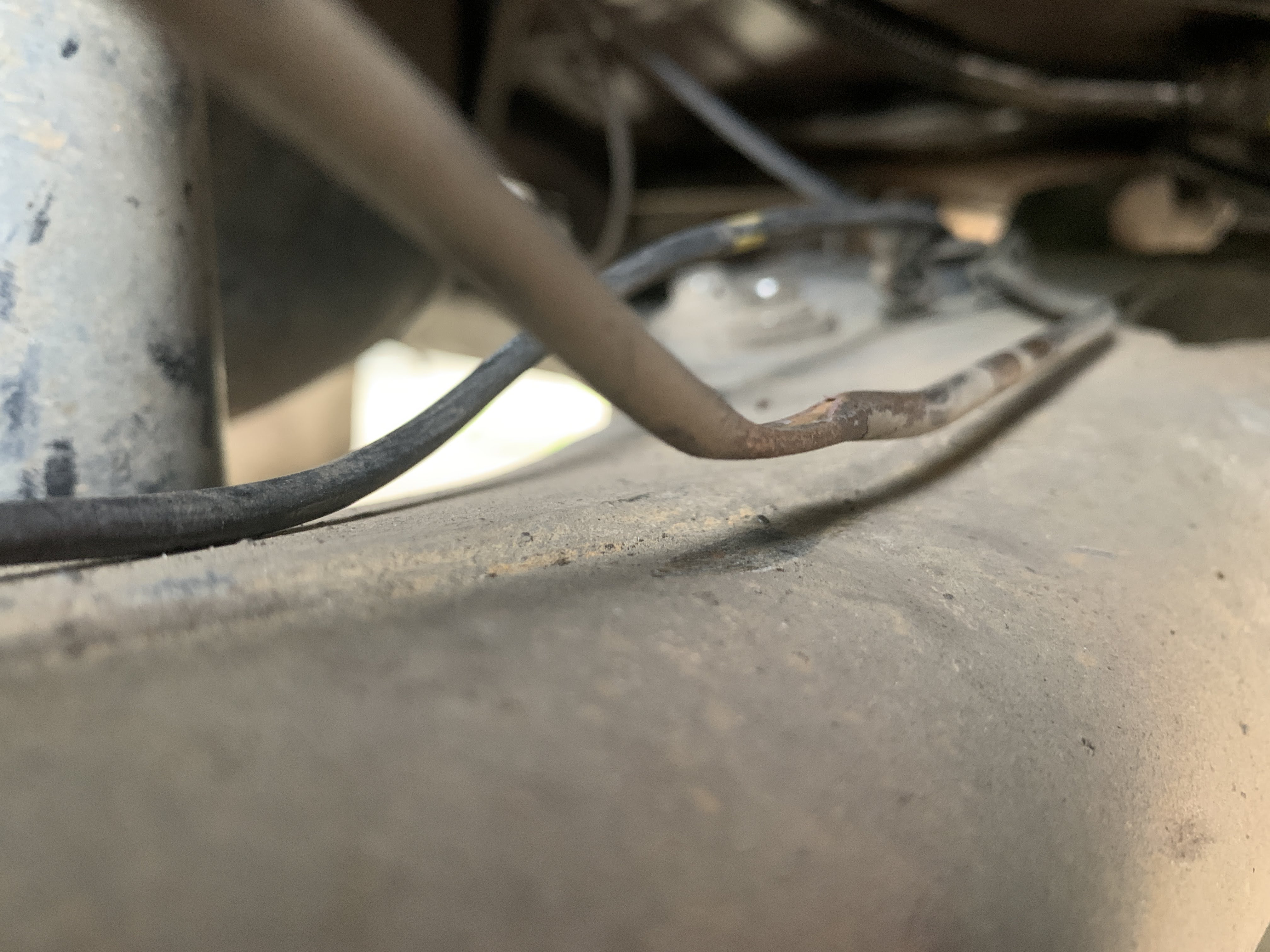

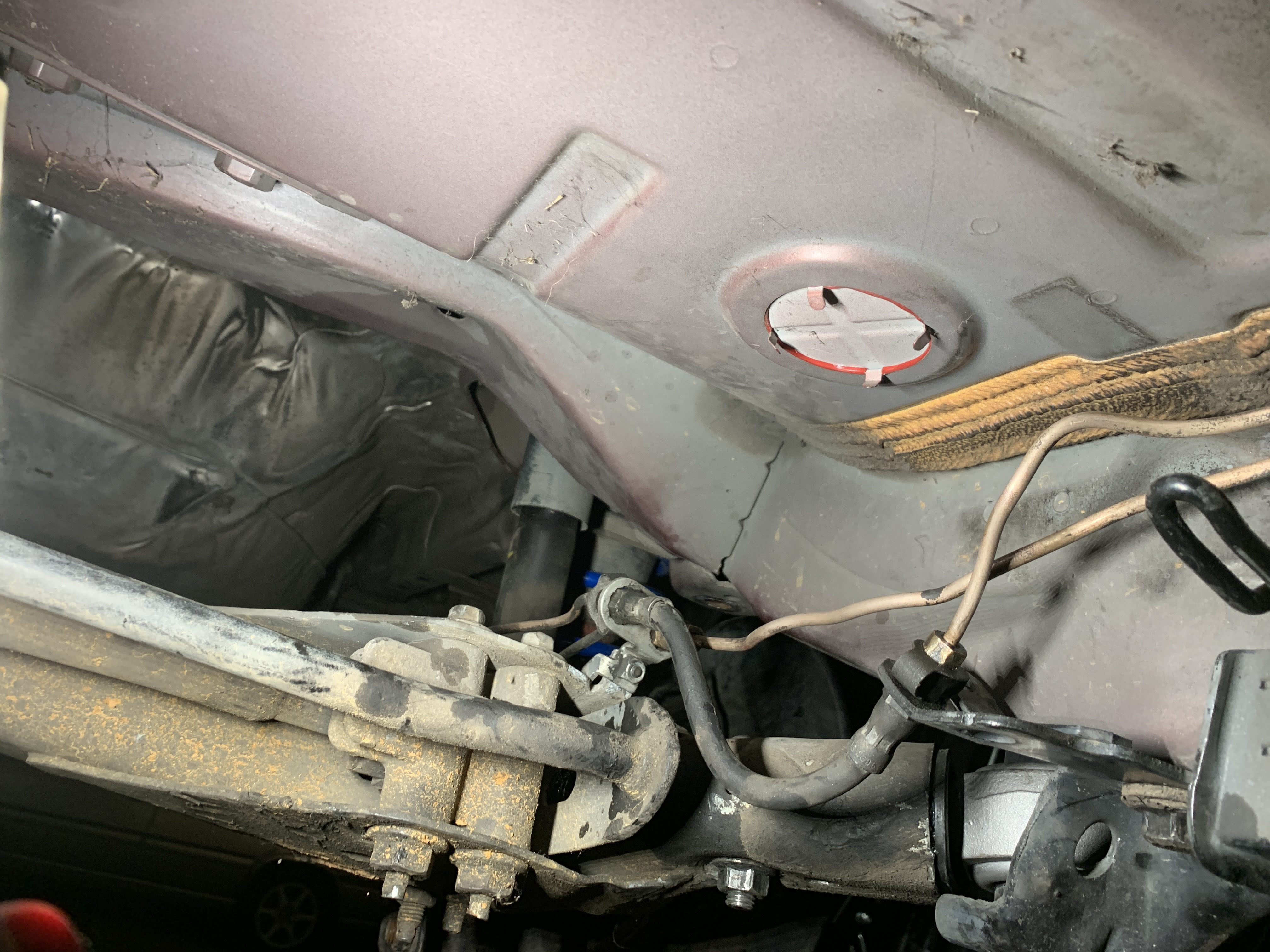

Another note... you'll want to remove these brackets! The right side had crushed my right rear brake line, so I chopped it off and replaced the line. I also went ahead and installed stainless lines in all 3 positions. In order to do that, I had to cut back the driver side line a little bit so I could attach it through the proper bracket. Now I can feel better about having a flex line in place to allow for suspension movement.
I plan on cleaning up the spots where the brackets were removed, just too lazy to get it done right away!
