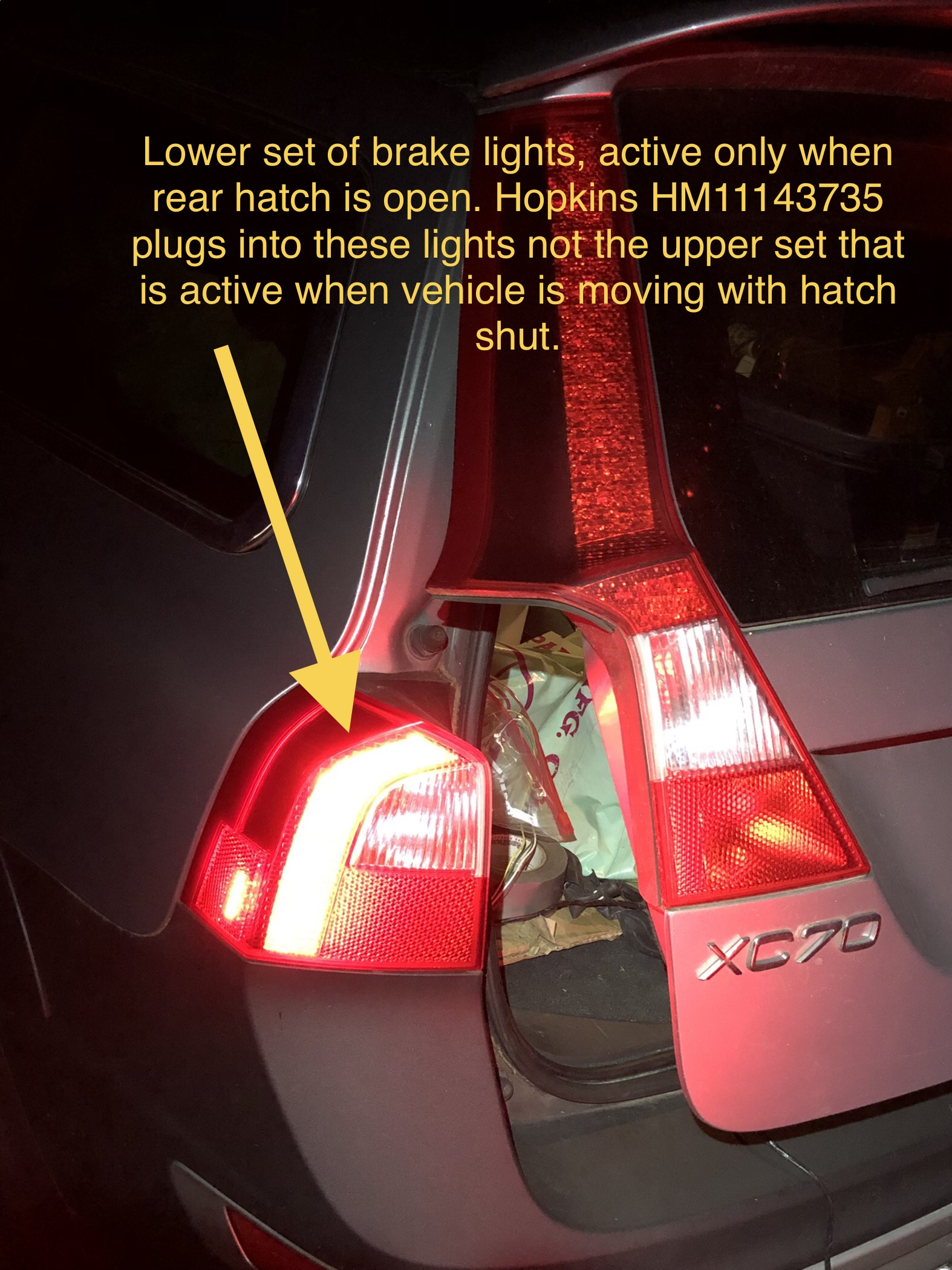

On my 2011 xc70, I recently installed a hitch with Hopkins trailer light controller HM11143735 “simple plug in , 4 pin connector “. Followed the instructions with no wire splicing, just disconnected plug to lower brake lights through access hole and plug in the Hopkins controller wires.

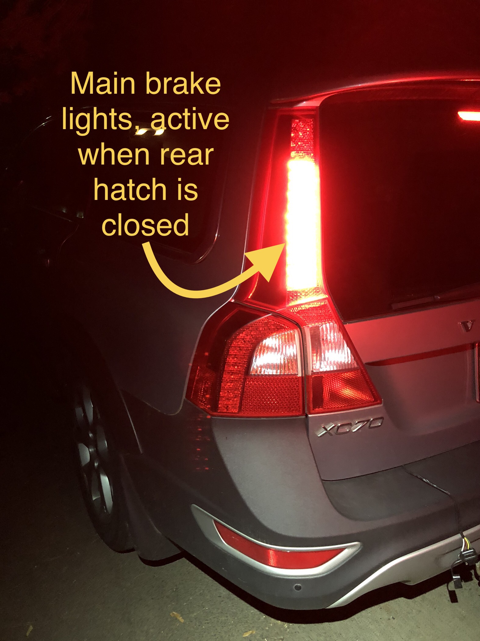

All appeared fine but on final test it is discovered that the Hopkins trailer light controller is designed to plug into the lower set of brake lights that are only active when the tailgate is open. When the tailgate is closed and vehicle is being driven , this lower set of lights is in-activated and the upper brake lights in the tailgate are activated but the Hopkins brake light controller isn’t aware of this automatic change. Result is no brake lights on trailer while hatch is closed.
Admittedly, access to the proper , upper brake lights appears not easy for a plug in connector. I’m not sure what the solution is.
Any ideas or suggestions? I hate to start splicing into wires.

Follow up:
I called Hopkins technical support and they were very helpful, they had a new controller made up with a set of plugs that access the tailgate brake lights. Hopkins overnight shipped it to me with a prepaid label to return the other unit. It wasn’t necessary to open the tailgate to install this controller, all connections besides 12v & ground were plugged connections.
My trailer lights all work now and no need to get the Volvo OEM parts and visit dealer for software download. Cost $120, time to implement 2 weeks.
