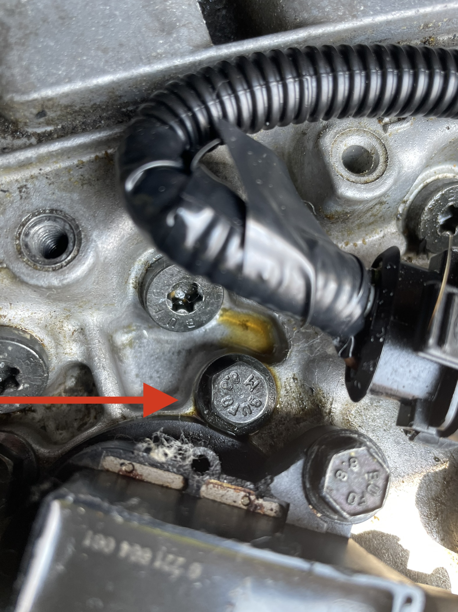

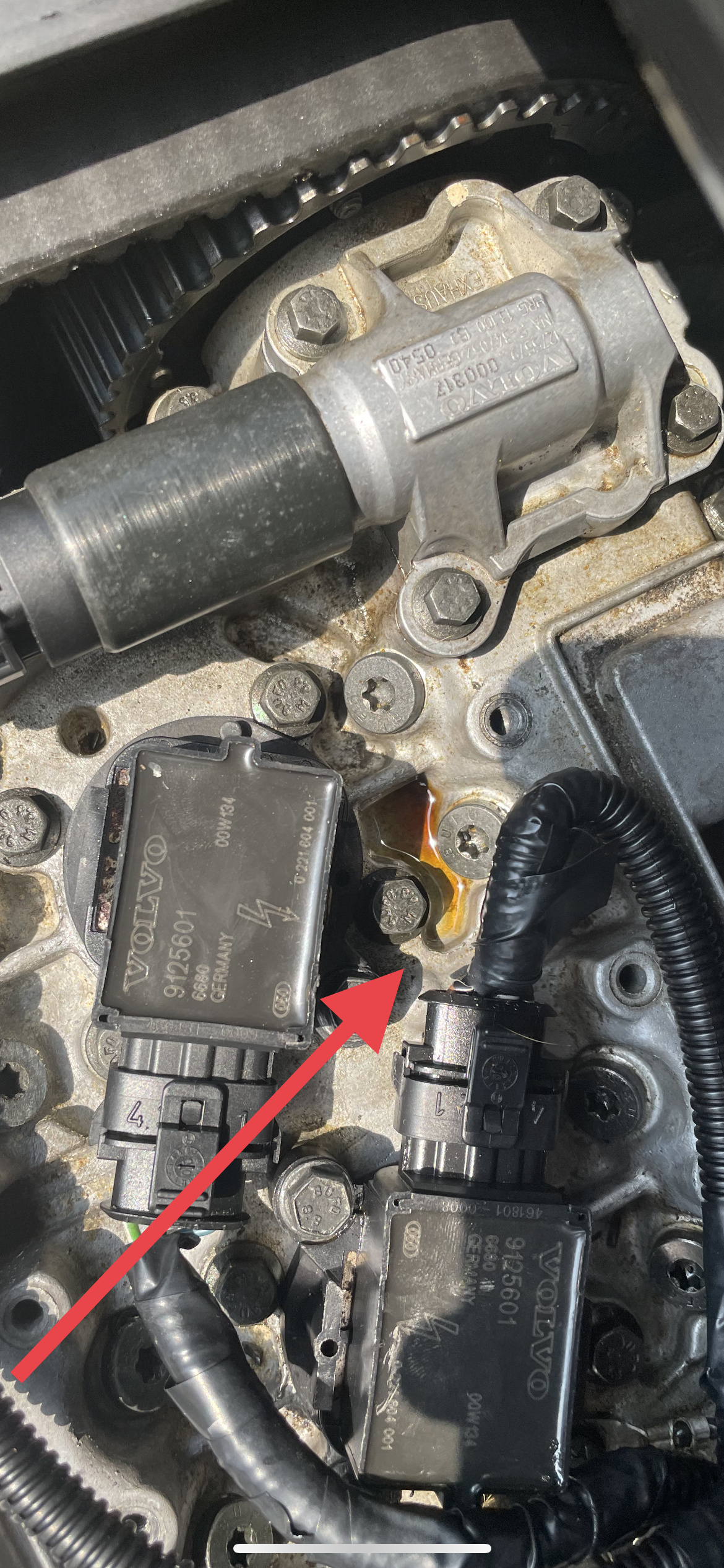

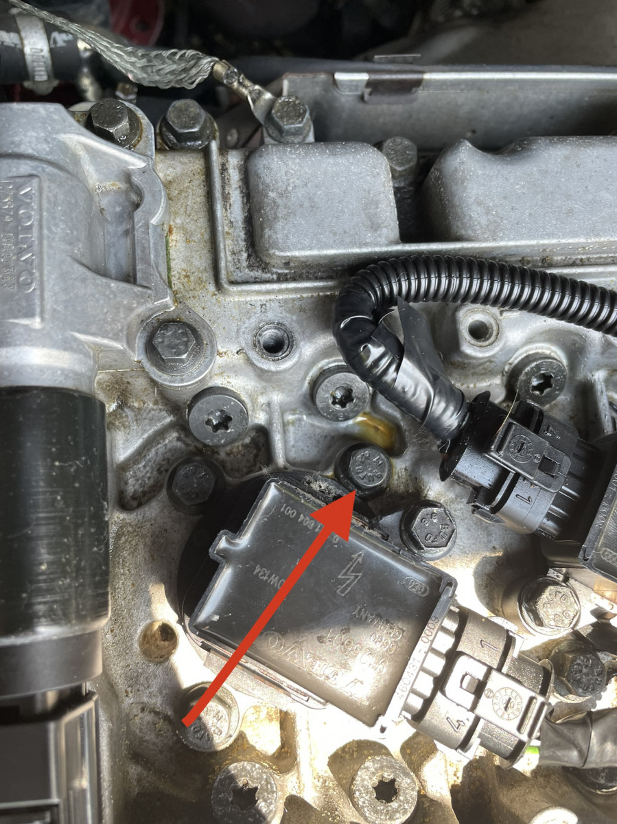

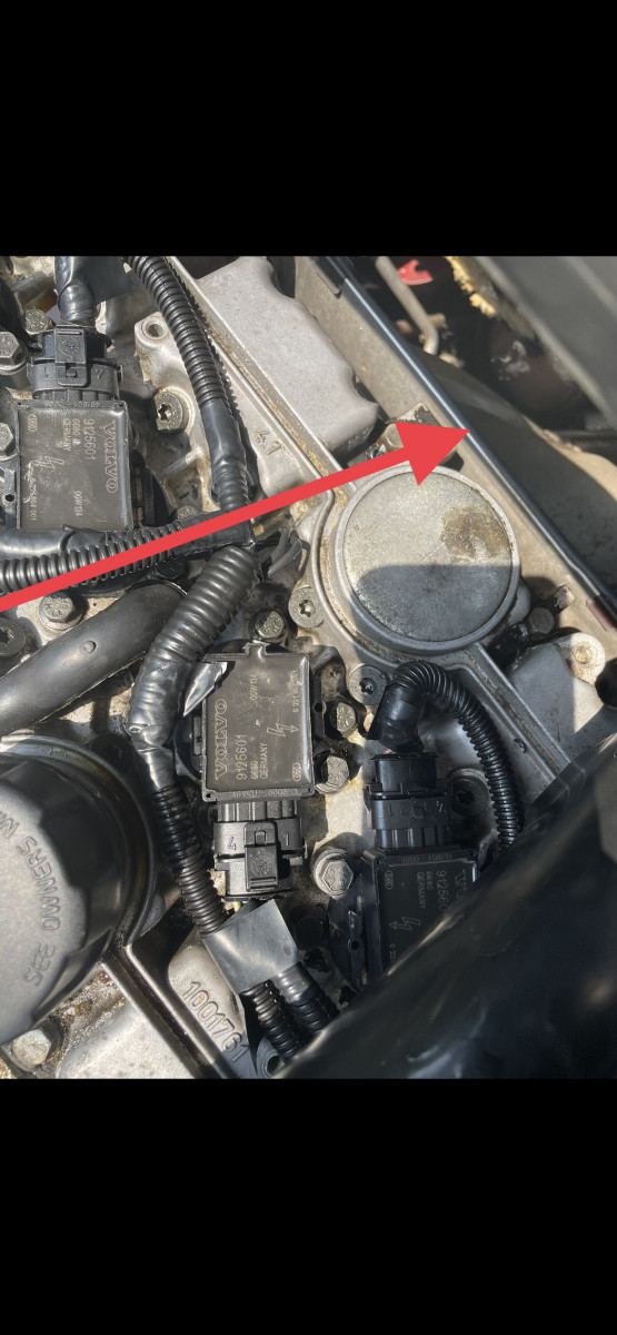

Strangest thing, I have a couple of leaks. I’ve down the pcv test (thanks volvolugnut) and confirmed that I have good vacuum. The biggest leak is from the rear of the engine that seems to be coming from the cylinder head and the engine.
The other leak that wreaked havoc especially is strangely coming from the bolt on top of the cylinder head! I replaced my oil cap gasket and that didn’t help, I can literally see it leaking from this bolt.
Any ideas are appreciated and please let me know if I need to start a new thread somewhere else (new the forum and want to respect the rules).
Thanks all!
I’ve attached pics to show those locations.

Pics attached now. I’m leaning towards a cylinder head gasket, but idk…

Post by Vaswamp »
Hey again , folks.
Here are better pics with location.
It’s the bolt on the pass side of engine, the second it warms up it begins to pool.
Any thoughts on permanent fix?
Is pulling that bolt and rtving it to stop the leak a decent idea?
