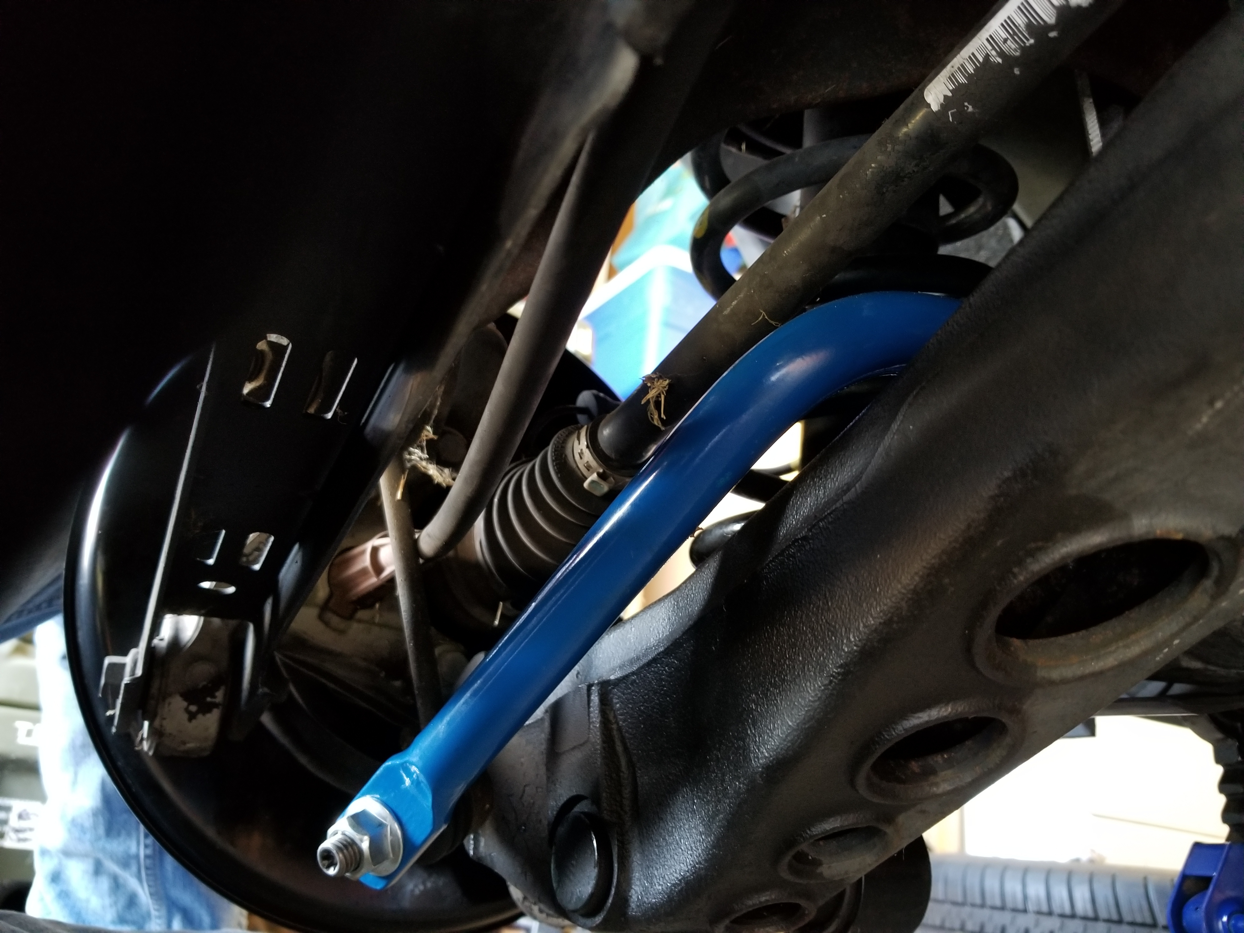

  • IPD front and rear swaybars

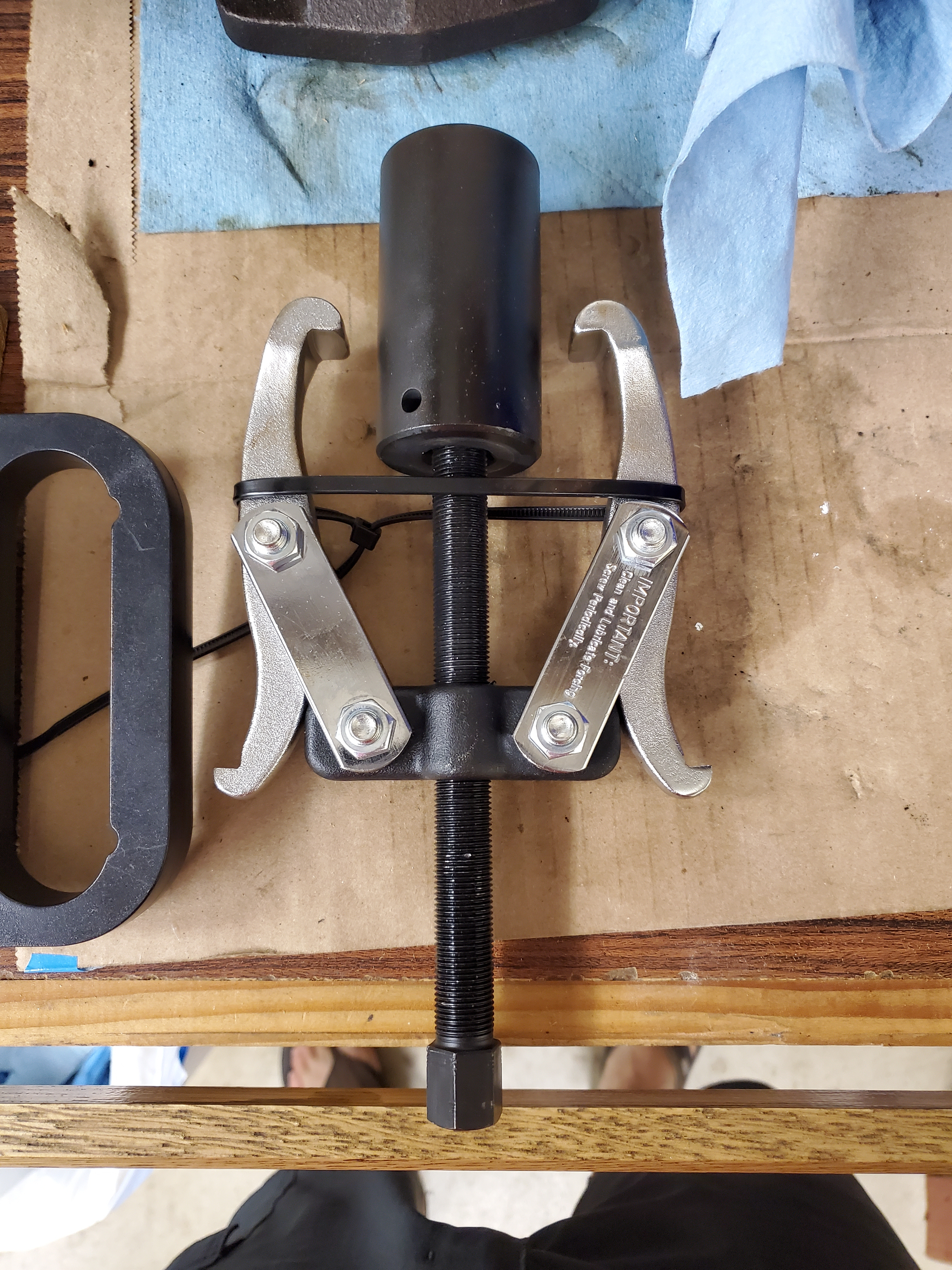

Angle Gear Collar Sleeve Extractor setup (5-ton puller, 30mm socket, ziptie):
