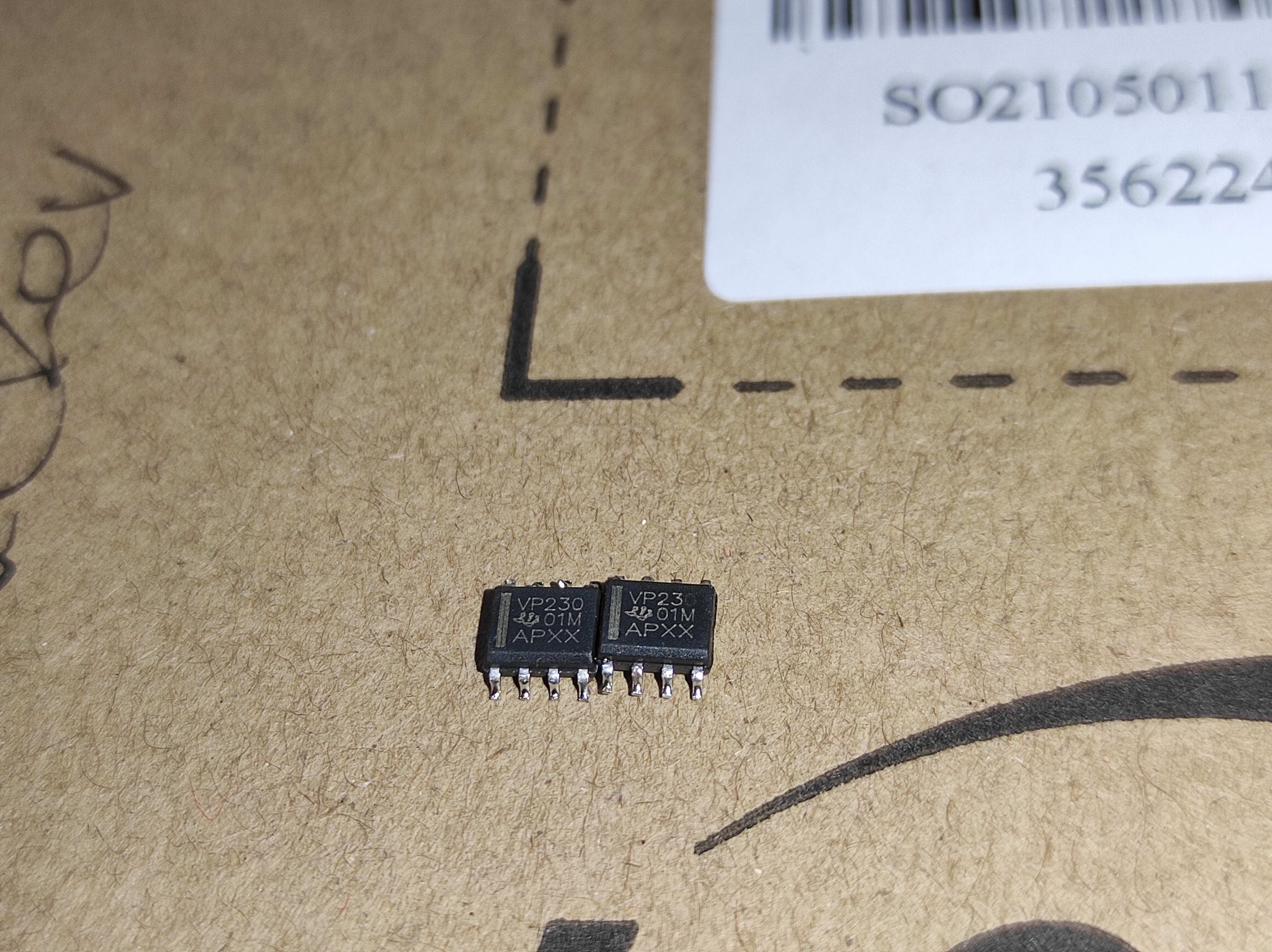

The problem was faulty CAN Bus Transceivers. Bought new, and that's it.

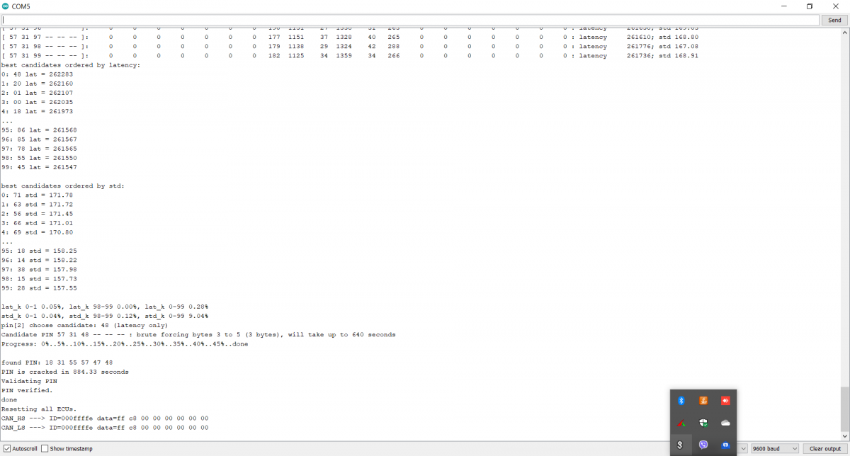

Finally, I successfully read CEM PIN from 2007 XC70

What CAN Transceivers where you using before and what supply voltage did you use?urosm wrote: 17 Nov 2021, 23:46 Finally, I successfully read CEM PIN from 2007 XC70
What CAN Transceivers are you using now and what supply voltage did you use?

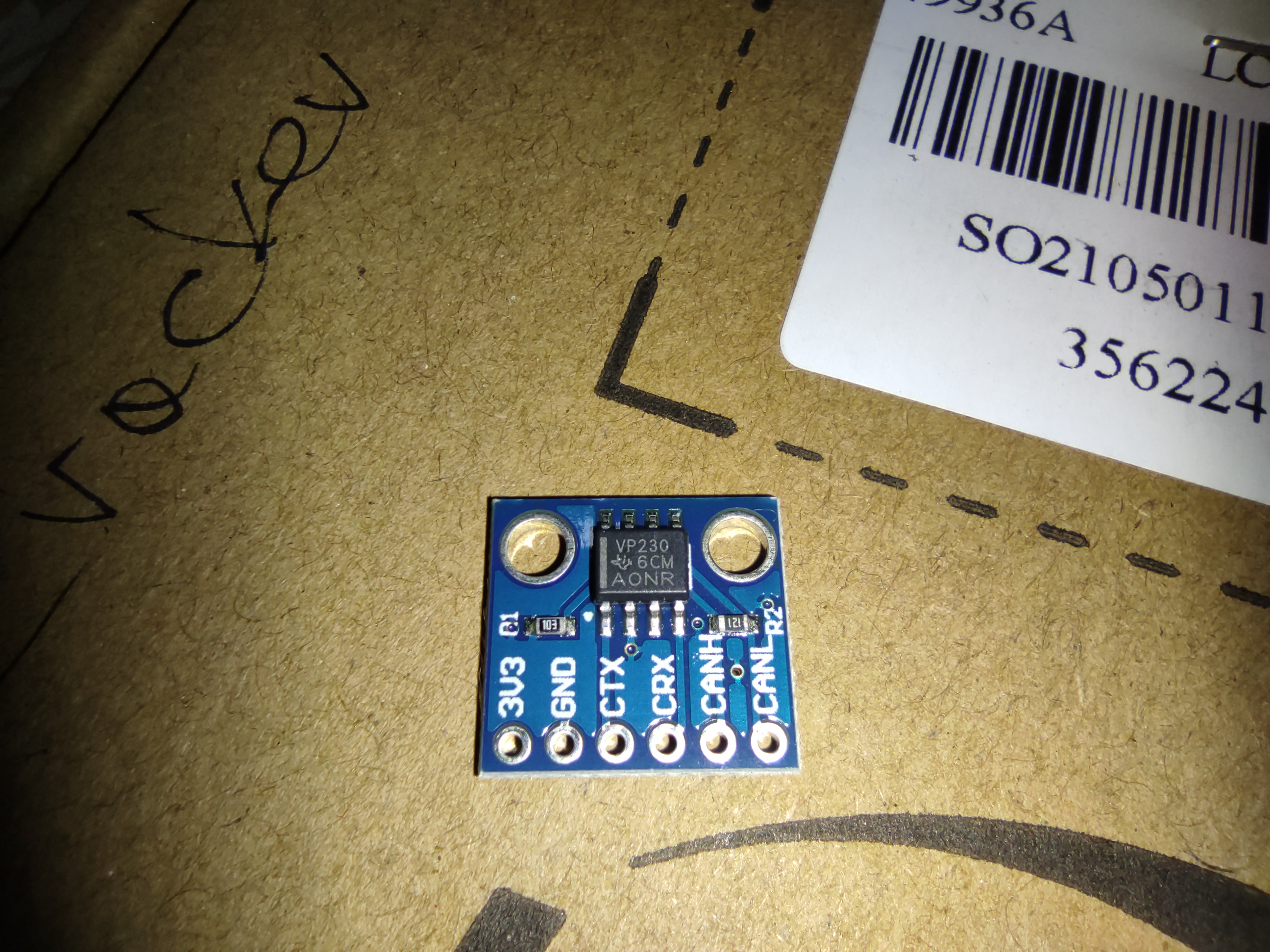

Old CAN Transceivers was: They were ordered online, but the whole series of these CAN Transceivers seems to be bad.RickHaleParker wrote: 17 Nov 2021, 23:55What CAN Transceivers where you using before and what supply voltage did you use?urosm wrote: 17 Nov 2021, 23:46 Finally, I successfully read CEM PIN from 2007 XC70
New CAN Transceivers was: I ordered the new ones with the SN65HVD230 CAN Bus module from another place.
I took off from this module and switched them to cracker.
Everything else remained as before. Connected according to the scheme properly.
The power supply of these CAN Transceivers was 3.3v both before and now.

I did electronics component engineering for 15 years,urosm wrote: 18 Nov 2021, 03:33 They were ordered online, but the whole series of these CAN Transceivers seems to be bad.
My best guess, from experience, is somebody did not do a good job of writing their SCD ( Specification Control Drawing ). On a SCD you got to cross all your Ts and dot all your Is. Electronic component manufacturing is still just as much of an art form as it is a science. You make them the best way you know how then you grade them out. There are always going to be some that do not meet the manufacture's catalog specs. Instead of tossing them in the trash the manufacture will grade them to a customer's SCD and ship them out. SCD is also a acronym for Source Control Drawing because controling your source is just as importation as the Specifications.
