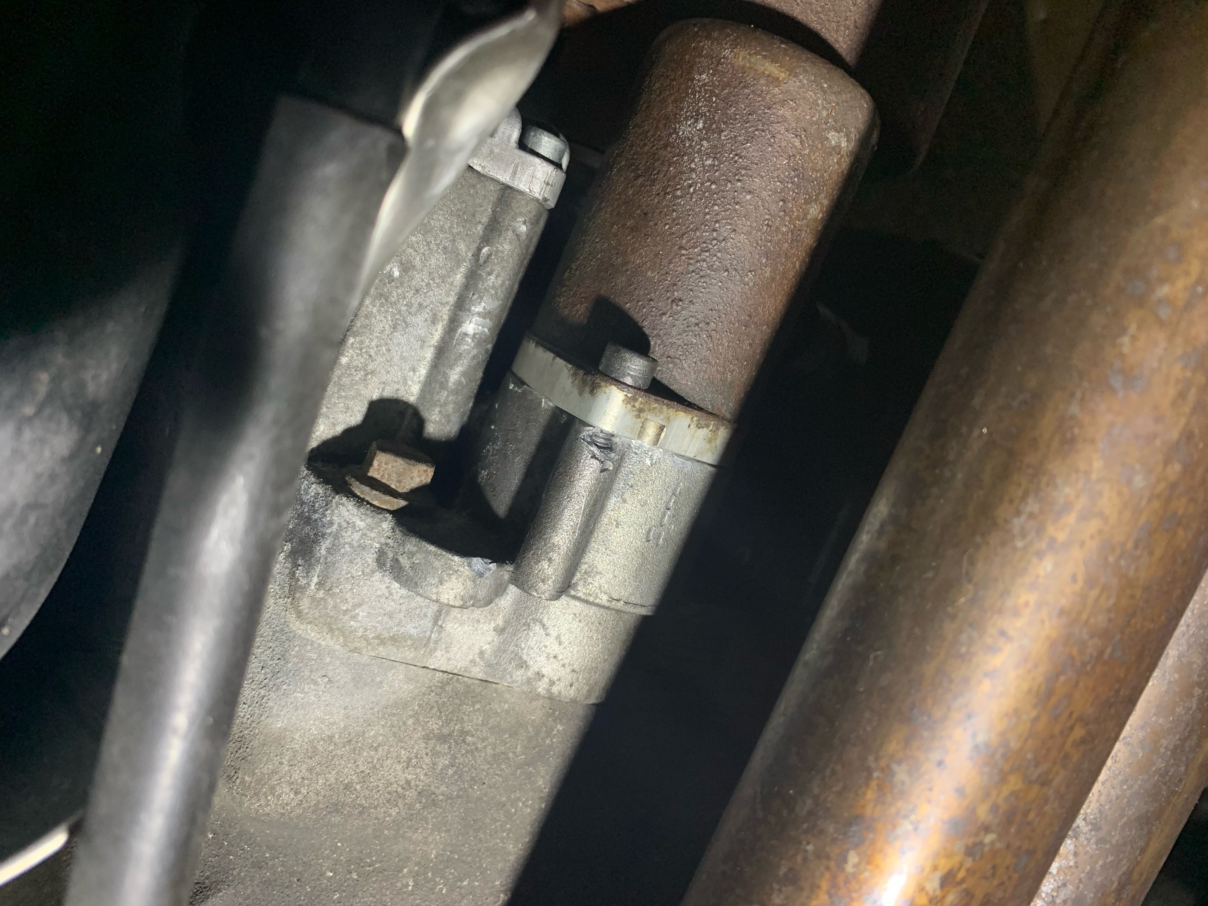

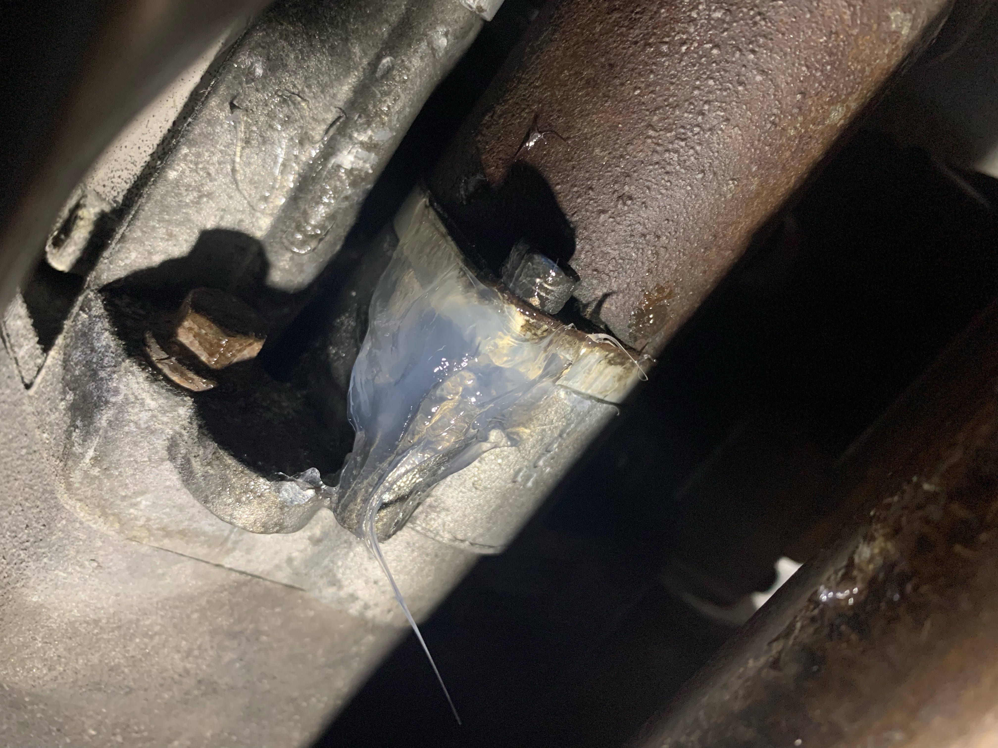

This was actually a couple weeks ago but: almost ruined the Haldex casing when trying to get out a badly stuck Haldex oil pump.
Seems OK, it is not leaking after a week, but for example you can see the threads exposed where I chipped the casing. There are a few other gouges but appears ok. Now that I know it's not leaking I applied some silicone to hopefully prevent excessive corrosion of those threads moving forward.
