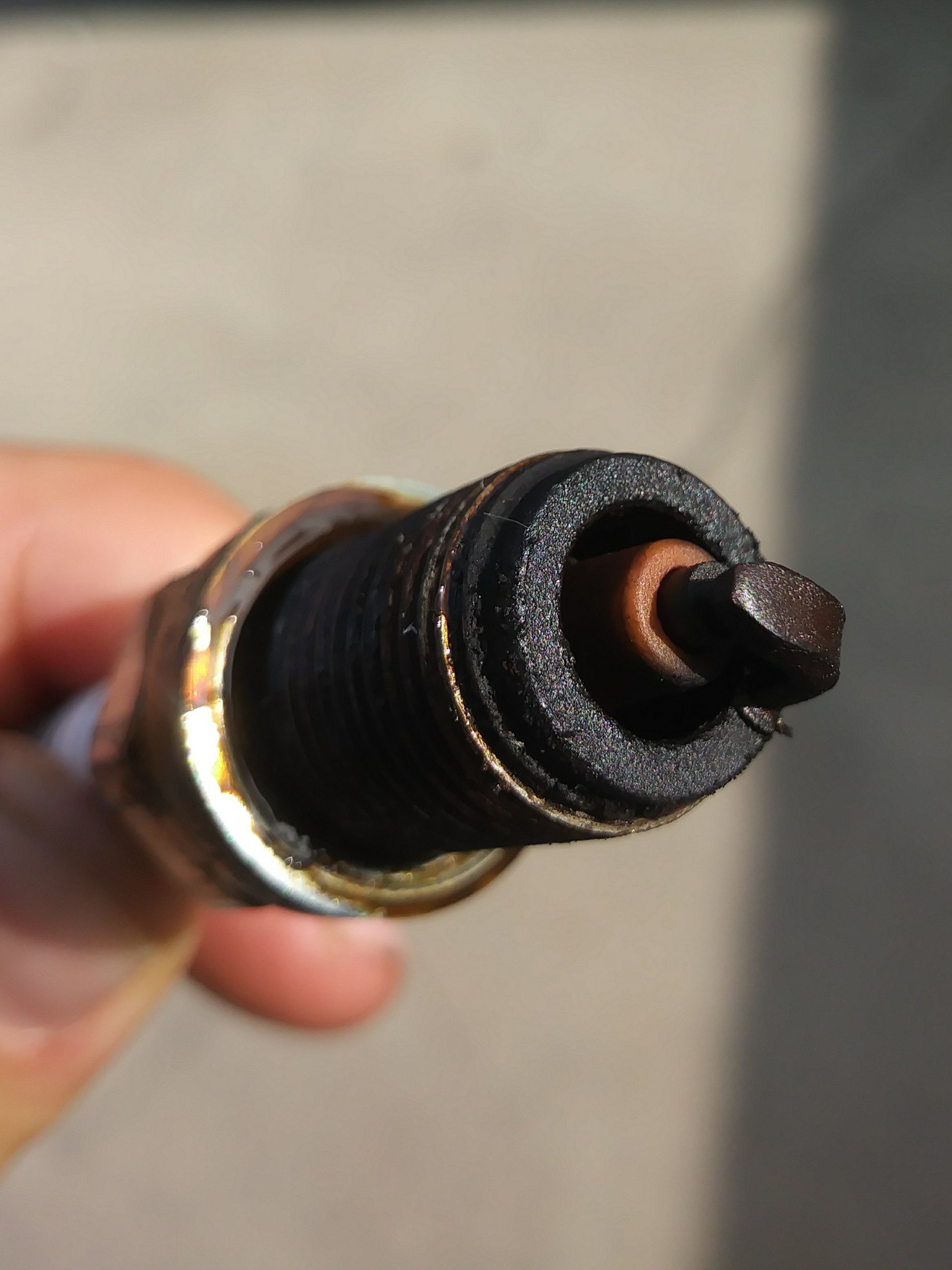

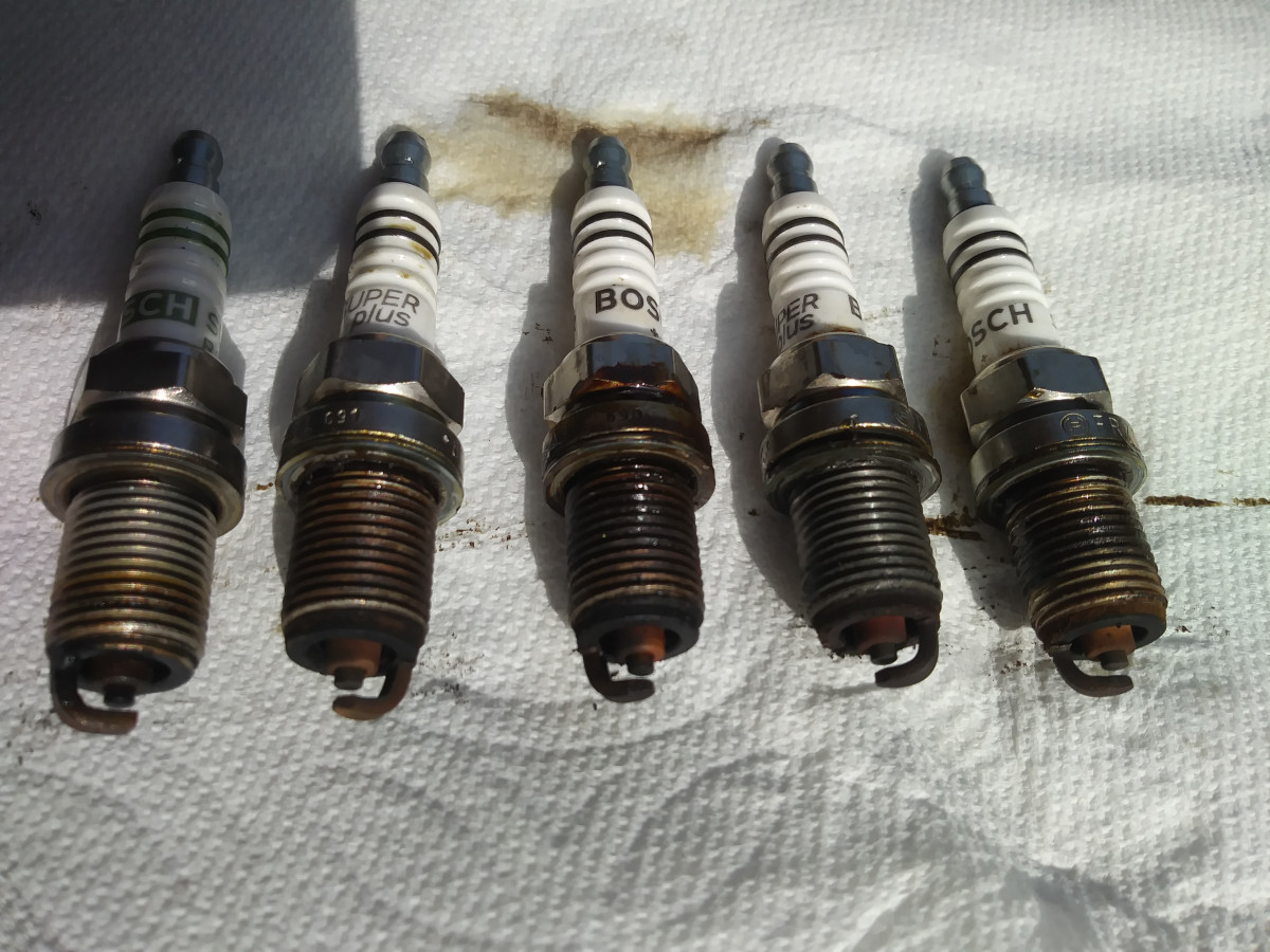

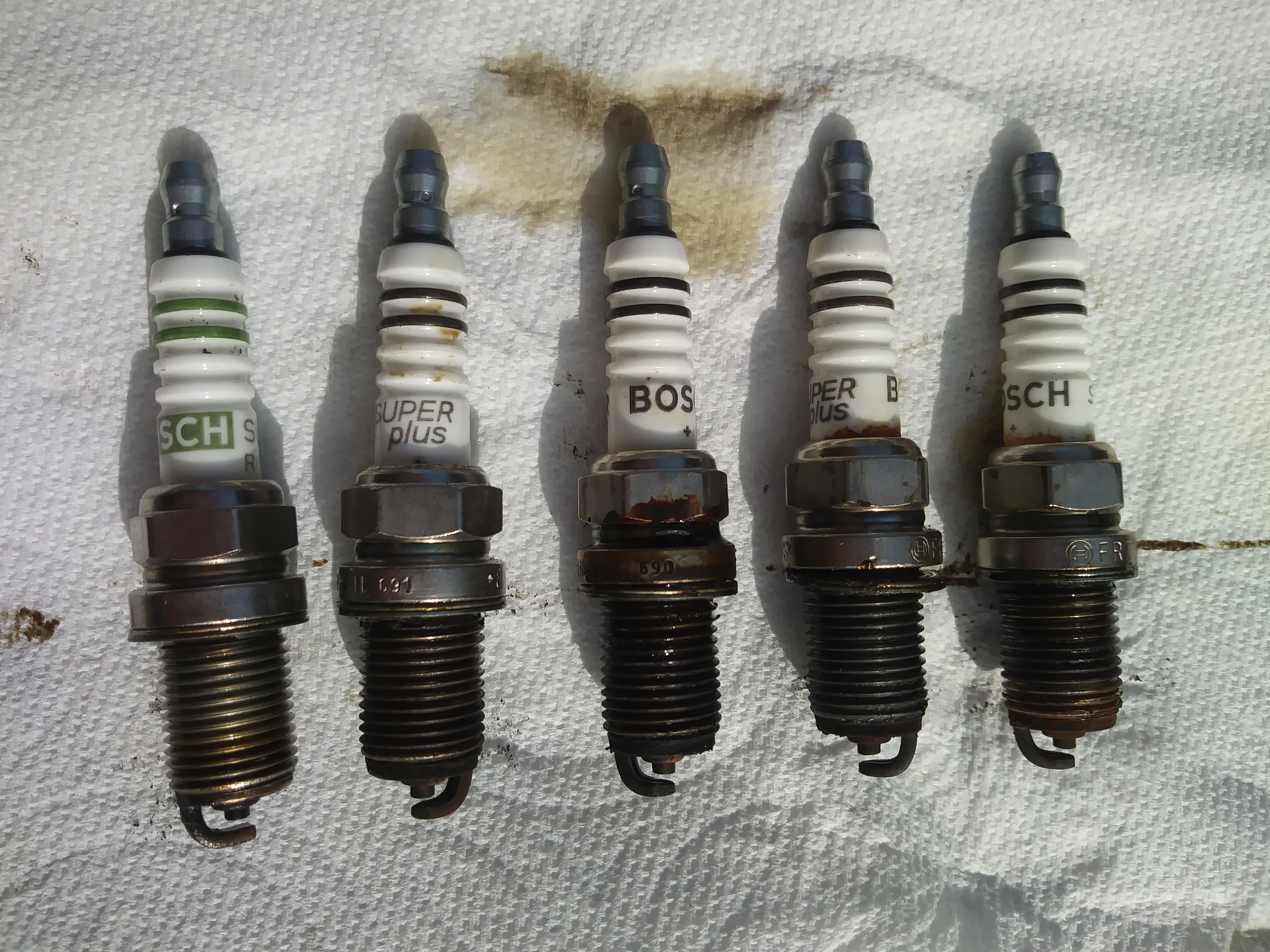

Or inspect sparkplugs for steam cleaning.
A turbo shaft breaking can put both coolant and oil in the cat converter.
I broke the shaft in my turbo. Smoked up a storm, first white steam, then blue oil smoke .
possibly the snap you heard was the turbo shaft.
Have someone crank the engine cold while you put your hand in top of the turbo. It (rattle) will be obvious soon enough.
Also ran the compression test, cold engine with a battery that's been sitting for a week. In order, cylinders 1-5, results were 130 psi on the first three and 120 psi on 4 and 5. I think I'm convinced enough that it's less likely to be a head gasket and more likely a turbo problem, which is probably out of my mechanical abilities. Unless there's anything else that might be a simple enough diagnosis, I think it's off to the shop. Thanks to the replies above.

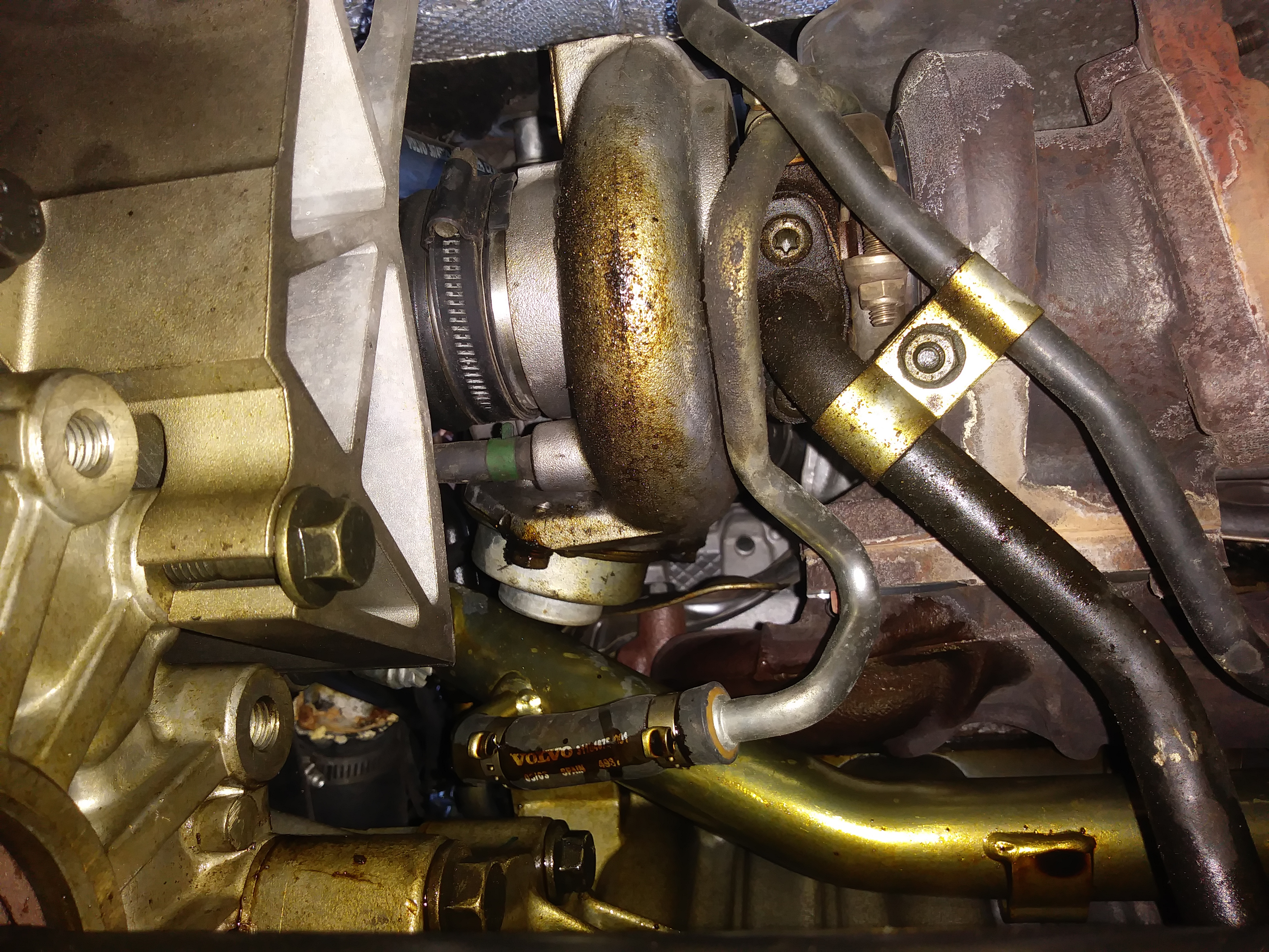

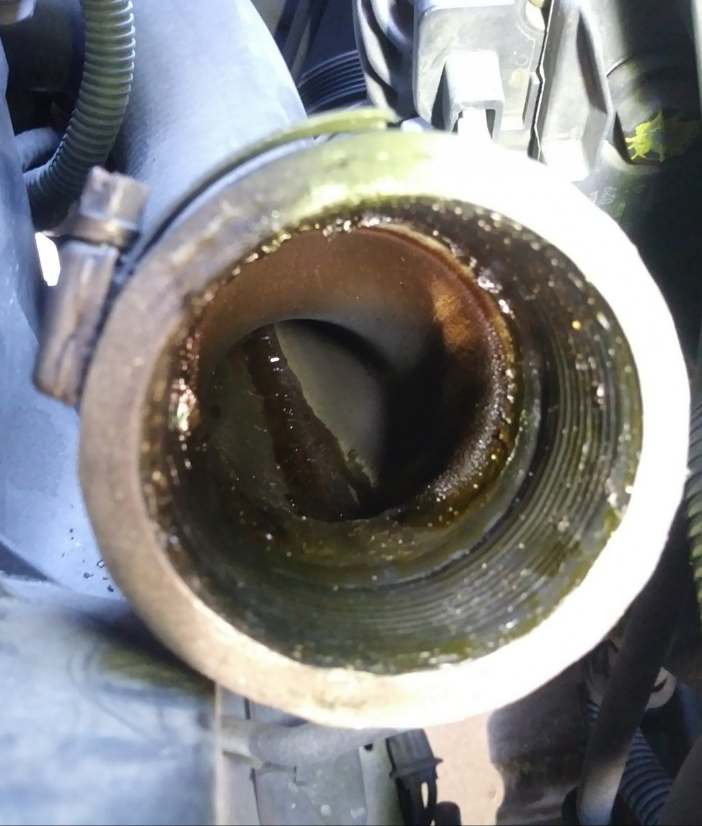

And now this weekend's update. Ran it for a couple minutes with much less noticeable smoke (disappears maybe 4" past the exhaust pipe), but it's a lot warmer and dryer today than it was a couple weeks ago. Pulled the charged air pipe (again) and took a closer look if there's anything noticeable. No real sign of coolant, but a trickle of oil on the front side; not sure if this is somewhat normal but snapped a picture. Jacked it up and got underneath to get a better look at the turbo. A golden oil glaze over a lot of the area and several drips forming on low spots, but I couldn't really discern a source. The turbo drain pipe looks to be good though. Wiped it all down, and I'll take another look another day to see if I can get a better idea of the source with everything cleaned. Thanks again to everyone contributing!

this car is FWD , not AWD ?
that would make things easier if the turbo needs attention but I'm not convinced,
that oil residue can originate from the filler cap gasket. Check the cylinder head for pooling oil.
Oil can also originate from the flex coupler , between the charge air pipe and turbo. Make sure it clamps tight.
Look for chalky residue on the coolant bottle, its a common failure and will cause coolant loss that is difficult to track down.
WHite cloud on startup can be condensation , depending on weather.
Sorry for the long gap, but thanks everyone for the replies. I did finally take it over to a shop that confirmed blown head gasket due to exhaust in the cooling system. Check engine light has mysteriously gone off in the meantime. Probably time to sell this one though.
