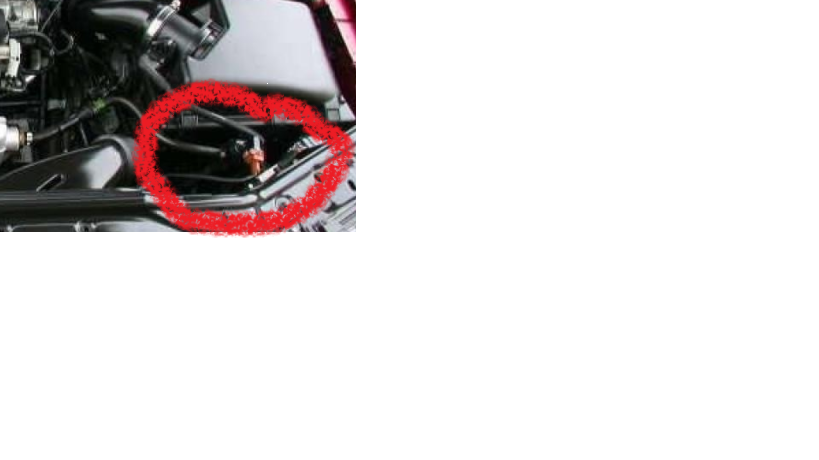

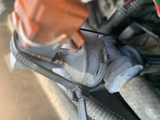

I need to replace this part which is cracked. It is a plastic connector that joins 3 hoses and has electrical connector on top. There is a spring inside. The cover is cracked causing the spring to not stay compressed. I think it is fuel related. Could anyone tell me what this part is so I can order a replacement?

Vacuum pump switch

And here is a link for $80
https://www.fcpeuro.com/products/volvo- ... o-31265825
You might find you don’t have power brakes at idle or startup if this switch goes out. You will have power brakes at speed , though.
Alternate part numbers
31400692, 30645493, 31265825
