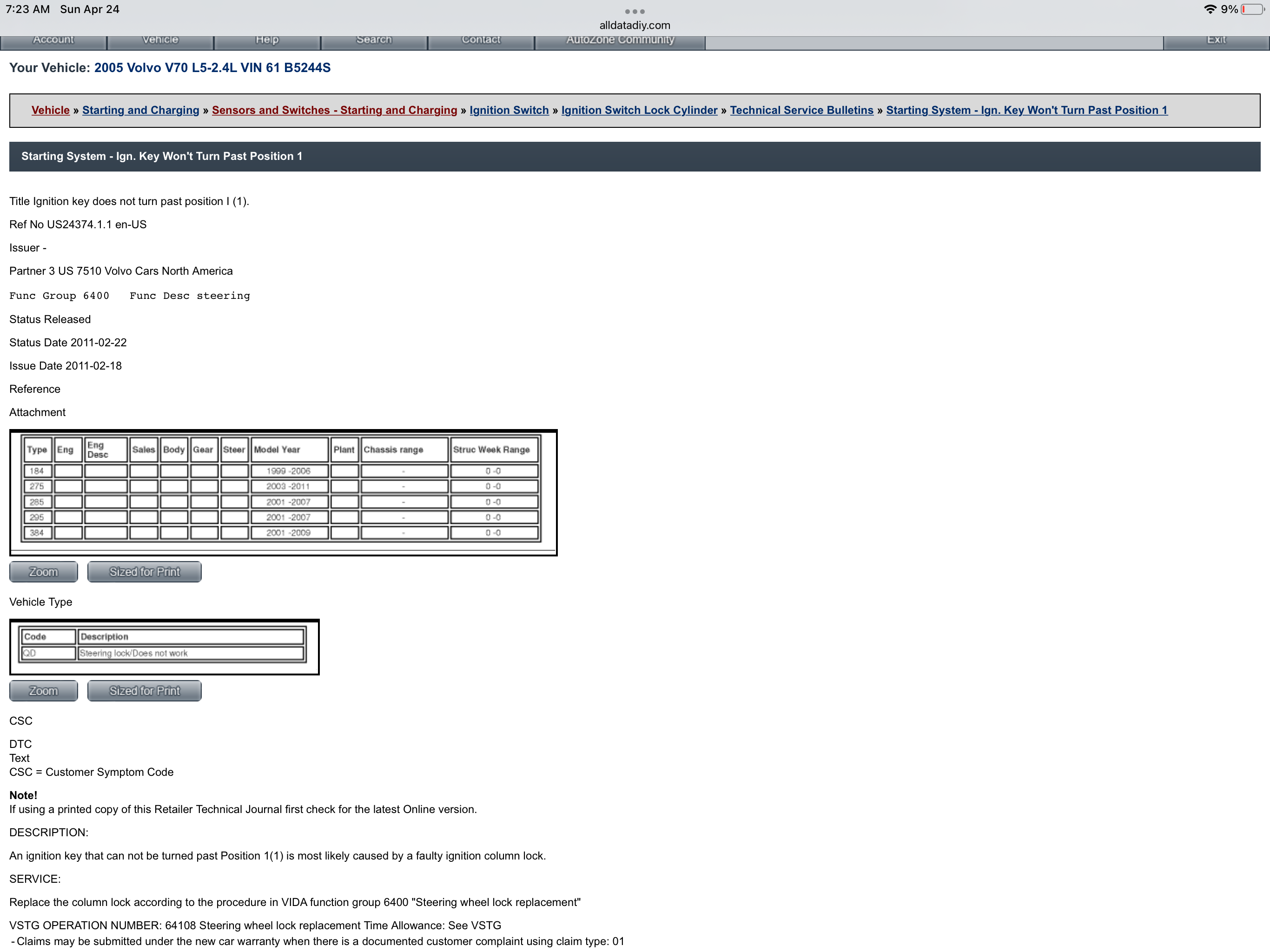

Hmmm
The 1999-2009 all use the same black white electrical switch
8650054
The way this thing broke, I think it’s more likely the problem is in the electrical part than the tumblers. I’ll try pulling the electrical part to confirm. Volvo points,etc the lock cylinder, though.
8650054

And the verdict is the electrical part of the switch is not the resistance, so new lock cylinder is needed
