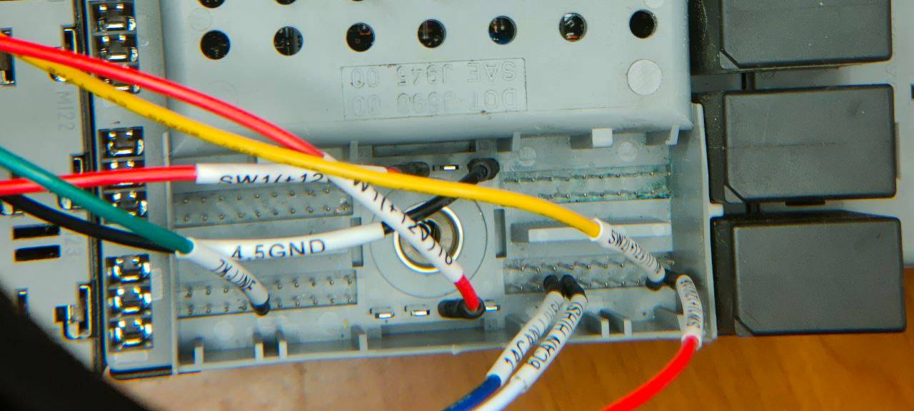

Thank you for help.
K line with dice.
Did I connect something wrong? Will someone suggest?
This is correct:
CEM pinout.jpg (233.09 KiB) Viewed 690 times
