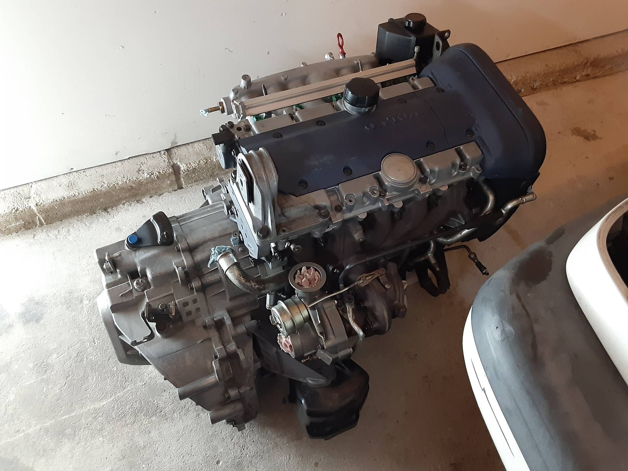

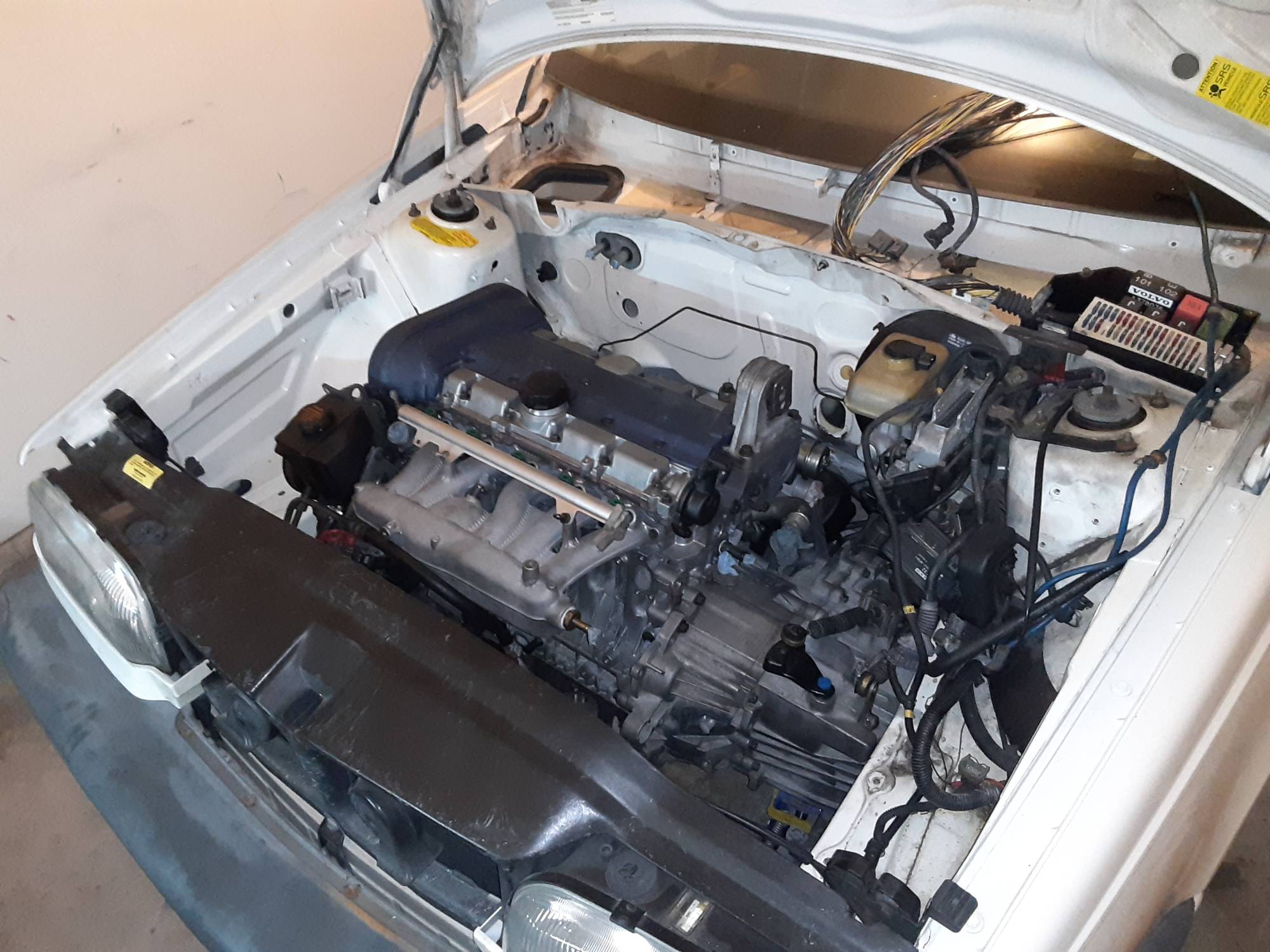

Right now, I'm building what I call an 860R - a 1995 854 with a B5254T4 R out of a 2004 S60R, driving an M56 transaxle from a 2000 V70. The build thread's over on the 850 and 70 Series forum if you're interested. I'm using the factory ECU and wiring harness from the same donor car the engine came out of, but the transaxle, flywheel and clutch are all miscellaneous 850/70 Series equipment sourced from eBay.
