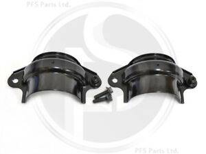

next job i found the other day when under the car is the big clamp that holds the fuel filler neck to the fuel tank has severe rust and is split right down the middle both sides,ive no idea whats holding it on and typical i just filled it to the top so now think i have to drain it to fit the clamp but am wondering does it have a seal of any kind ?this is what im talking about,
s-l300 tank clamp volvo.jpg (6.57 KiB) Viewed 560 times
i just dont want to take it apart and find i need another part so if anyone knows please enlighten me,cheers

it stopped raining for an hour!just finished fitting the new clamp to the volvo tank/filler neck and just in time as there was about 2mm total of the metal left and i could remove it with my fingers!so changed it using stainless steel fittings instead of the supplied mild steel,(why would you) genuine volvo parts as well.next!
